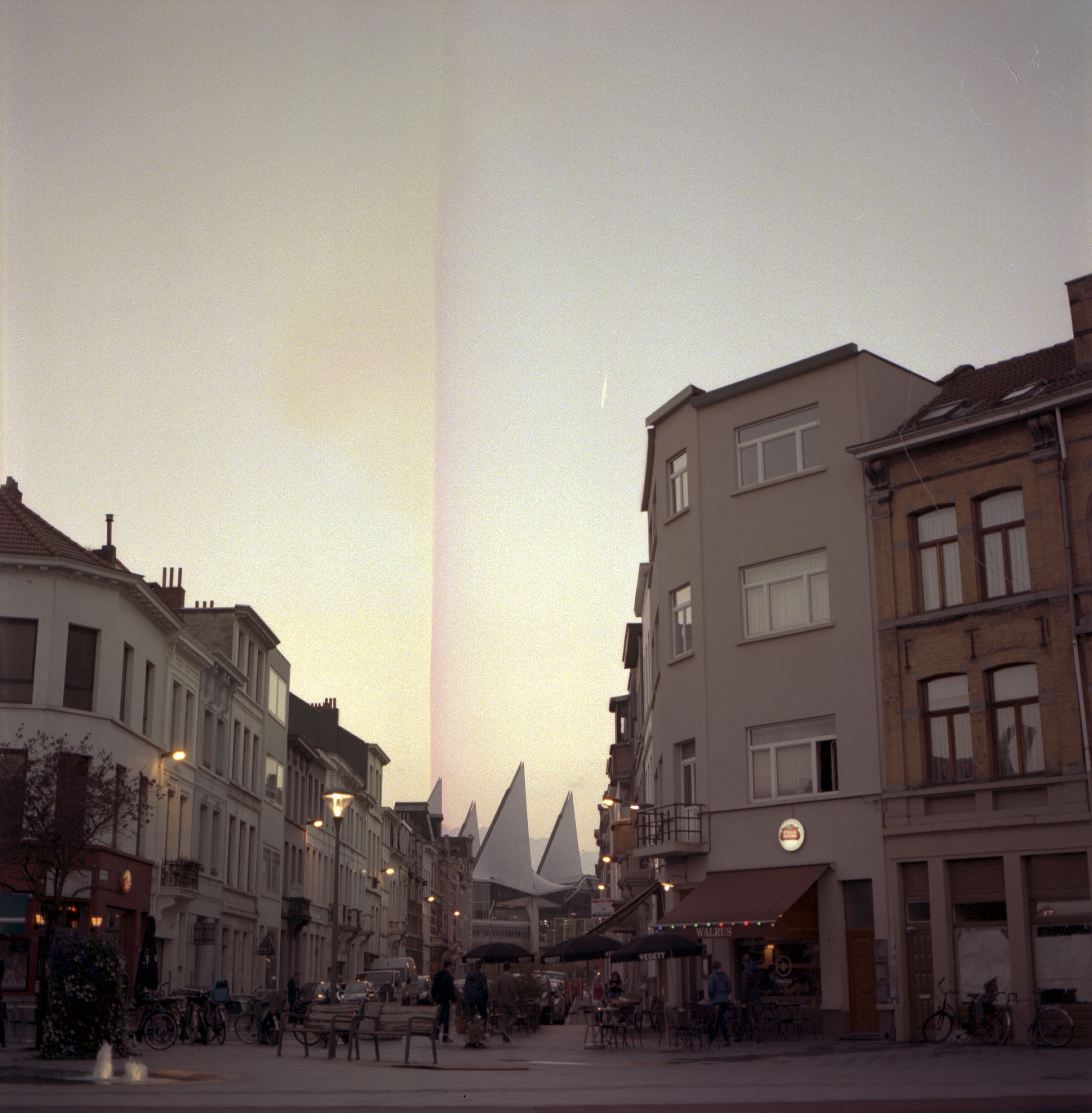

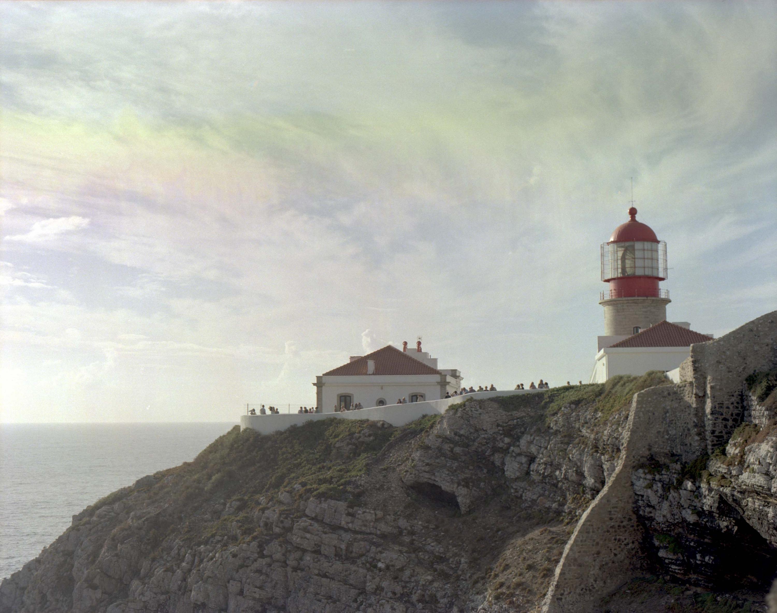

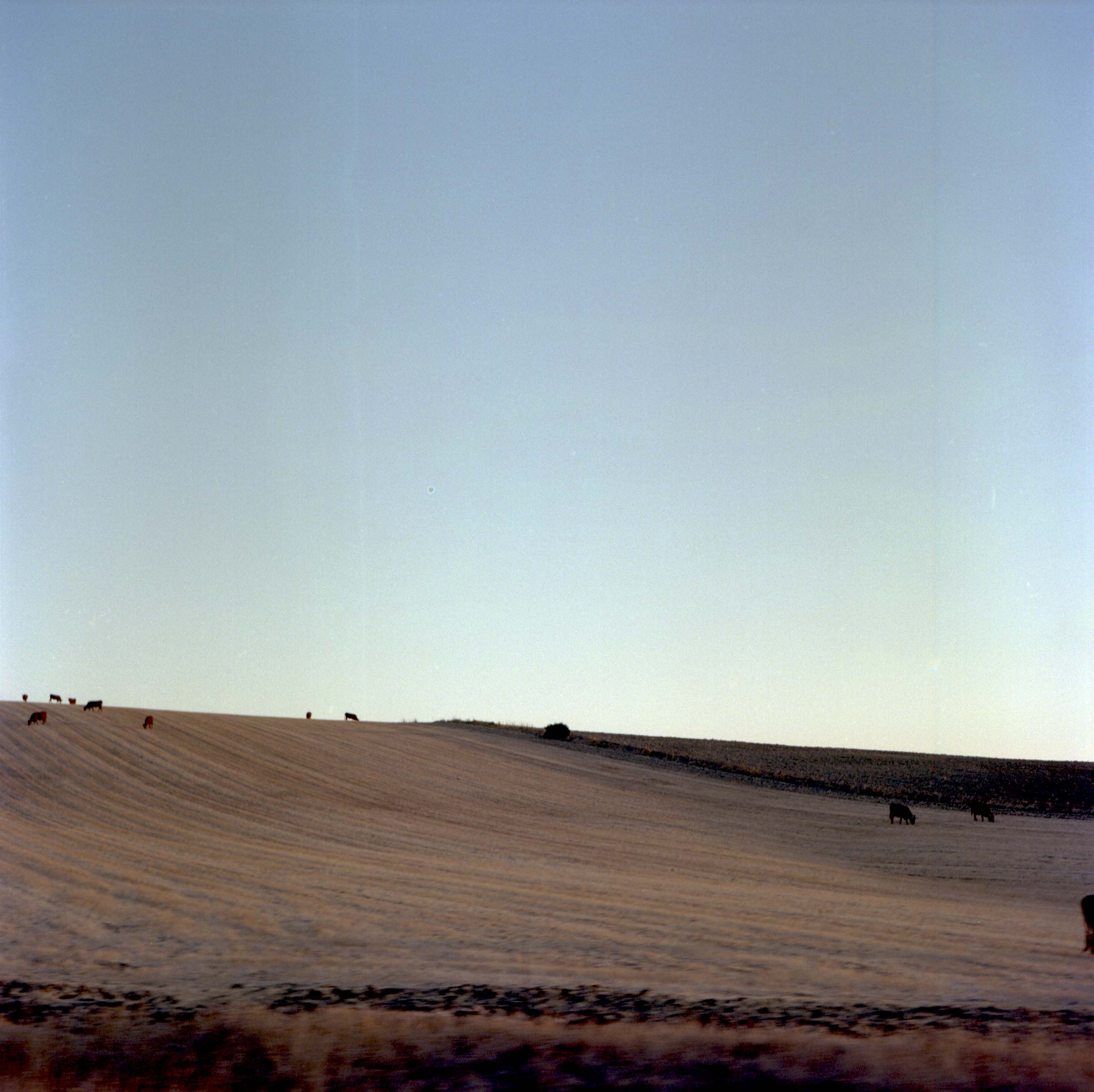

As you can see I am new to APUG, been reading a lot of post but never joined and today I come to you with one question. I´m developing with the Rollei kit and I have been getting the streaks that you can see in the pics. In the thread about the rollei kit (read the whole thread today) One of the users ask about the same issue I have and he did not get a clear answer. He also created a thread here : (there was a url link here which no longer exists)
I´m suffering the same problems
I have been following the instruction from the kit and sometimes I have also been adding the wash between bleach and fixer and fixer and stab but the same results.
All done in CPE2 at speed 2:
Prewash 2 min
Developer 38,7º for 3:15 min
Bleach 4:30
Fixer 6:30
Stab 1 min but I have been doing it in the tank rotatin in the machine at room temperature.
Best regards
Miguel

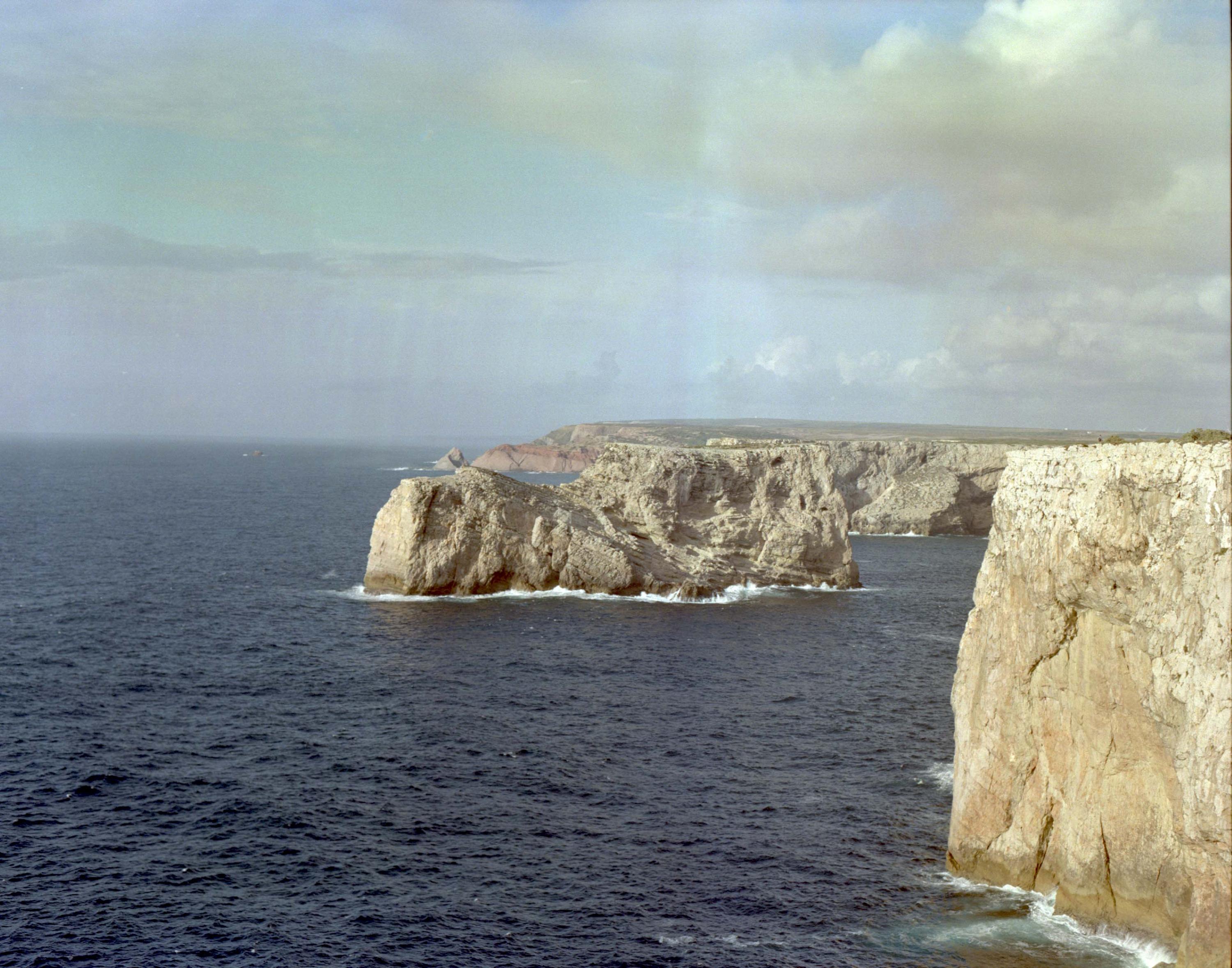

What is the line in #4, and do you use washes?
If the line is a real process defect, it indicates insufficient solutions and agitation.
If it is not, then you need a stop bath after the developer. Use 2% acetic acid.

Sometimes I have been doing them but only between bleach and fixer and fixer and stab.
Yep the line in the 4th pic is on the neg too.
Do you think my jobo goes too slow?

That line indicates that the solution only came to that level in the tank and it sat at that level too long. Then, agitation was insufficient. But it also hints that you need a stop due to that agitation problem.

And what about the streaks in the other pics? are they because of no pre wetting? or should i try the 30º 8 minutes development?
Forgot to mention that I don´t get those streaks in 135mm film developed in the same tank as the 120mm where I have this problem. I use the Jobo 1510+1530 that fits two 120mm and one 135mm. The 135 comes always good

Well, three thoughts.
1. You said you did use a prewet above.
2. They are not streaks except in picture #4 which is a precursor and worst of the other smudges.
3. I'll bet the 35 mm was above or below #4 in the tank. It therefore avoided any static solution as you poured in and out.

I think I did not expressed myself properly, sorry but english is not my mother tongue. The pics one and 3 are from the same roll and were developed in a different batch as the others two, which also belongs to separate rolls developed in different batches. I am more concern with the yellow smudges present in 1,2 and 3, maybe using the word streak was the wrong one. I did always prewashed, normally 1 min, until a few weeks ago I read that there are people recommending not to do it. So I run a few batches ending with the same results.
The 35mm are always on top and I am using a Jobo CPE2. How can I avoid the static solution when pouring in and out?
You think an extra 1min stop bath + rinse before bleaching will help?
Thanks a lot

Photo Engineer I have one question, checking rolls with the same problem i realized that the streaks are only present in the pictures where the sky is a great part of the picture, in others where no sky is visible, there are no streaks. Do you have any idea why?

#2 is classic example to me at least of what I call Road Ruts.. which manifest as minus density on film which in turn prints dark
I was getting this one summer and basically had to stop process until I figured it out.
For me the solution was distilled water... and initial agitation off the machine first as if you were manually processing in a small steel tank.
Both changes got rid of the problem.. you are seeing the damage mostly in nuetral smooth areas of the scene, in more complex areas of detail
you will see less due to basic camoflague.
