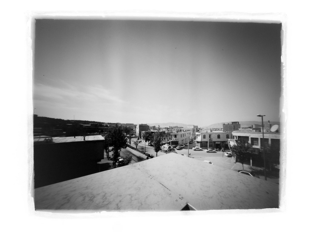

Film Guerilla
hey guys!
this was developed using the same method as mentioned a while ago but this batch was only 4 sheets. i don't know why..
Film Guerilla
i know that shot is from a pinhole camera. but a lot of my sheets from the 2 batches got some streaks. it might be the improper loading but again this batch was developed with only 4 sheets in the processor. invertion method is stick 3 rotation every 30 seconds.. i tap the tank after every agitation.
i will try to post another pic from speed graphic later.

Film Guerilla
hi guys! these are the images i'm talking about.. i think the problem would be my method of processing..
i should've added presoaking. i've done my homework about bromide drag and other method of processing because of this.
now i will add presoaking to my method and add a little agitation as well.. i'll update you guys if i ever got this again.

Morgan ~ MOD54
I've spent alot of time testing this and in most cases if you get streaking it occurs in the inner most sheets. It only occurs with lots of light grey, like sky scenes, otherwise its not noticeable.
If your shooting landscapes with very even skys its best to just process without the inner sheets in.
Hope that helps.
