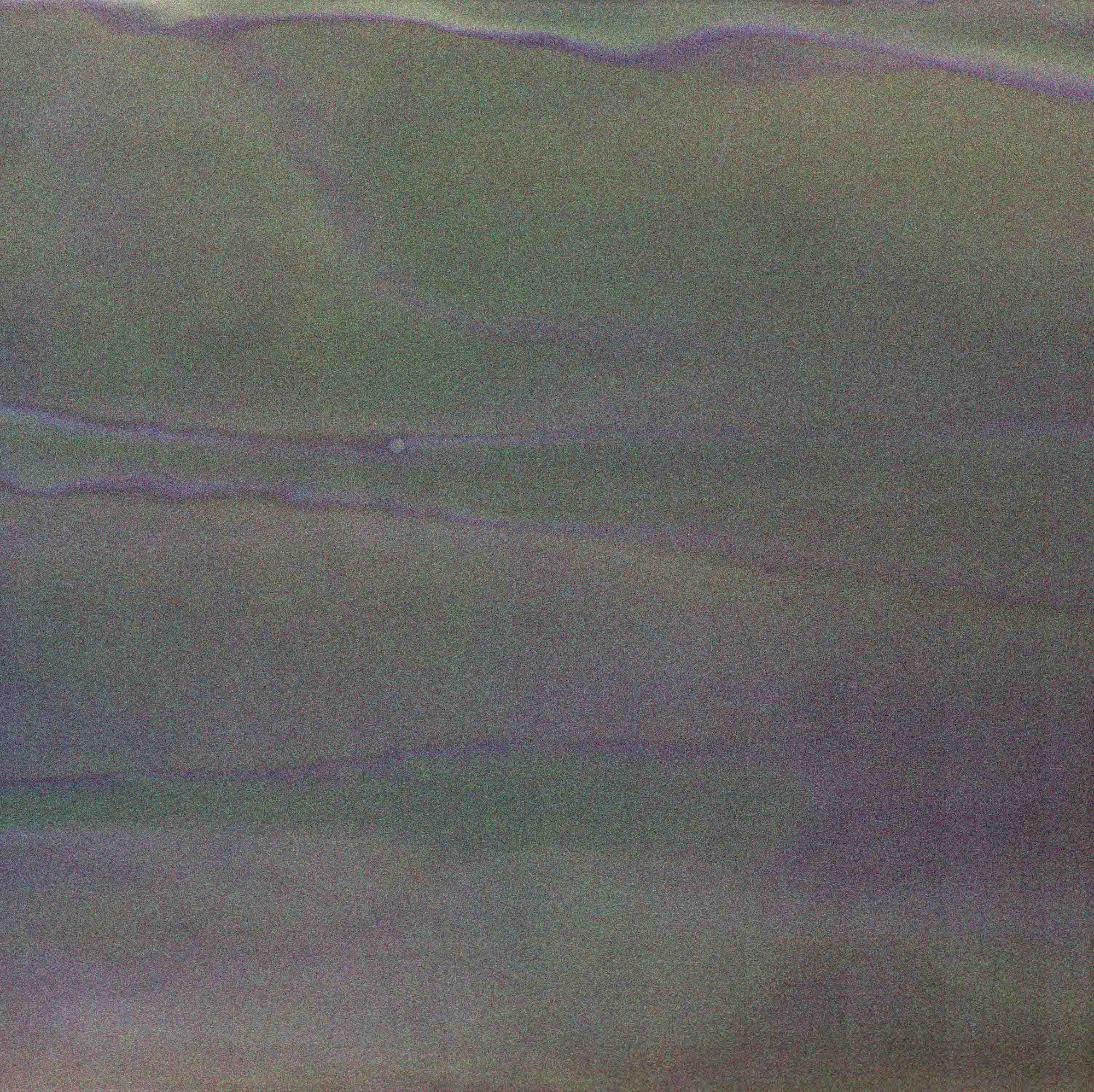

I'm having this issue of very faint streaking on my negatives developed in a CPP2 with lift, using 1500 series drums and reels. The streaking is almost non-existent except on very underexposed frames, but it's visible on the negatives on the light table.
I use Kodak Flexicolor dev and bleach and Fuji C41 Fix. My process is 3 minute Pre-wash, Dev, RA Bleach, 3 min wash, Fuji Fix, 5 minute wash, Final rinse off the reels in a separate container. Washes are 30 second intervals. Dev and Bleach are replenished to sepc / manually aerated. Fix is one-shot. I'm running anywhere from one roll to six rolls at a time in different sized tanks. I've tried no prewash and it didn't seem to make a difference. I was also getting foaming developer and surging on the negatives when I didn't prewash. I do add a couple drops of LFN low-foam wetting agent to the developer as suggested elsewhere.
I'm posting a scan of an unexposed frame as an example of what I'm talking about. Don't mind the banding. That's a scanning artifact.

Looks like carryover of developer into bleach. It is not a prewet problem.
Try a 30" stop after the developer. Use 2 - 5% Acetic Acid.

Well, the stop bath cured the problem. Thanks, all.
