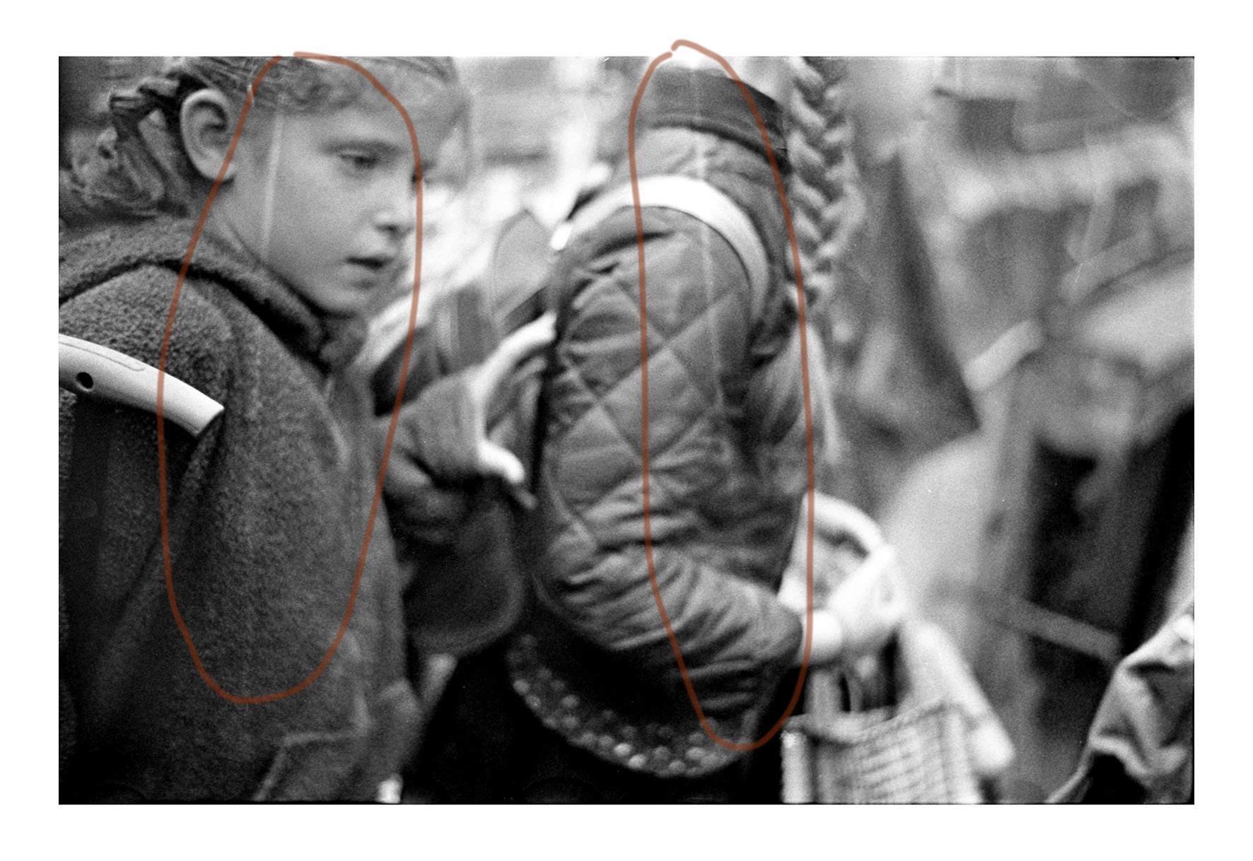

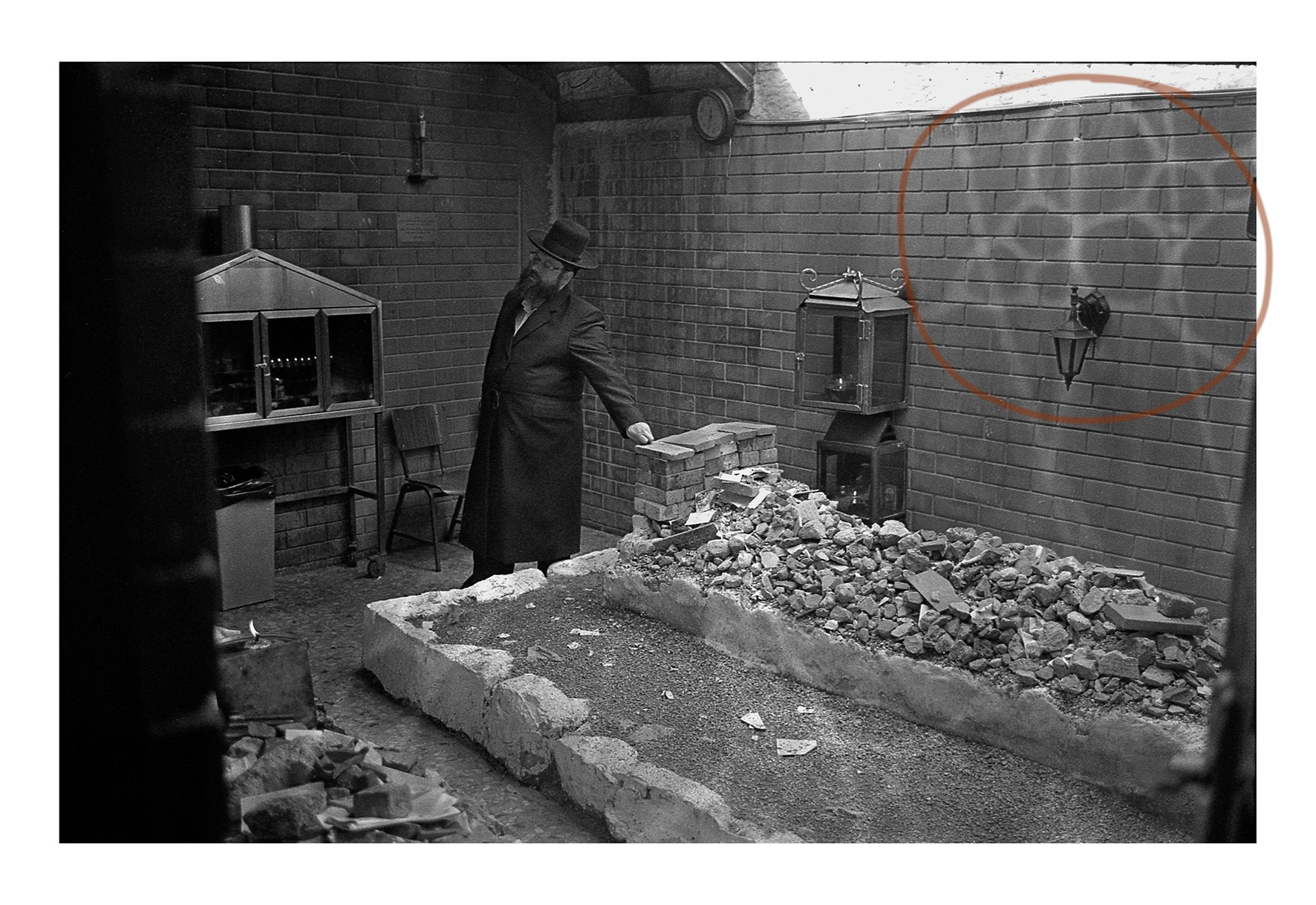

On the last roll I developed i found really strange spots on my negative, does anybody here know what is the reason for this? it seems like 2 different problems.

Image #1 shows large bubbles/foam. This is usually associated with traces of photoflo on the reel and insufficient developer volume, although this example is rather extreme.
Can you give the details of your development process, please?
Thank you!! the film is ilford HP5 the developer R09 I developed two films in the tank but had the problem only on one of them. any idae what happend to the second frame?

Is it possible the problem only appeared on the film that was on top of the other one in the tank?
What tank did you use and how much developer?
The defect on #2 might be related, but it's hard to make out how big it is and what it looks like in real life.
Can you post photos of the actual negatives (backlit) that exhibit the problems?

Air bubbles on B&W film should present as dark circles because they hinder development, they may have a slightly lighter edge, so unless reversal processed it's more likely something else. In addition, those lines are too long to be air bubbles.
It could be contamination, reels/spirals do build up a bit of gelatin over time from the wet emulsion surface and that combines with traces of wash aid,, and may retain some fixer.
U think the reels need a very good clean.
