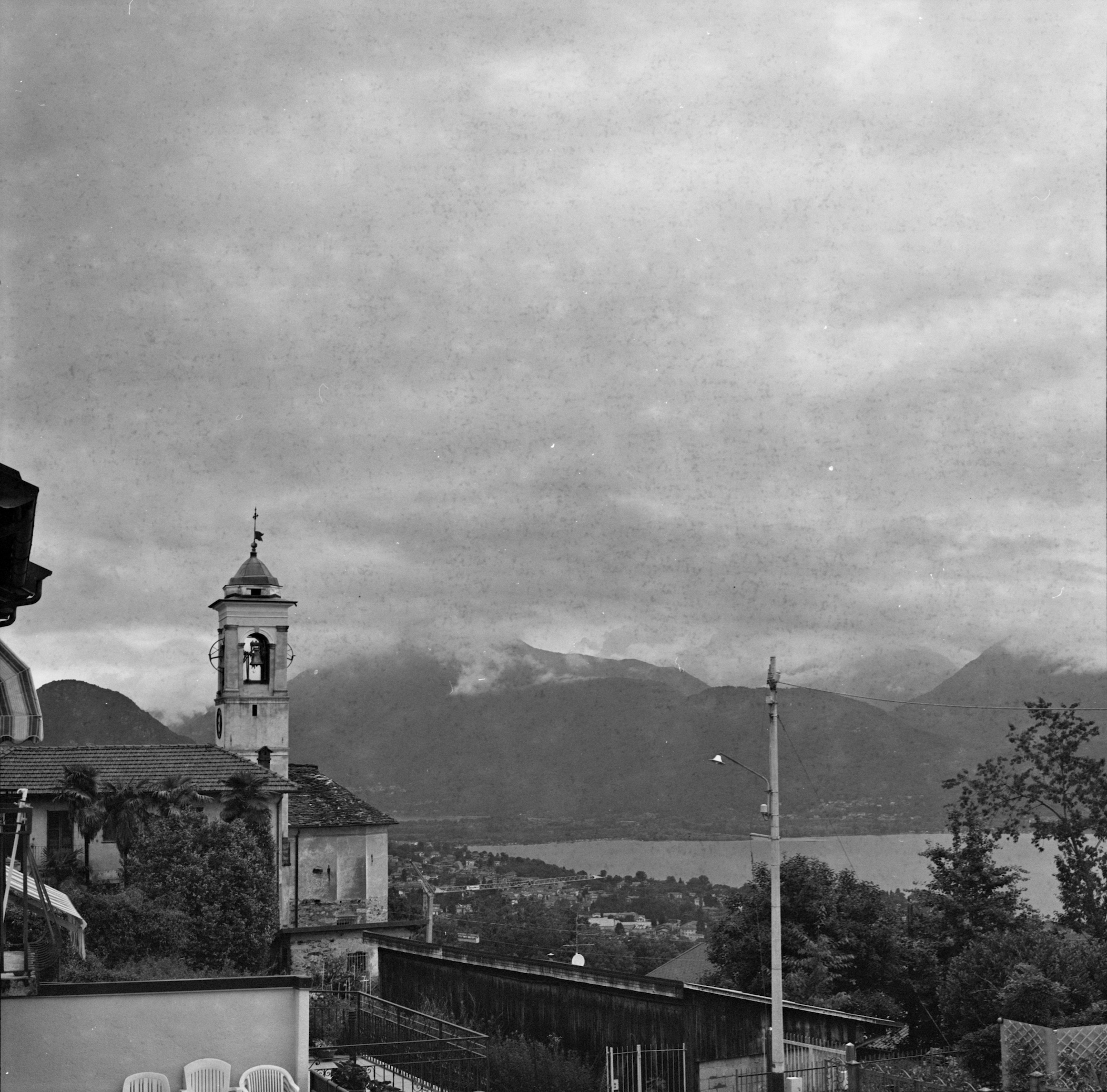

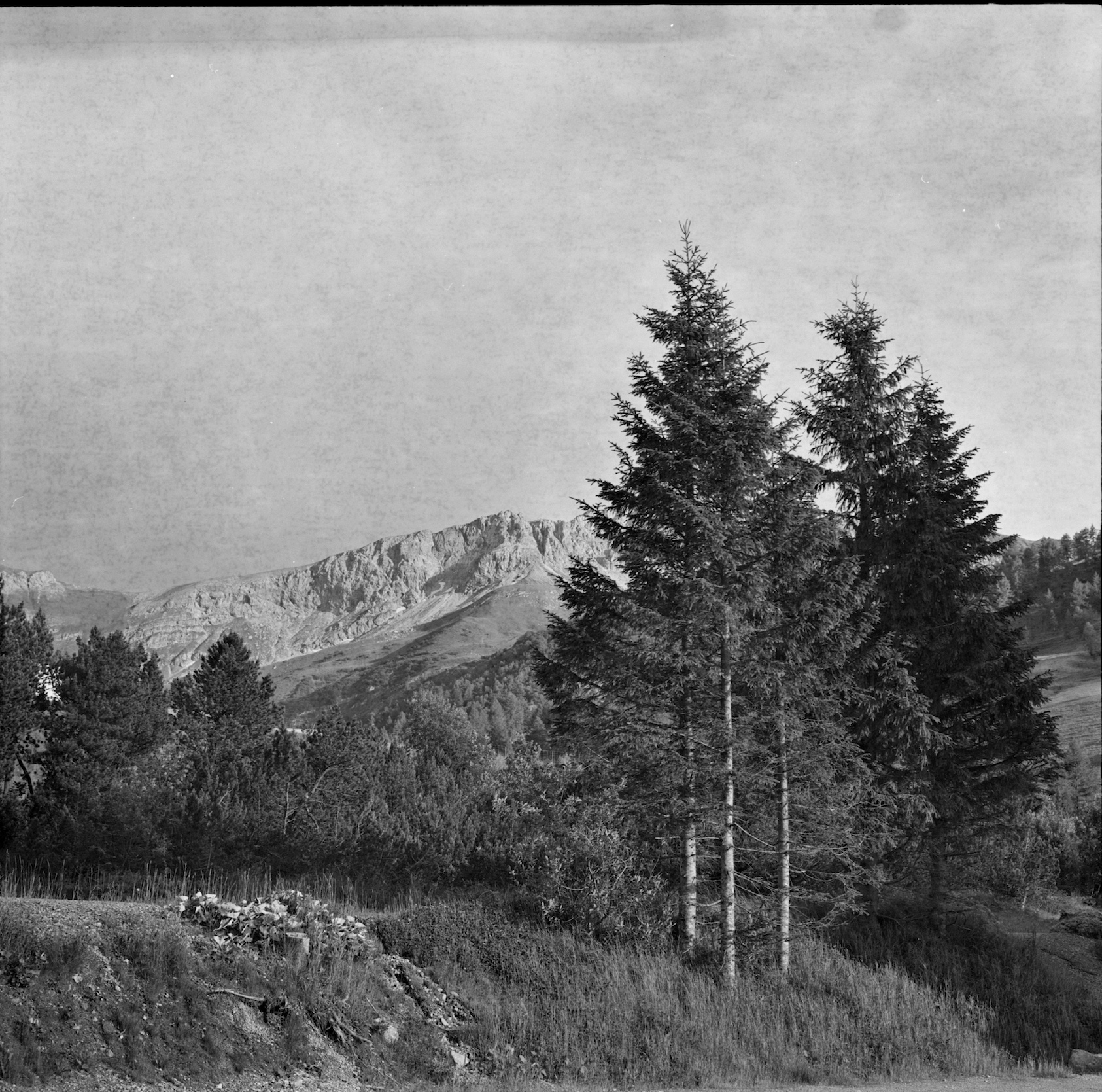

I have noticed a large number of small random spots on b&w Fujifilm Neopan 400CN 120 film which was developed using C41 process. A few months ago I have developed my first 400CN film and noticed this problem. Initially I thought that the washing was terrible and blamed it on that. However, a few days ago I have developed 4 films in the same tank (two 400CN b&w and two colour films) and the spots appeared on ly on the 400CN films and not on the colour films. I am controlling temperature at 38 degrees with my Anova sous vide gadget and the temperature is verified with a manual old school mercury thermometer. I am using constant manual rotation during development and fixing.

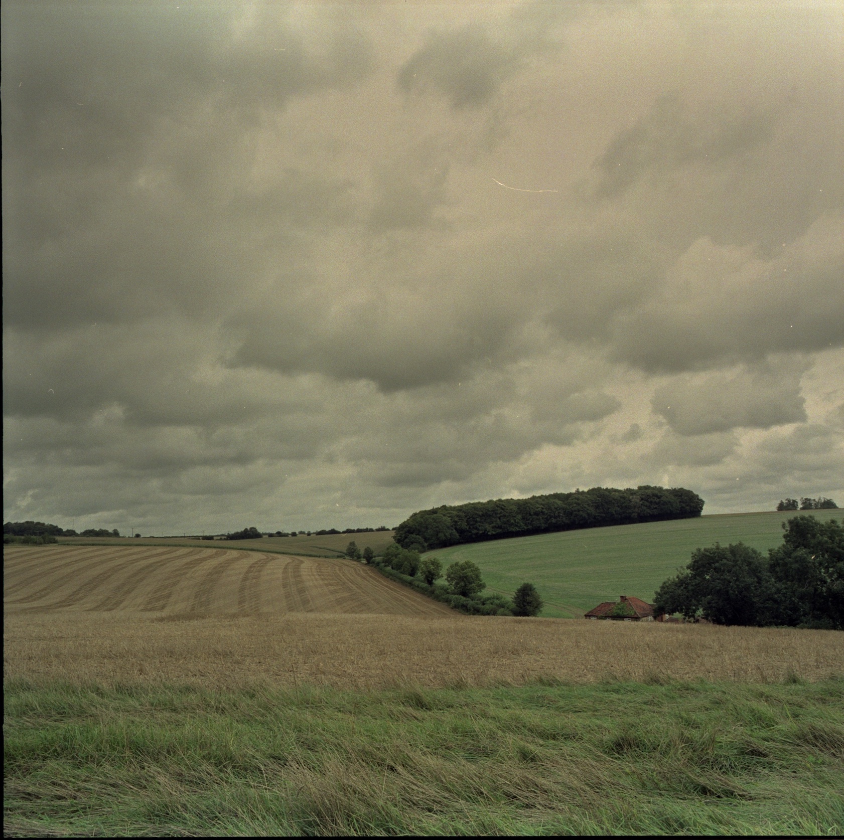

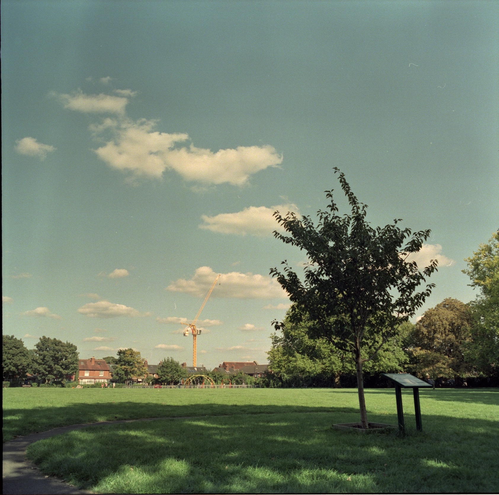

I have scanned a few negatives to show the spots. The small spots are there all over the b&w negatives and more visible on the light parts of the negative. The colour scans show the Fujifilm Pro 400N without such spots even though the films were developed at the same time in the same tank.
Has anyone experienced these issues? What could cause it?

Are the spots to which you refer the mottling effect that only seem apparent in the sky area? I can see two almost pure white spots not in the sky area but only in the last of the two B&W negatives. However I don't think these are what you are referring to, are they?
Is there any chance that the mottling is a scanning artefact?

the spots that I am referring to are little grey specs of random shape that appear all over the b&w negatives. They are most visible in the lighter part of the image, like the sky, but some darker parts also have them. For example, in the image film-120mm-2017-08-2-002.jpg you can spot them all over the mountains. These are visible on the negative under a loupe and they are not scanning artefacts. I've not experienced anything like that with any other b&w or colour film, apart from the 120 NeoPan 400CN. I have developed a roll of 35mm Ilford XP2 before and not had any spots. From what I've read the NeoPan 400CN is a very similar film to XP2 and is also produced by Ilford for Fujifilm but with modifications. I have a few more 120 rolls of NeoPan 400CN and I was hoping I can develop them without having the spots.
Does it worth giving another wash to see if the spots go away?
Cheers
