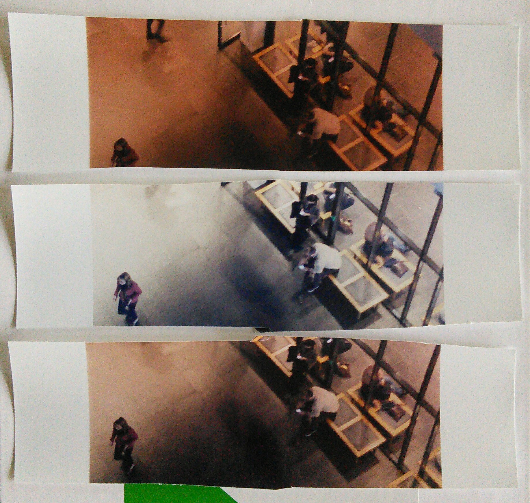

Hi, these are my last 3 test strips in order. As you can see something is going wrong. They were all made identically with the best precision I could give. The voltage incoming was very stable give or take 1 volt.
I'm thinking the problem lies in the enlarger itself. I thought the chemicals at first but if it was the chemicals I feel the changes would be consistent or at least predictable.
I'm thinking it's either the transformer, the bulb (it is a new bulb however), the wiring, the bulb connector. Any idea how to test these or any ideas what's happening? My enlarger is a Durst M370 connected to a TRA 305 transformer and a TIM 60 timer.

Hi Pentaxuser, you've definitely seen these before as I'm having problem upon problem in my darkroom unfortunately. Everything was the same including exposure time and filtration. In theory they should all be identical. The top was the first one I made and the bottom the last one I made. The middle is the closest to what I'm after but the density is a little under.

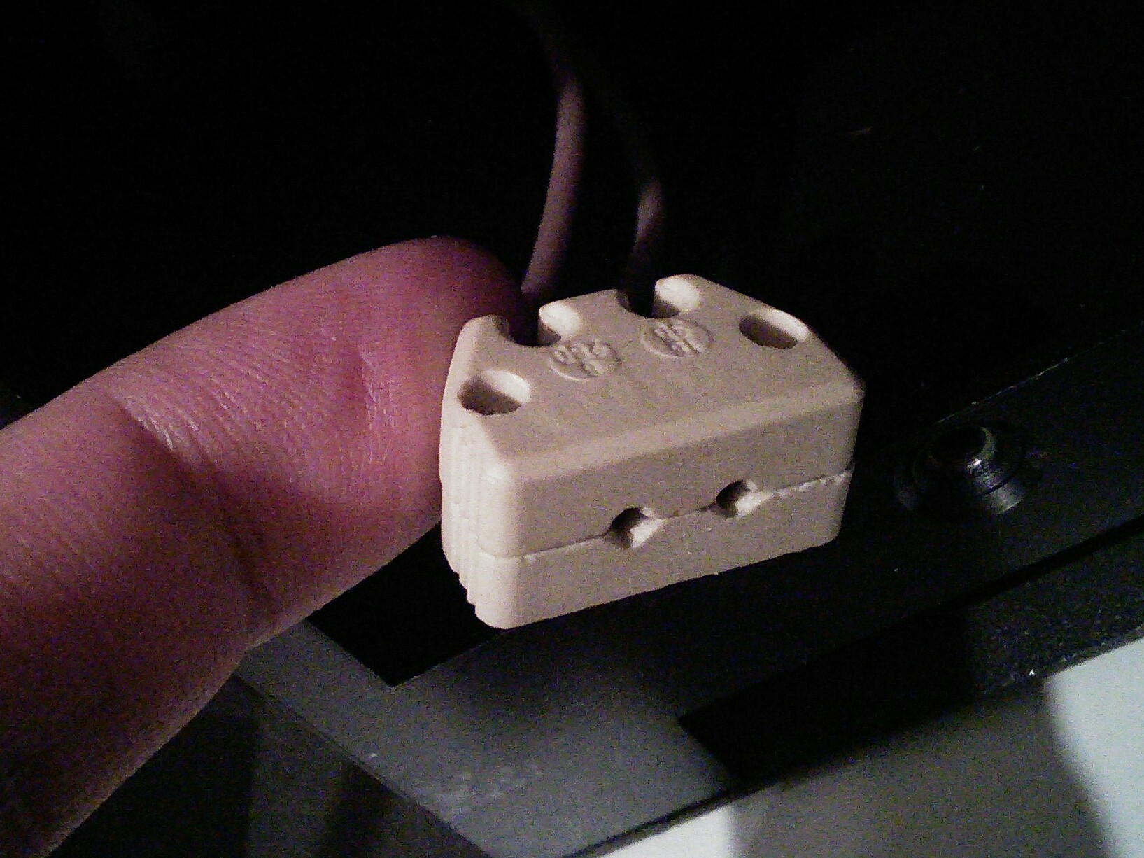

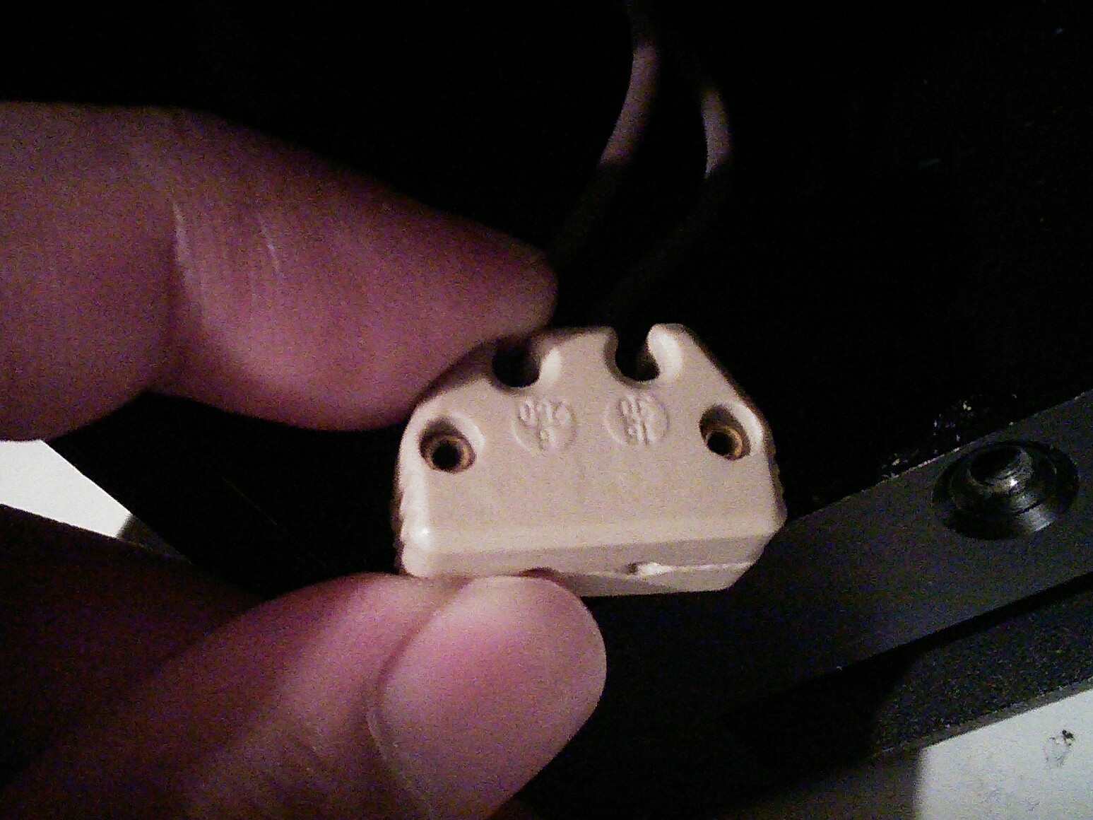

My last bulb had corrosion on the terminals. Could corrosion on the bulb holder cause these kind of problems. Anyone know how to open up one of these holders?

I have just seen your #5 now You can't open up these ceramic holders and it can be very difficult to detect if there is corrosion inside the holes. Ideally it is best to change the holder each time you change the bulb. The ideal instrument to clean the holes is a large sewing needle or a jeweller's round file but this is a second best solution.
However as I said in #6 if the ceramic holders are corroded then you should see this as a fluctuating illumination during exposure.

Sorry, I'll do my best to address these points.
All three exposures were made with the same filtration, f stop and time. I was trying to test if I was getting any consistency. They should be exactly identical if everything was working correctly.
They were developed within hours of each other, in drums and from a fresh batch of chemicals that has been well replenished. The chemicals are stored in a 500ml bottle with all air excluded between processes.
I made the top one first, I was confused by it as it shouldn't have been red. I then made the middle one after making no changes and it went back to somewhat normal. Just to double check I thought I'd make a third and see what I would get and then it went back to red.

I left it over the weekend and a few days in order to save my sanity. Couldn't even look at my enlarger. Today I thought I'd tackle it so I cleaned out my bulb holder vigorously with a small screwdriver and the resulting test strip looks very nice now. Hopefully that was what was causing the issue. I think I'll replace it as it's a cheap part and the current one is the original.

Glad the clean-out has worked. The way things are going in terms of enlarger parts I'd be tempted to buy a couple of new ceramic holders if there is any chance that the holder is unique to enlargers or even worse unique to Durst enlargers
I have only one spare myself and I am beginning to wonder if I should buy a couple more. As I understand matters the problem is caused by arcing inside the holder and that arcing is a way of life so it starts again from day one of a new holder
pentaxuser
If you do buy a spare, you should store it in a sealed bag with silica gel or other moisture absorbing media and keep them outside of the darkroom environment to avoid corrosion.
