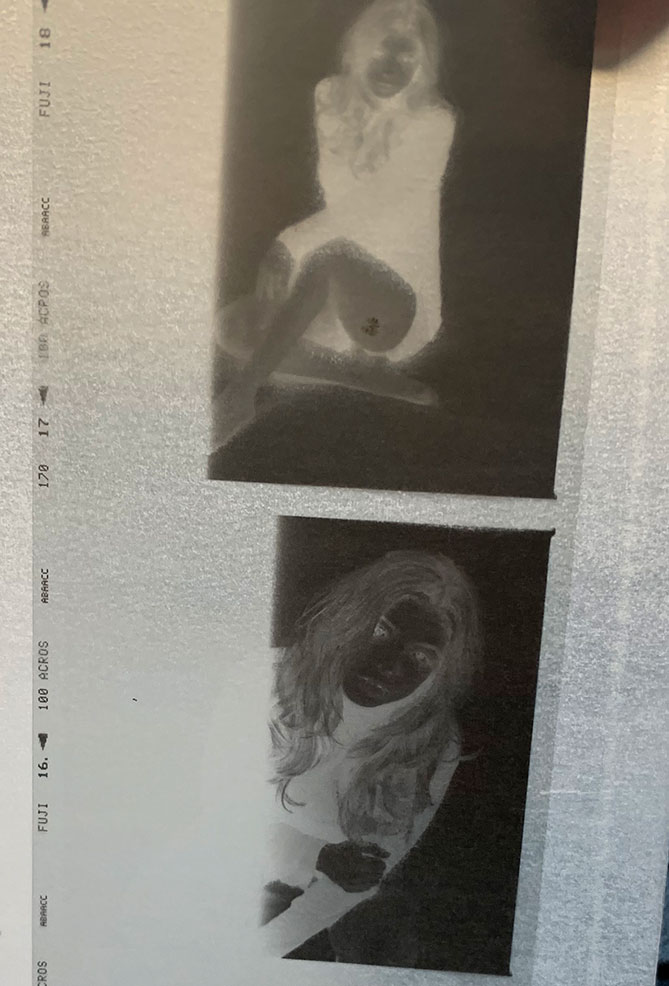

Problem 2. Shot studio the other day and a lot of my frames have one third of the frame in black......from left to right.....this yells flash synch speed problem....I set the camera at the required 1/90sec and locked it......flash was set at f8 o f11 strength on 100 asa film......

Time for a CLA. Too many problems at too many levels.

Before you do anything further, change the battery to a brand new silveroxide one.
