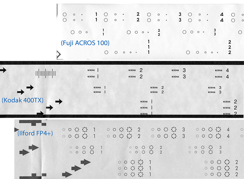

Those patterns come from the backing paper. FP4 Plus? Have you got a light leak on your camera back? Was the film loaded in subdued or bright light?

This indeed looks like wrapper offset:
As Ghostman says, did you load in bright light ?, is it a red window camera ? : Is the film in date ?

I think the pattern of the marks nails it as Ilford, since I don't know of anyone else whose paper is printed like that.

and the pattern seems to correspond exactly with the specimen of Ilford backing paper shown in Ghostman's post.

Why even have marks on the paper? Who uses these signs in any way?
Those who have red window cameras. Only modern MF's have auto-winding systems that have no need for the user to do anything once the film has been wound to the start
