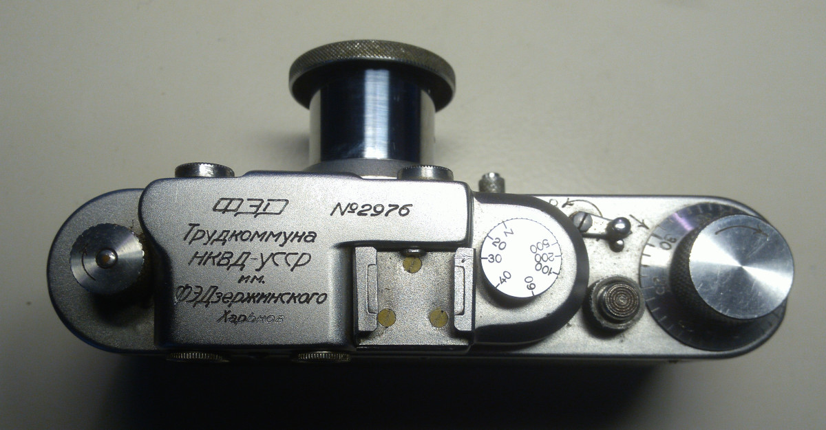

Back in 2001 I bought a Fed 1 at a photographic auction (a physical auction, not online). It was noted in the catalog that there was a mismatch between the serial number and the model. Although it is a very early model of the Fed 1 it is a 1b and not a 1a as suggested by the serial (serial 2976) as can be seen in the picture. At the time I bought it to use and the shutter still works and there are no leaks in the curtain.
The question however is why it has been given the wrong serial. As far as I can tell it has not been altered after production. One explanation that I have been able to find is that if a camera came back as a warranty case to be repaired and it was considered too hard to repair they would simply pick another camera from the production line and give it the serial of the previous one but I’m not sure whether to believe this or not. Why go to the trouble of giving it the same serial and not send a new camera? I have however no clue as to the mismatch.
Any ideas?

Exchanging cameras and giving the substitute the number of the broken one is contradictory to the way (to my understanding) serial numbers are typically allocated to cameras.
The only explanation that basically makes sense to me is a upgrade.

The camera was made sometime in 1935-37 and not 1934-35 as the serial suggests. I'm not an expert on FEDs but from what I can see there is not really an upgrade to be done between the 1a and the 1b (could you get upgrades to Soviet cameras as you could Leicas?).
Giving the new camera the same identity as the old one may have saved some paperwork but I haven't a clue.

Maybe the last digit has never been engraved, so the real serial number is 2976x? If it were true, the number would then be consistent with the top plate engraving.

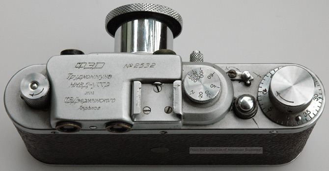

According to them the oldest know FED 1b with a 1a serial is the 2532:
