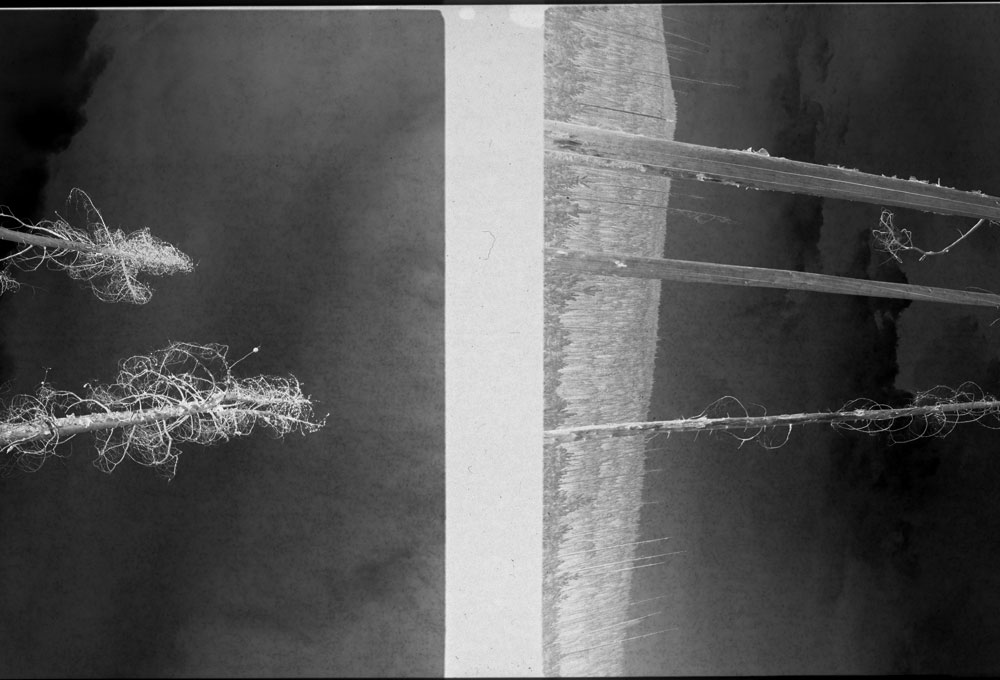

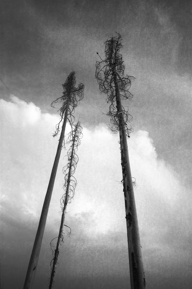

I recently did some rodinal stand processing and I ended up with these weird blotchy marks all over the film. I had 2 rolls in the same tank, and 1 roll had it strongly, while it was mild on the other roll. I had this happen twice before, seemingly at random. On one it was just on the last 2 frames on the outside of the roll. Another thing I noticed was these marks go outside of the frames and are spread across all of the film.
I really don't know where to start with what could have gone wrong. The rodinal I used has turned purple and has crystalline chucks at the bottom, so it might be time for a new bottle. This did happen when the bottle was new, so I don't think it's related.
Here's processing info:
-Rollei IR 400
-Rodinal 1:75 (tends to come out thin at 1:100) + 4 drop edwal wetting agent in 1 liter
-5 minutine water rinse with 2 minutes of initial agitation
-60 minutes of development with 2 minutes of initial agitation

I just don't understand why people stand develop and wonder why their results are inconsistent. To me it reads something like, "Why have I got strange marks on my negatives? I just don't get it. I stand developed for 3 weeks in a 1:1000 mixture of dirt from the backyard mixed with some stuff I found under the sink. What can possibly have gone wrong?".
I've not had problems with Rollei 400 IR developed according to the instructions printed inside the box. It is quite an expensive film and there is enough to go wrong with IR photography that straying off-piste with development seems to be asking for trouble.
If you are saying the marks go outside the frame area then this is odd. After proper fixing there should be nothing left outside the frame area (except frame numbers). The film base should be clear outside the frames and on the tail end of the film (that was not exposed). Perhaps post a scan of the negative showing the film from edge to edge and as a negative not a positive. The film base of Rollei IR is PET not acetate. It is more prone to "light piping" than acetate.
The pictures you have posted just look like large grain to me. I suspect that is a consequence of the development you have chosen. The grain is quite small with Rollei IR with the right developer.

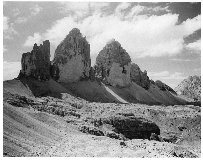

Picture attached was taken on Rollei IR 400 35mm, R72 filter, high altitude, Xtol 1+1. 8"x10" print.

Here's a scan showing these marks outside the frame.
I don't really find the grain to be much of a problem. It's still finer than SXF200 with more standard development. I've used this developer/film combination about 40 times with perfectly good results.

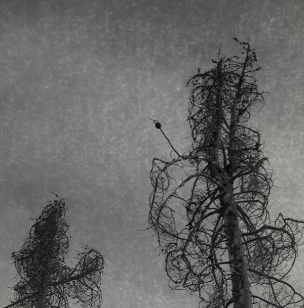

I don't think this is specific the Rollei IR 400. The other two rolls where this happened were Efke 25 and Rollei Ortho 25.
The wetting agent is there because I was having problems with huge numbers of bubbles getting stuck to the film with Rodinal and Pyrocat. I tried the wetting argent, and this all went away.
I did some digging around, and I found someone who got pretty much the same marks:
https://www.photrio.com/forum/index...se-strange-marks-on-fp4-120-negatives.147870/
People there were suggesting problems with the backing paper getting damp.

You could try the standard development methods and see if the problem goes away. This doesn't necessarily prove it was the stand development as the problem is intermittent. If you think it might be insufficient fixing you could always re-fix in fresh fixer. You won't lose anything from doing, it will rule that out and it is quick and easy. Theres no need to re-fix the whole film, if you have cut the film a few affected frames will do and you can do this in the light. Air bubbles usually move with a few sharp taps of the tank on the bench and also move with the conventional agitation regimes but with stand development I can see how they could be an issue.
