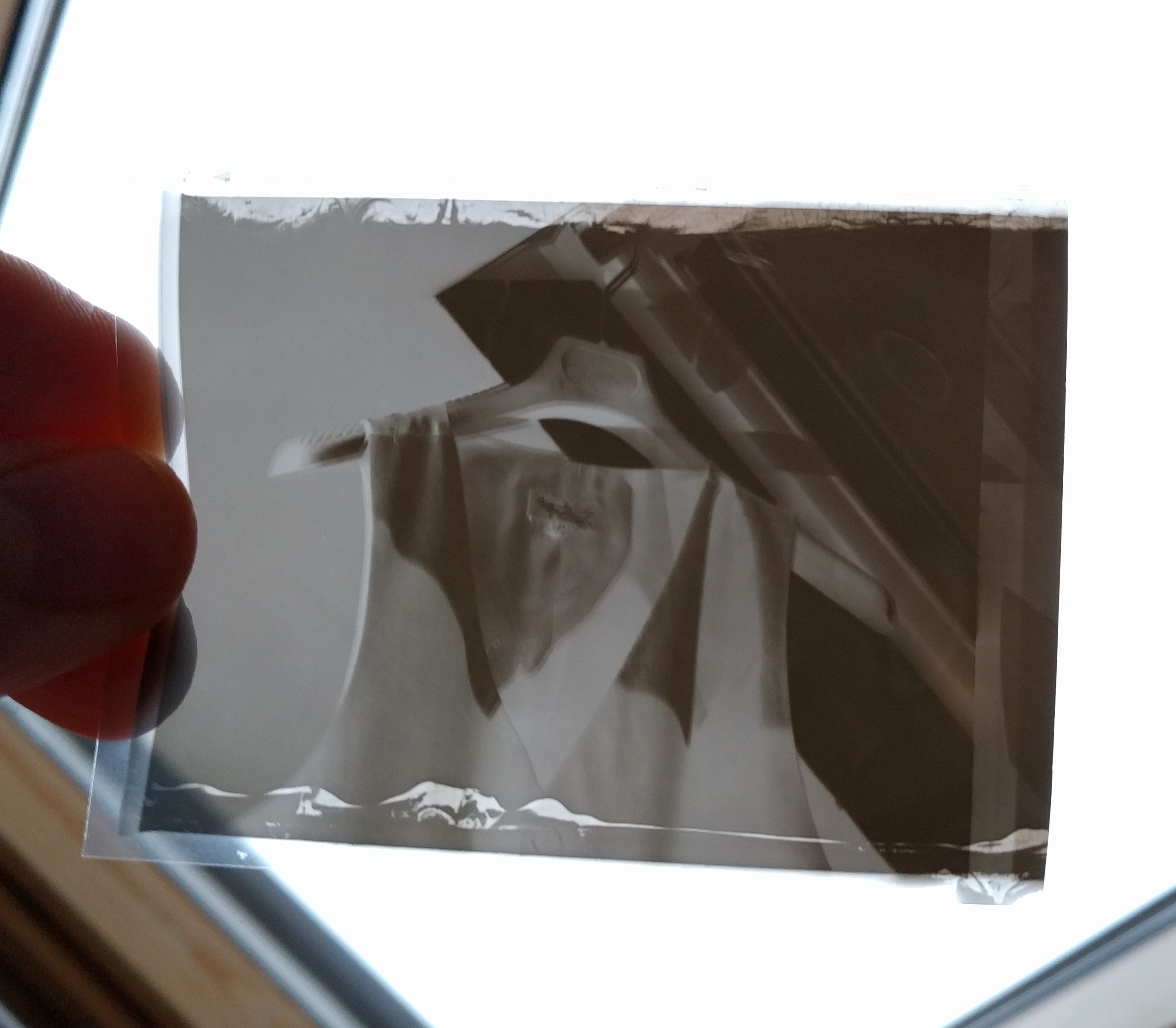

strange marks on negative

acros 100, developed in pyrocat hd 1:1:100, minimal agitation (presoak 3 min, then developed in paterson tank, inverted 1min, and after that 10 seconds ever 3 min, total of 12min)
fixed in fresh fixer.
can it be a faulty batch? or that the film was in the fridge (in his blister) leading to condensation?
it happened also a while ago, i think also with acros, not sure..
comments appreciated.
good night from paris
chris

looks to me as if the areas shown are not developed or developed fully,could be that the reel slid up slightly on the colum, it can happen with patterson reels it happened to me many years ago, I learnt that it pays to use a little more developer than the tank says, I use 600ml with 120 rather than the 500ml, The other answer is to use a rubber band tight around the center coloum above the reel
AgX
Apr 5, 2007
29,972
Germany
If they were not developed fully the density (as seen at the lower edgde) would not been lower than D(b+f).
It could be something diffusing added to the emulsion, or the emulsion being partially lost.
I do not think we can examin the artefact based just on that image.
well, i do use 600 ml. and if this were the case, then it would only affect one side of the strip... thanks, but its not that i guess..
ok. will up a better image right away..

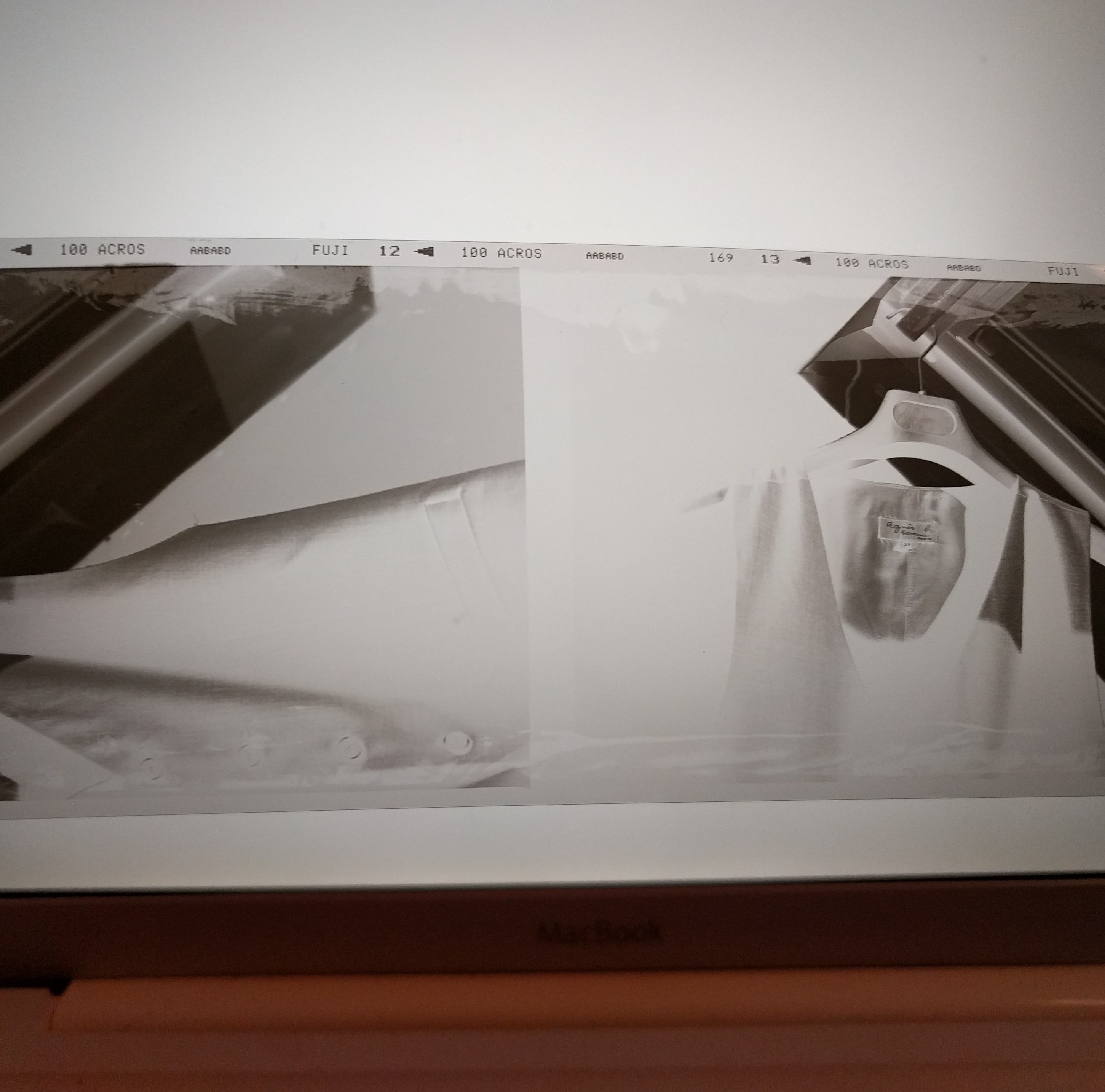

its an accidental double exposure. shows the marks even better... i am more and more convinced its the emulsion...

I agree it looks like emulsion separating from the base. It's the same problem I've had and have posted about extensively here, though yours is on a much larger scale. I haven't figured out what variables exacerbate it, because I've changed everything about my workflow and process. The only thing I haven't fully explored is if it's related to keeping the film frozen.
Acros is a beautiful film but seems to require special handling.
which developer did you use?

I've used HC-110 in different dilutions and XTOL 1+1. Choice of developer didn't have any effect.
the only common thing is that we both have been storing it in the fridge (or freezer in your case). but hey.. who doesnt? maybe a faulty batch after all?
I don't know. The damage in your case is pretty severe, and signs of handling are clearly visible (I see "brush marks" in one spot). Other emulsions might stand up to it better such that it's not a problem, but Acros is known to be a soft emulsion -- hence my comment about special handling.
What temperature did you process at? Did you subject the film to any sudden changes of temperature in the course of changing baths?
Hmmm -- I don't, some IR film is the only thing I've stored cold. Acros a year or three past the date still works fine after being stored in my living quarters (which are admittedly air conditioned in the summer). I've shot a fair amount of 120 Acros over the past 8 or 9 years, do not pre-soak, develop in HC110 1+63, and can't say I've ever seen a problem with it.
well, after i had seem that the strip was messed up, i didnt pay attention to it. so there might be marks from handling. normal temp. around 20c. no sudden changes at all..
chris77
Jan 11, 2015
708
Paris
the strange thing is that i have been processing acros for a while in exactly the way i described, and it was fine until recently..

When some of us went on an Ilford factory tour a few years ago we were told many problems with films came from refrigeration and freezing, they need to warm up slowly.
Acros has quite a soft emulsion so it's likely the damage was caused by the fridge and warming. I've used it with Pyrocat HD 1+1 to 100 a few times usually at 27ºC while in turkey with no problems. I keep my films in a bottom drawer even when the outside temperature is over 40ºC, luckily we live in a ground floor apartment so it stays relatively cool.

Not enough chemicals in the tank, the reel slipped up on the post, emulsion separating, film not allowed enough time to thaw ... any of these, but one thing is clear to me ===> it is not the fault of the developer.
