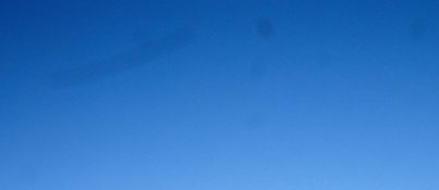

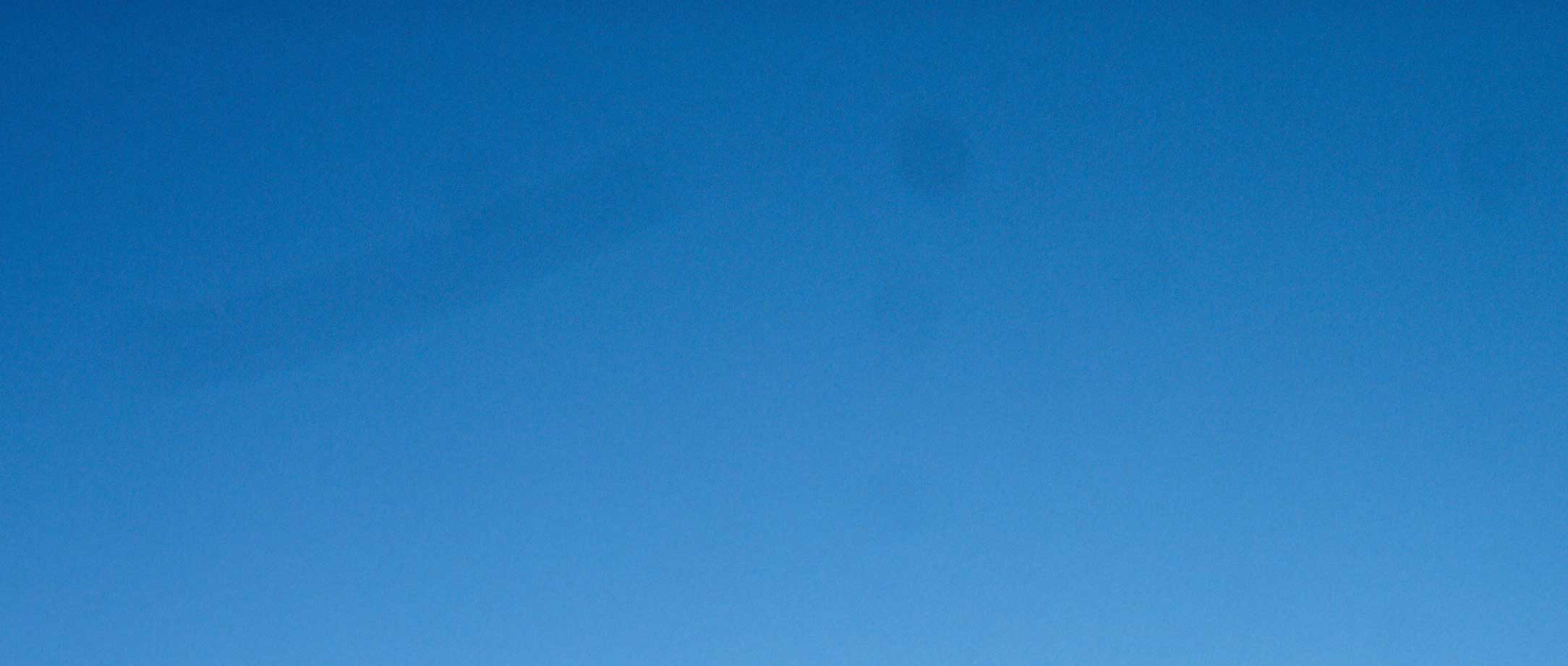

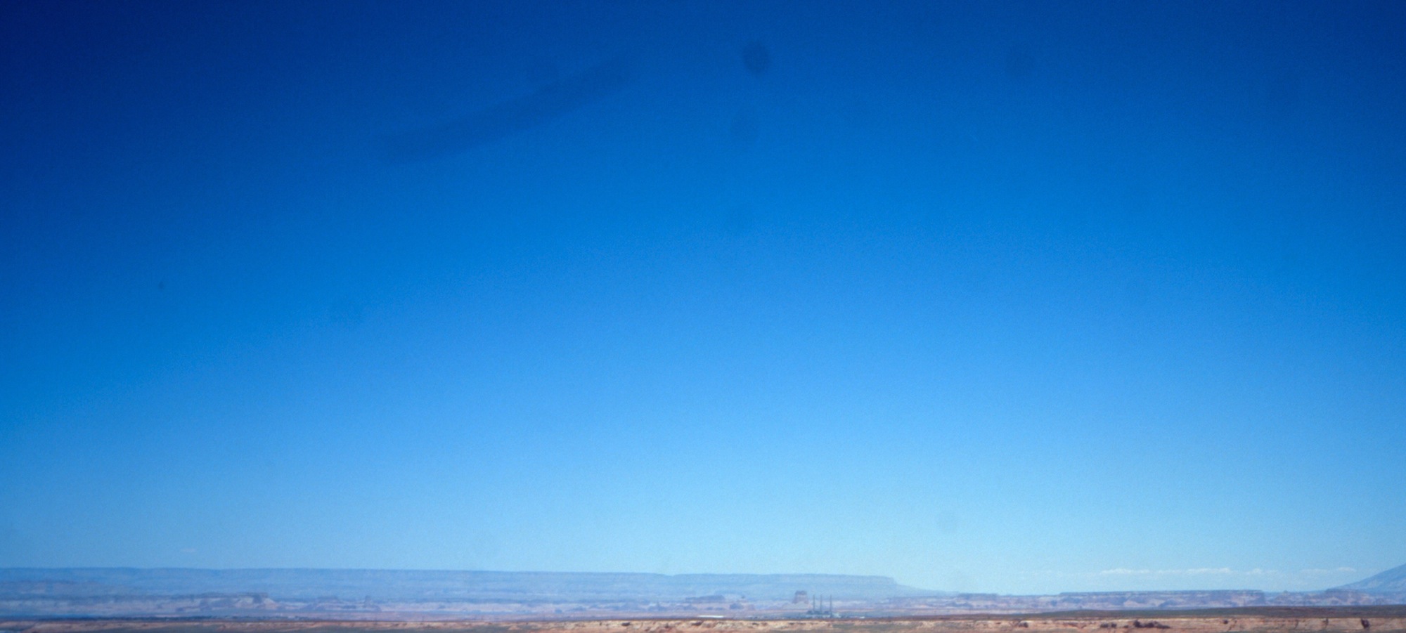

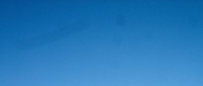

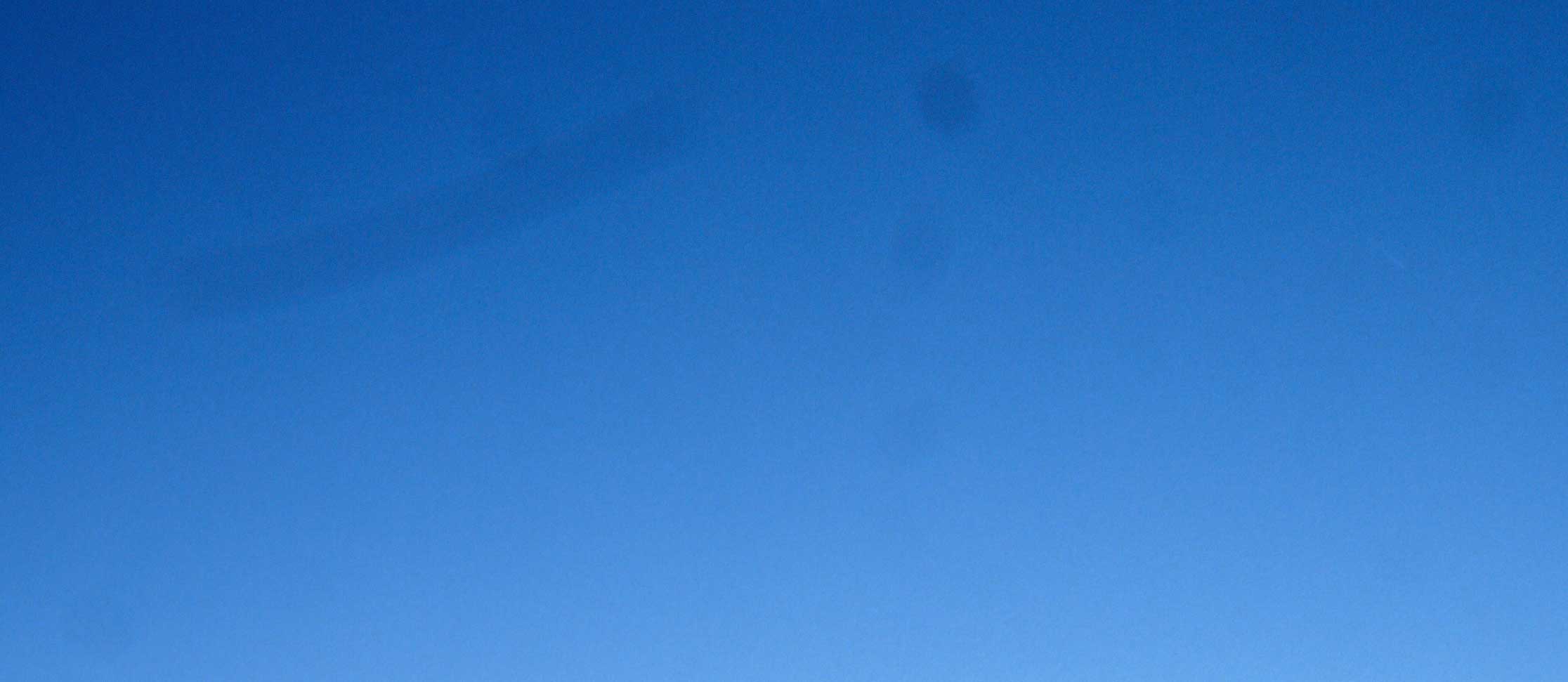

Yes, it's one of those threads. I came back from a trip to Southwest USA in June with around 10 rolls of E6 shot on a Fuji GA645Zi. On about 6 rolls a couple of frames show darkened areas all with the same pattern in the same area, most noticeable where that coincides with sky. It shows on anything from one to 4 or 5 sequential frames sometimes near the start of the roll some at the end. Most of the film is 100G, two rolls of Fuji 100f and shows on rolls I processed and a lab processed so it is not film or processing.
My thoughts lead to moisture, possibly humidity but it is exactly the same pattern and position in the affected rolls and cannot think of anything that the camera might be responsible for. Any ideas?
Thanks
Samples (Ignore the moire type pattern I think that from cropping and compressing the samples, it is the long sausage shape and large dots)

Can you show us a full frame with the marks? On which frames of the film do the marks occur?
It is difficult to determine whether this is influenced by handling of the film, the camera, handling of the positives or post-processing (like your scanner).

Thanks for the replies. To clarify further:
The marks are visible on the transparencies.
They are usually mid roll and affect a few frames with diminishing effect. So if 4 are affecting the last number is lighter than the first. On one roll the last frame does show it faintly.
If it was dust on the lens I would expect all frames to show it.
Maybe it was condensation on the lens but always the same pattern? Although perhaps moisture might form in the same areas due dust particles or dirt? I was going back and forth from hot outside environment to a cooler, or cooling car interior.
