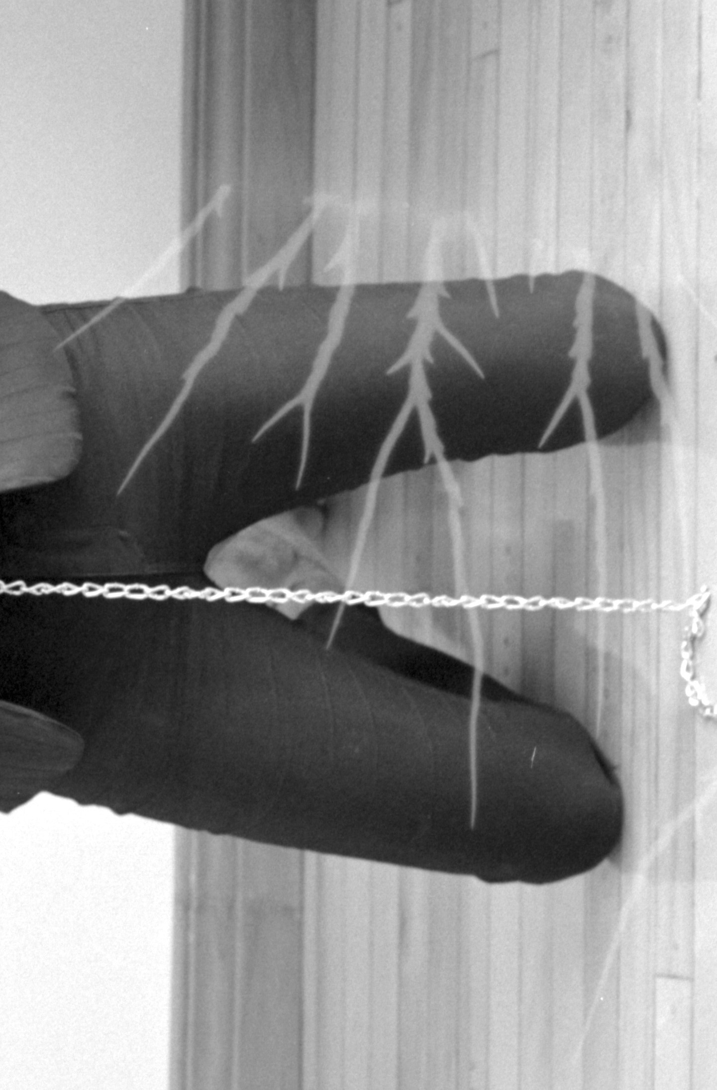

Hi,
I have developed an Ilford HP5+ using DDX.
My DDX and my Fix are new. Only the washaid and stop have a few month but are still inside the "half bottle life".
At the moment the film was hang for drying, I saw the formation of these strange marks on one frame. Its like if there was a residu of some chimical. The marks spread rather quickly.
I have respected the T°C (20°C) and time. I suspect that my problem comes from the last rince (10 min) : not enought water? (ie.: not enough pressure from the facet).
The film was in the freezer, but at room temp. at the moment of development.
It is the first I get this kind of marks.
Thanks for looking.

Static discharge?
Sure seems like it. Almost identical to what I have produced in the past.
Yes static discharge the branching structure is the giveaway.
Thanks!
I have learned something!
So... what is the best way to avoid (reduce) static discharges on 120 film (besides photoshop!) ?
The problem is pretty random and can happen anytime before development.
I believe the effect is caused by the light the static discharge makes, basically it's a mini lightning strike that exposes the film along it's track.
If you are in a situation where static is likely maybe touch the tripod before touching the back of the camera, apply that same idea to the other times you may touch the film. A nylon bag or clothing may cause this... Probably a 100 different ways this could happen so...
The risk for static discharges is higher on really cold winter days when the air indoors gets much more dry.
Remove the tape slooooooowly when you separate the film from the backing paper.

Defects occurred in the film seems as additional exposure.
From my experience, the idea of an electrostatic discharge is
reduced.
I have seen on proccesing machine (cine) that this fault appears.
The film was Color negative - Orwo NC 3.
The film rub the edge of proccesing machine (not continuous)
and produced from time to time discharges.
The film was 35 mm and discharges were recorded on film
much branched with different densities and sharpness.
In your case, your fault but less branched tree
and shows the same density. As electrostatic discharge
would have produced the same distance from defective portion of the film.
Again, it seems strange that additional exposure gives the same
density in different points of the film.
These electrostatic discharges occur at small distances from the film.
I say it may be something else.

Yes... unrolling the film slowly to prevent any «electrical transfers». I have learned my lesson. Since the basement is my darkroom I will watch the relative humidity now. Thanks again!
