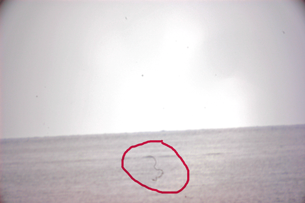

I’m getting a curly mark on the image – see looped areas of mark01.
There is no intervening ‘glass’ between the Nikon body and the objective lens of the telescope.
Image mark01 was taken out doors

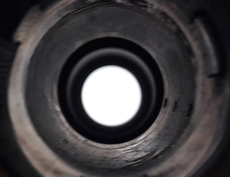

I used a mobile phone to see if anything was visible – mark03 – but to no avail.

'Fired' the camera twice without a lens. Used ps to 'explore' the image - nothing untoward.
I would have thought an eyelash or dust on the sensor would have been thus revealed

Probably not, unless you used a very "small" light source. This is because most DSLR-type cameras have a filter package sitting on top of the sensor; it holds dust particles a bit of a distance away from the sensor. So to "see" sensor dust you need a light "source" that appears small to the sensor, such as f/16 on a lens. Or, with lens removed, perhaps a single light bulb from 5 or 10 feet away.. This gives a crisp shadow of the dust particle on the sensor.
Regarding your telescope adapter, are you using the telescope eyepiece? If so, that's probably where the curly dust particle is. Eyepieces generally use (internally) a so-called field lens (or a rough equivalent) to give you a wider field of view. So if the dust particle is sitting on the field lens there's a good likelihood it will appear in the camera image.
Will try single light bulb.
No eyepiece fitted - the camera fit directly into the focusing tube
Otherwise I need to remove the objective lens assembly from the telescope to see if the dust particle is on the inside face.

SOLVED - I hope.
Used Nikon's cleaning low-pass filter routine - a lot of specks on it.
Used blower several times - no visible change BUT when using the telescope there was no curly bit shown!
So, hopefully all sorted - thanks for input
