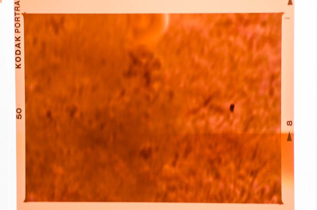

I hope you're having a great Friday. I noticed a few weeks back that I had four or so frames on a Portra 160 roll that a horizontal exposure line going across. It looks like a light leak, but it's very inconsistent. The battery was also low, as it died on the following roll. With a fresh battery in the body I did have a few additional frames out of six rolls (so not bad) with the same line. It's making me a little gun shy now and I'm leaning more heavily on my Pentax 67.
Here are a few examples. The color shots were busts, so excuse the lousy scans. The B&W shot was taken with the fresh battery. The problem is more subtle, but you can still see it.
13963952875_bfa364ccc9_b.jpg 13964399994_9d74fee039_b.jpg 14025498672_c79e5c0774_b.jpg
Just about the same location on each frame. Sure looks like a double-exposure in that one spot, though I don't recall either the preceding or following frames having problems.
I'd love to hear your theories!
Thanks in advance,
Randy

It's easy to tell. When I had a light leak the fogging on the neg extended beyond the image area and out to the edge of the film. If it does this it's a light leak.
That's right. So here's the proof that it's a light leak and not a lazy shutter. I should have looked at the negs earlier, but this is my first run in with a light leak. Lesson learned.
Here's one of the negatives. Pretty obvious now!
Thanks everyone.
