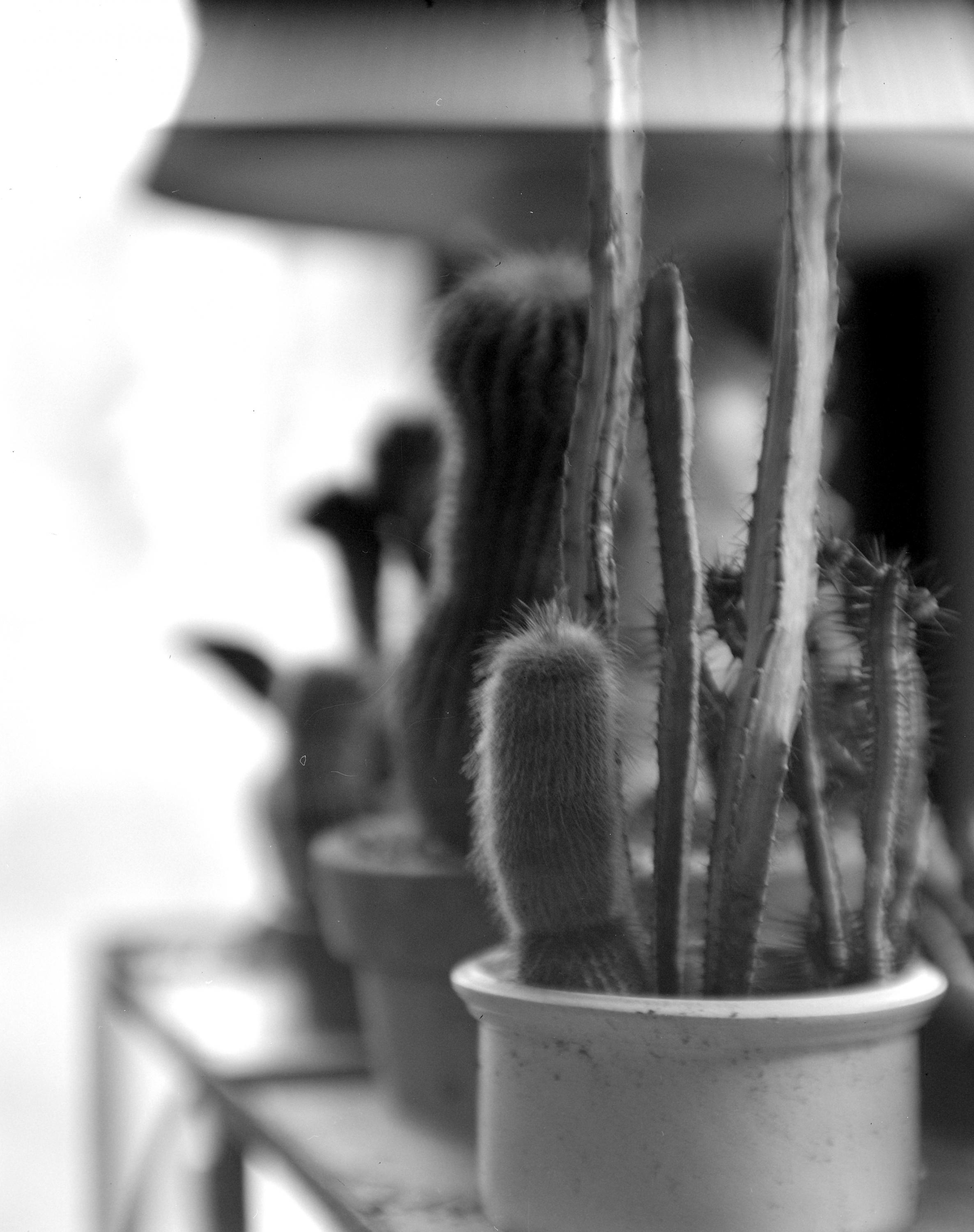

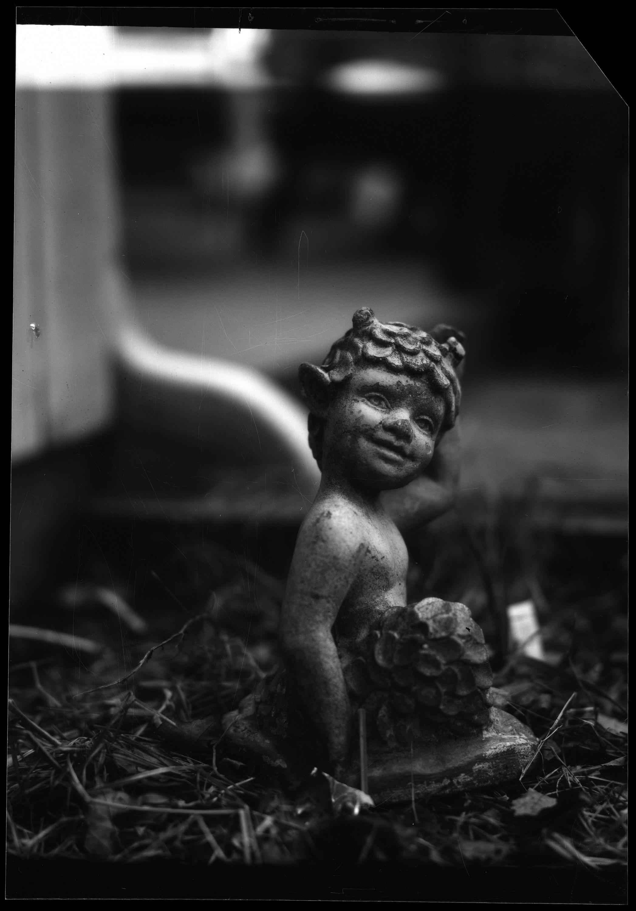

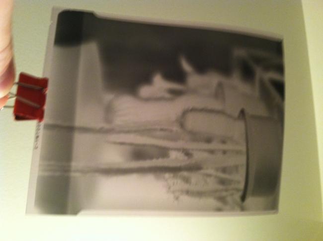

I've recently acquired a 4x5 Super D Graflex SLR (Awesome!!!)
I got impatient for my slotted film holders to come in the mail, so I took a pack film holder and rigged it up with some x-ray film, but I experienced some unusual light leaks.
I assumed that I had improperly light proofed the pack film back, so I waited for my first film holder to come in the mail.

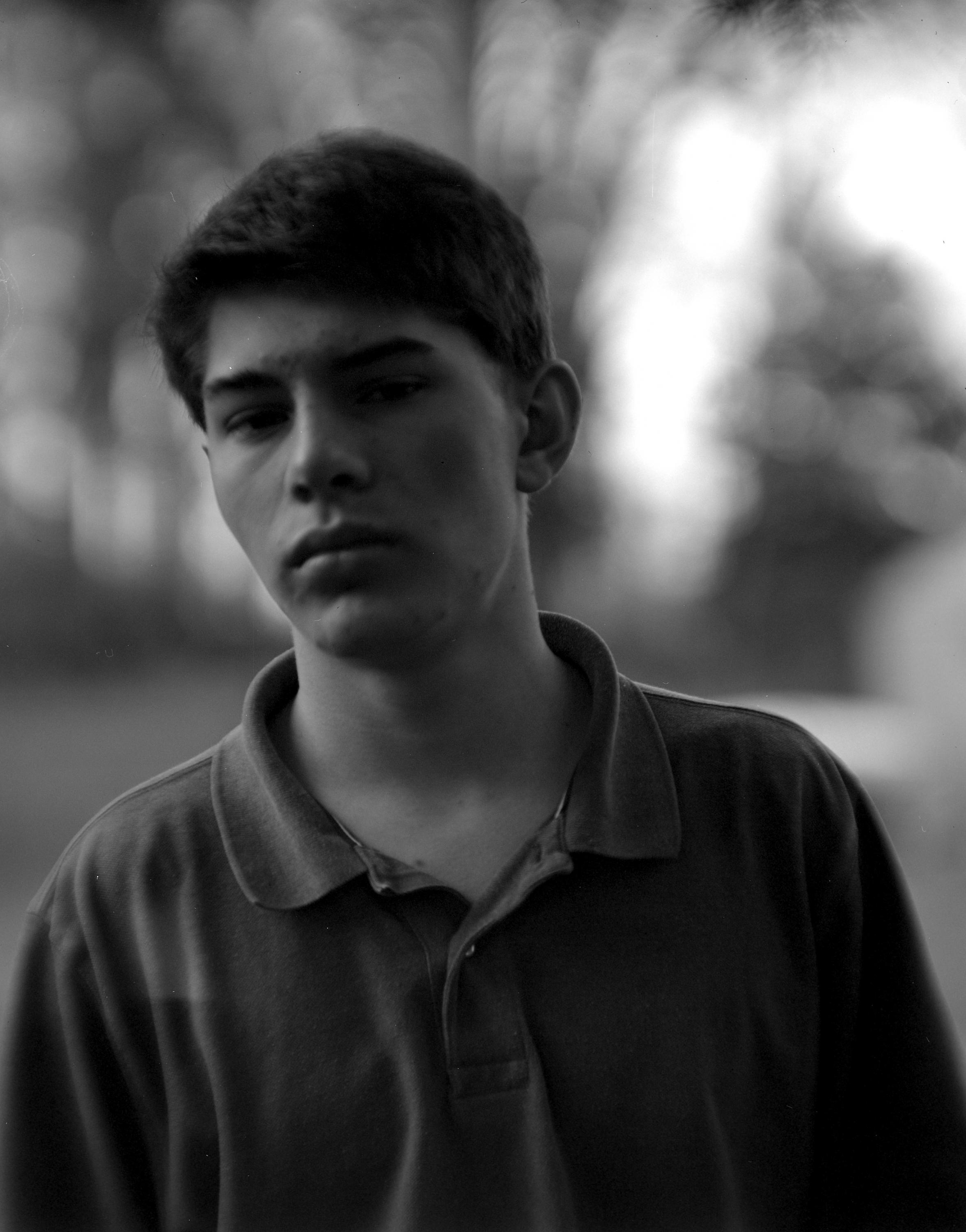

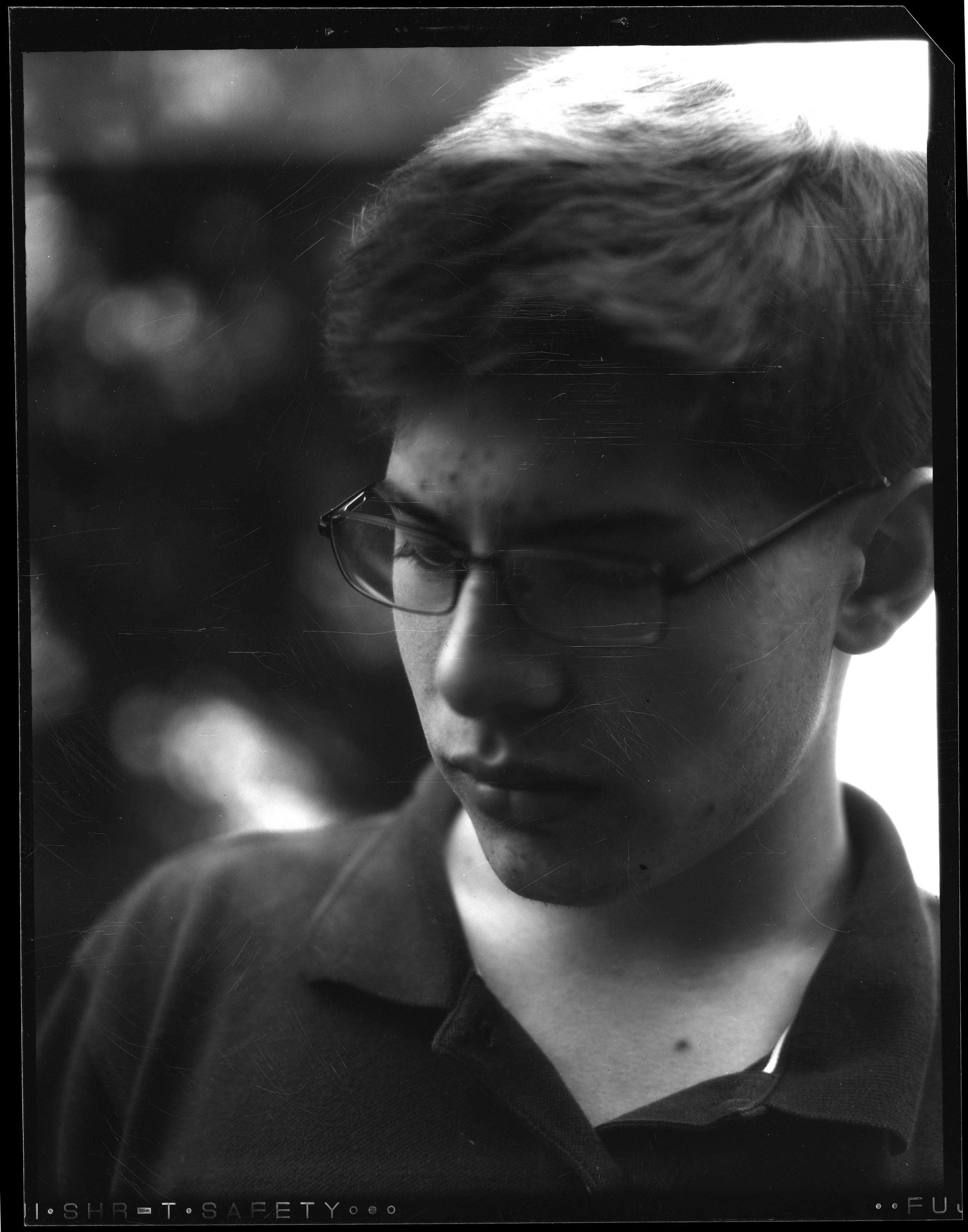

Well, it came in today, so I excitedly loaded it up and ran 4 sheets with it. I just developed those sheets, and on two of them, I have the same issue.
Is this even a light leak? I've never seen the like before. Is it possible that it could be caused by bad light traps in the DDS and pack film back? It would explain why 50% of the shots with the DDS are leaked if one side has a faulty trap, however, I would think that a light leak from the DDS would have a more distinctive and feathered appearance...
I'll post the other sheets when they are dry enough to scan

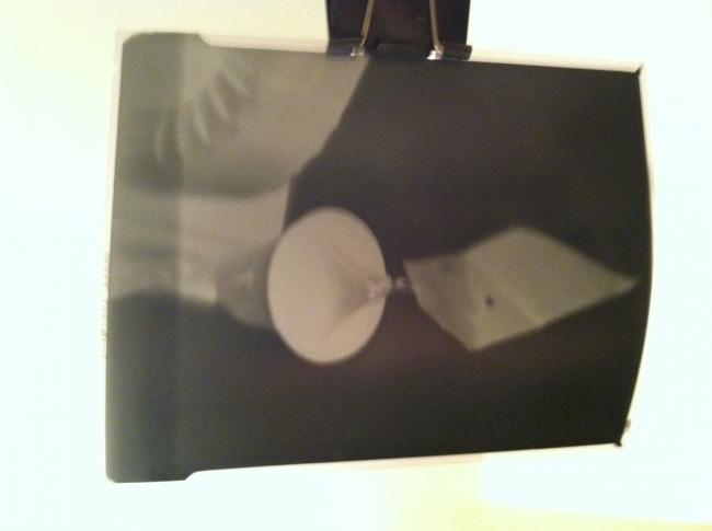

*edit* adding quick cell phone snaps of the affected negs... luckily the two portraits I shot came out ... alright. Both on different loadings of the holder

It looks more like a malfunctioning focal plane shutter than a light leak. Shutter stalls just before closing so that strip at the top ends up over exposed. Also note in your first pic that there is shake at the top of the pic that isn't evident lower down? All points to that area getting more exposure, ie image forming light rather than a leak as such.

Perhaps you're right... the shutter bounces a bit on closing on the A tension... Which would explain the consistent size of the exposed strip on the image, and why I only get it on the A tension. Why is this, and how can I prevent it?

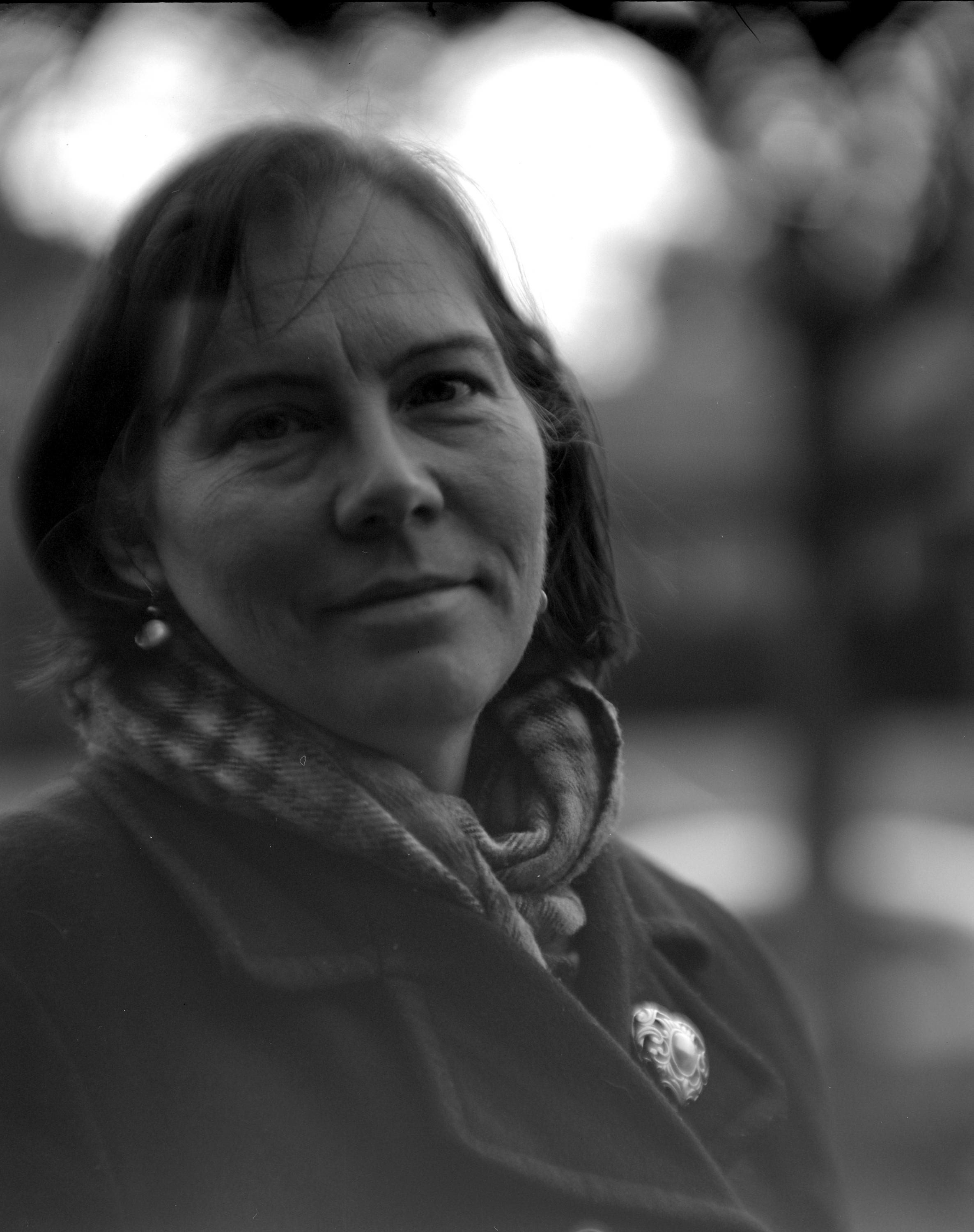

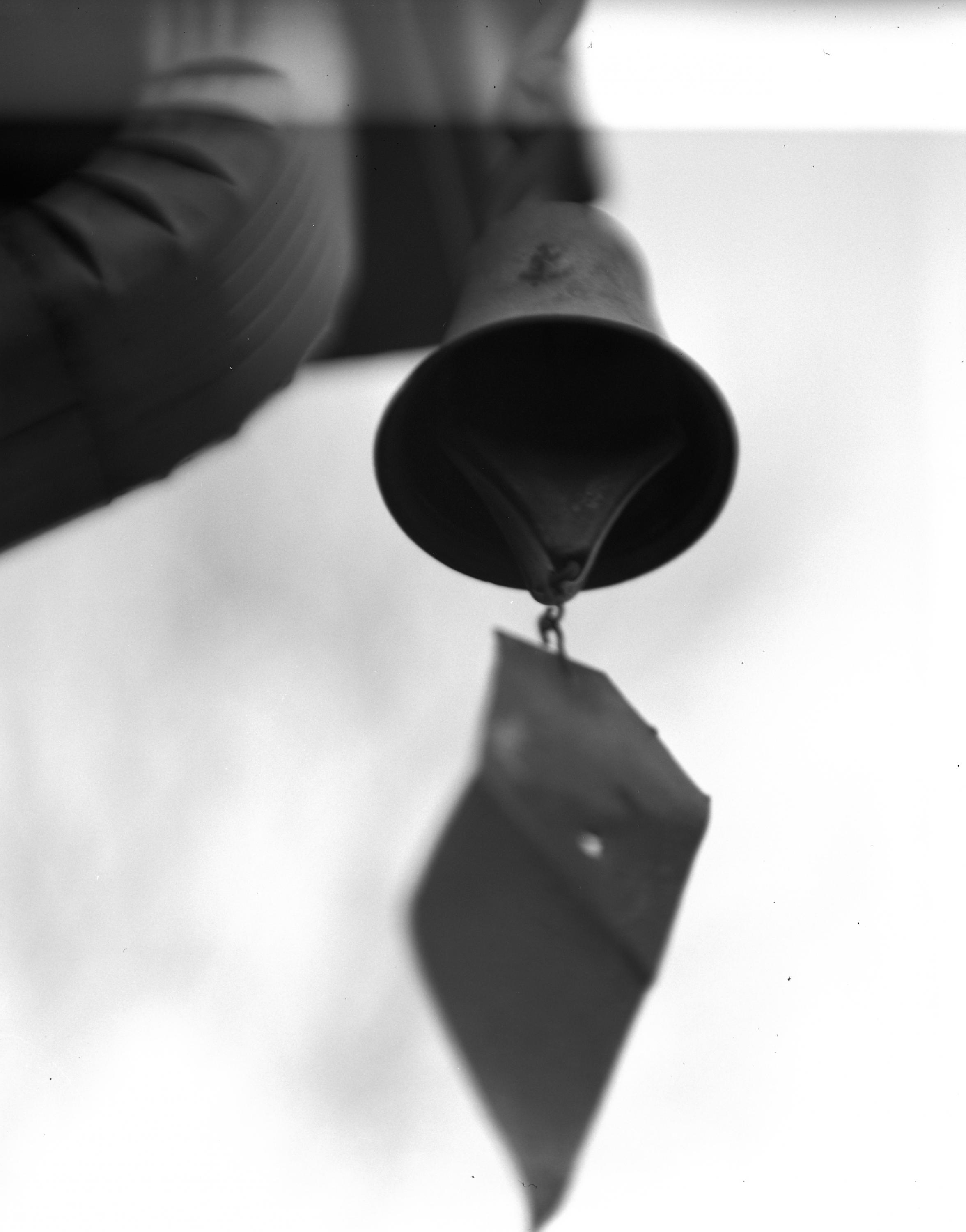

here are the scans
I used a modified barrel lens, so don't confuse optical distortion with motion blur
And here are two shot at the B tension setting on Low. I'm guessing the reduced contrast toward the bottom on the first one is due to shooting an uncoated lens into a backlit-ish area?
Could this be an error with the shutter brake? does this even have a shutter brake?

I just checked my Pacemaker speed... The shutter curtain on it when set to a similar tension also bounces slightly, however, it seems like it is wound far enough into the body by the time the travel stops that when it bounces it avoids exposing any film.
I also discovered something interesting... With the rotating back set at a 45* angle, i can see a little bit into the bottom of the camera. When the curtain ceases it's travel, it is not far traveled into the camera body at all. In fact, it's travel stops at the free spinning roller inside the back. When it comes to a stop, it bounces, exposing the film. However, when it has come to rest and finished bouncing it has returned to its original position with the metal lip of the shutter opening resting on the metal roller. But then, when you bring the mirror back down again, the shutter drops into the camera to the point where the metal lip is much further below the roller.
However, even when it is set so that the natural resting place is where the metal lip is below the roller, by winding it by hand and releasing it, it still bounces up above the roller and to the point where it would re-expose the film.

yeah, you can fix that pretty easy--the TOP roller on which the shutter is wound can be let go ONE gear tooth...that should drop the slit a bit more BUT BEWARE that the top of the next slit doesn't drop down too far....old roller shutters are sometimes weird where they shrink a very small amount and the smallest slits or the widest slits aren't in perfect synch--so if the big slits work, then the tiny (fast shutter speed) slits will not line up right....and vice versa....maybe it'll change with use....like another 100 years of use...or you'll get lucks and one gear tooth space will fix 'er perfect
