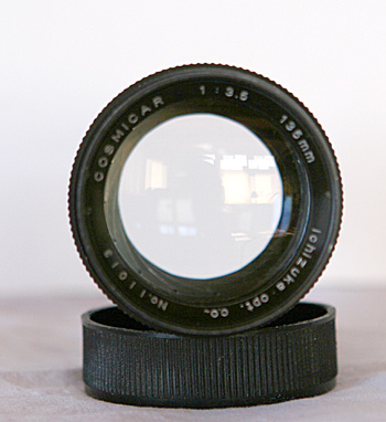

Yesterday, while down at our local camera store shopping for a strap for my new M3, I was shown a lens that is susposed to be compatible (according to the guy behind the counter) with my M3.
This is a COSMICAR 1:3.5 135MM lens made by the Ichizuka Opt. Co. It has a screw mount, but I was told a baynet adaptor could be obtained. It's about the right size and appears to be a very well made lens.
Does anyone know about this lens? Are these guys for real?
Thanks for your comments.

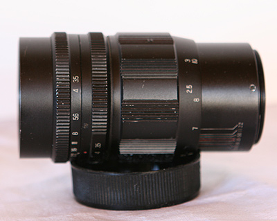

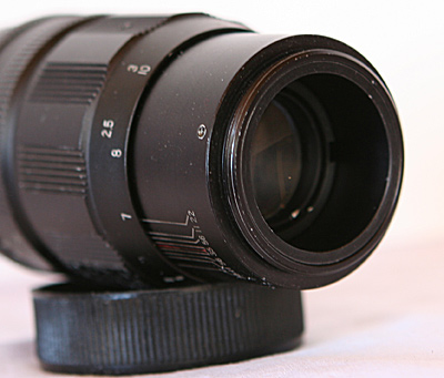

Here are some images of the lens. Since I really did NOT quite understand what Dan was trying to tell me about T-mount v.s. 1X 39mm.
Maybe the pics will help zero in on just what this lens is.

Your lens appears to have a screw thread at the rear. If this measures 39 mm across, you're home free (apart from needing a Leica screw-to-bayonet adapter). The T-mount system was mainly for old SLR lenses (and is now mainly for telescopes and similar devices), you could interchange an adapter at the rear of the lesn and fit it to numerous different SLRs. I have never seen a T-mount lens for Leica, they may exist, if they did they wouldn't couple with the rangefinder, but I am sure what you have is a Leica screw-thread (or Leica Thread Mount LTM) lens which will be fine for the M3 with an adapter as mentioned above.

David, FYI t-mount lenses aren't for any camera in particular, they're for all 35 mm cameras with register shorter than 55 mm, the native t-mount register. There are indeed t-mount to LTM (as in Leica thread mount, not as in Zenit SLR) body adapters, I have two of them.
To my inexperienced eye the lens looks like a t-mount, doesn't seem to have an RF cam at the rear. Oh, well.

Dan might be right here.
This is what Stephen Cane says:
"it's a cheap Japanese lens for SLRs
not RF probably a T mount on the back
forget putting it on your M3."
Oh, nothing ventured, nothing gained.
Thanks to all who pitched in here.
Well, as I said, if it is a t-mount lens putting it on your M will take two adapters. A mythical t-mount-to-LTM adapter, of which I have two, neither for sale, and a somewhat less mythical LTM to M adapter. And then guess focus.
Too bad your lens turned out to be M42, as you were told it would fit your Leica, I presume you will get your money back.
