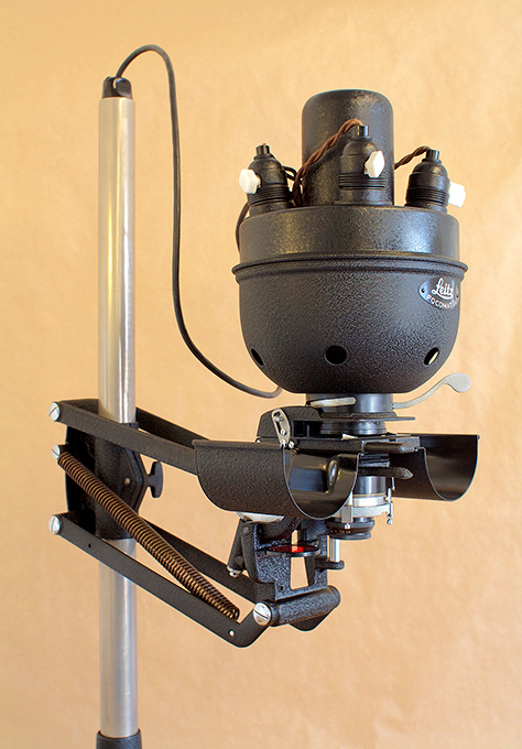

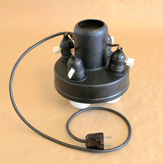

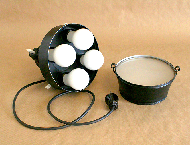

Forgive me to take you back about 80 years !
Recently I bought an older version Leitz Focomat 1c. Between the extra parts was a lamp head with four bulbs and a round diffuser with white glasses on each side. This strange lamp head fits the Focomat Ic, but I understand it was made for an even earlier Leitz Vasex enlarger. This (up to) 6X9 enlarger was produced for about four years around 1935. I am attaching some pictures of this lamp head and the diffuser.
I wonder if anyone here has even seen this item, or better if anyone ever used it? And if you are using the Vasex enlarger I would be interested to know more about that enlarger.
I am almost sure it will not work on the Ic, but I will try it on the Focomat IIc which should be closer in construction to the Vasex.
Michael

Good question! The description in a Leitz catalogue from the thirties says this lamp head and diffuser are meant to solve printing problems due to high contrast. Leitz may have figured four bulbs would be too much of a good thing for certain prints (for instance when doing very small prints). In the same catalogue they say to use ordinary bulbs of 60 watt. This one came with opal bulbs of 50 watt.

Leitz on this lamp head, in their catalogue about the Vasex enlargers: "If, however, complete diffused light is desired for special purposes, as for instance to soften the appearance of much retouched plates, a special diffused light system can be fitted for the illumination system. In this alteration the upper hemisphere with its 75-watt opal lamp is simply exchanged for another with four ordinary 60-watt lamps, and a special combination of matt-surfaced an opal discs put in place of the two removable condenser lenses"
In other words, it was an accessory lamp head & diffuser meant to solve high contrast issues. The Vasex enlargers went up to 6X9 and I doubt if switching off one bulb makes any change in only one part of the image. When I make tests, I will have a look if even illumination is affected by turning off one or two lamps.

Today I tried this lamp head on my Focomat IIc. Took out the filter tray and replaced it with the rectangular cover plate. Took out the condenser and put in the diffuser, which fits perfectly.
Very little light came through compared to what I am used to (150 watt), even though these bulbs make up 4 X 50watt . . . Also, it was a far from even illumination. I tried without the diffuser, terrible and I tried with the IIc condenser, still very imperfect illumination. So that was it for now. Next thing is to do what Leitz suggests: to use four ordinary 60watt bulbs. I doubt if this will solve anything.
Looks like the Vasex, for which this lamp head was made, was very different from the IIc
