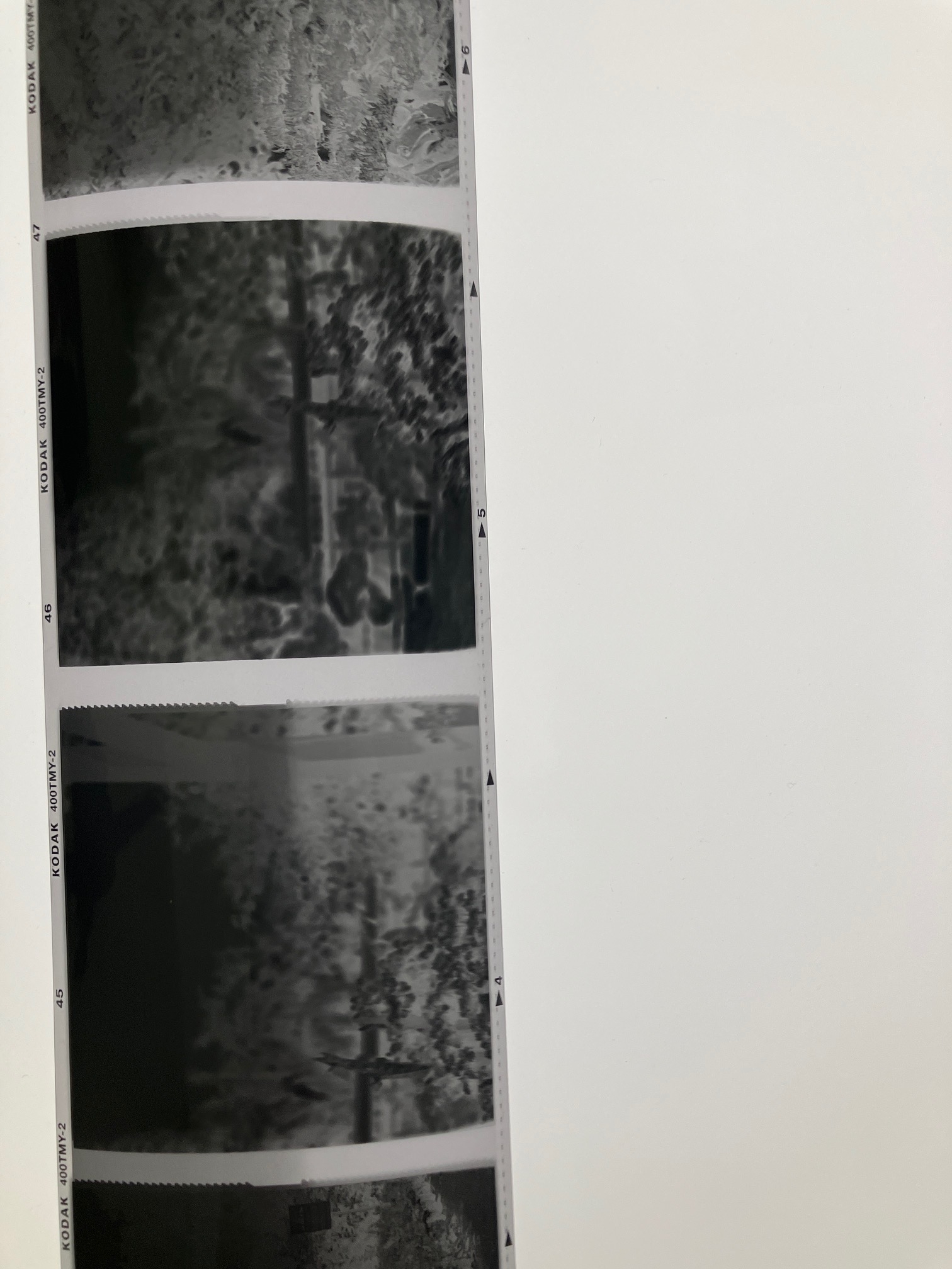

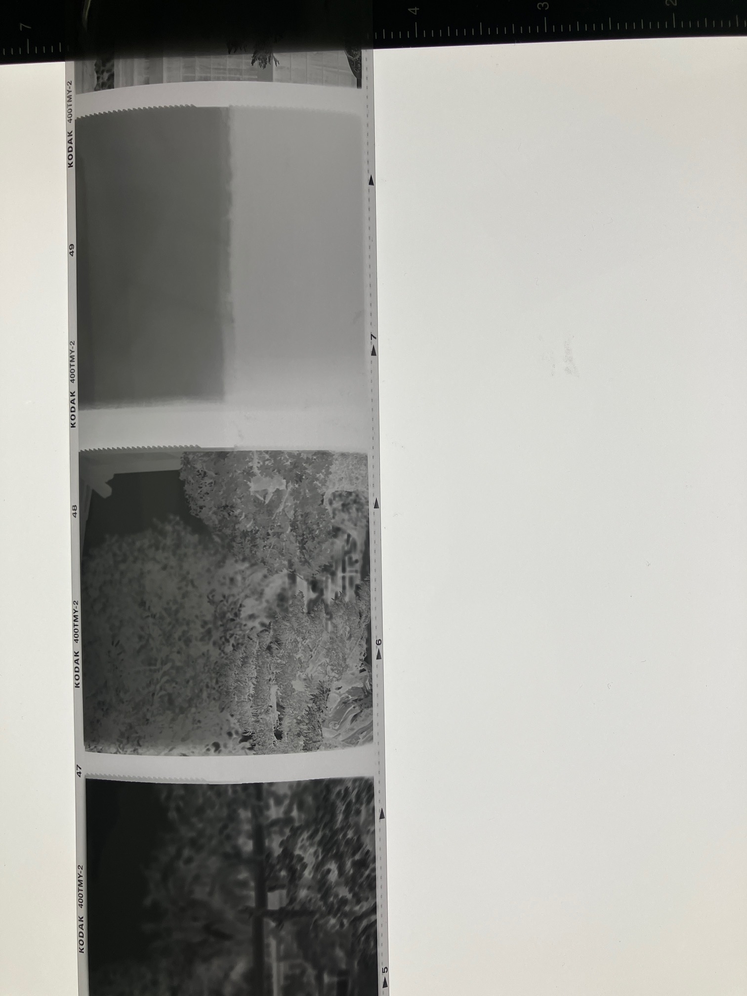

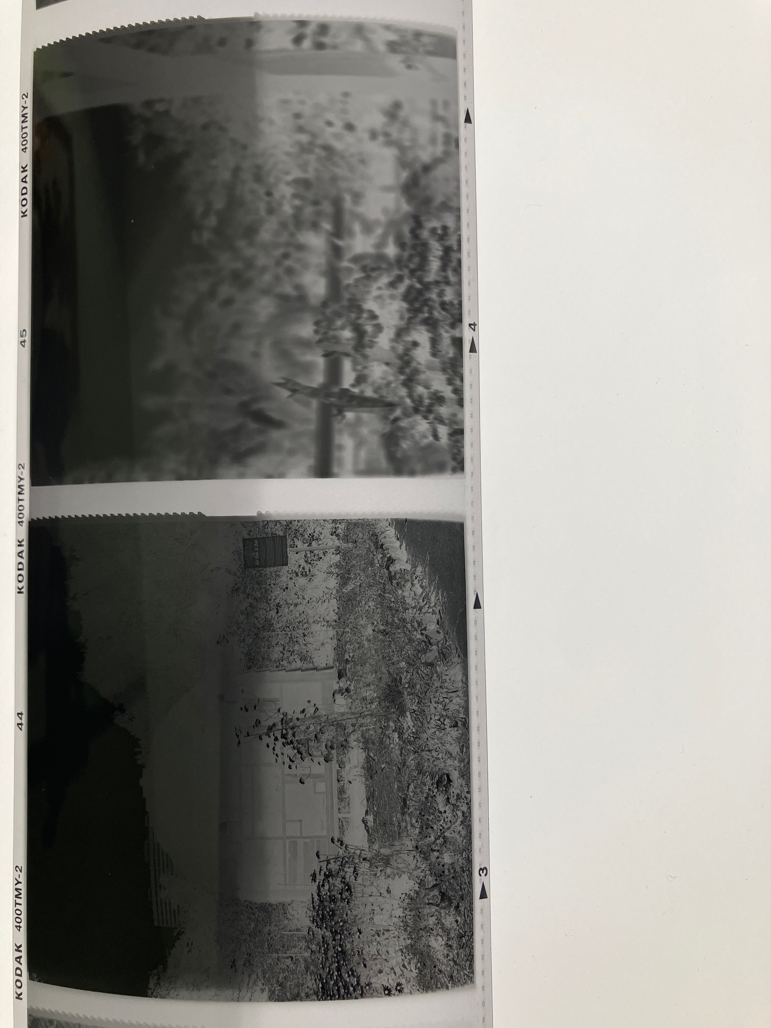

Here's a bit of confusion...Recent-ish shutter service on an Agfa Isolette folder, first 6 or so rolls were perfect, but now getting strange density irregularities on the negatives. These photos are from the last two rolls.
It looks like shutter capping, but the Isolette has a leaf shutter. There is nothing detached inside the bellows. The shutter opens completely and fully when testing. Other rolls of 120 developed around the same time (but different camera) are ok.
Any ideas as what could be causing this? Thanks!

Light leak? That first one with the striping on the bottom edge doesn't fit the rest of issues.
Check bellows. Maybe one edge at the body has come loose and hence the hard shading effect? Because of that shading I do think that it may be right near the film itself and a part of the body is shading, and the location points to... the top edge? With the body shading the leak allowing it only to hit the lower part of the film, hence the upper part of the image.
As always, place the film in the camera and see if that gives you any clues.

The serrated edge on the left side of the image 'dark' areas seems to match the rippled surface on the left side of the film gate shown in the back of the camera. Light coming in from front top with a 'rightward' bias in position?

Yes, this is interesting. I noticed the sawtooth pattern, but didn’t associate it to the same pattern in the camera.
Light from the top/right edge of the bellows?
