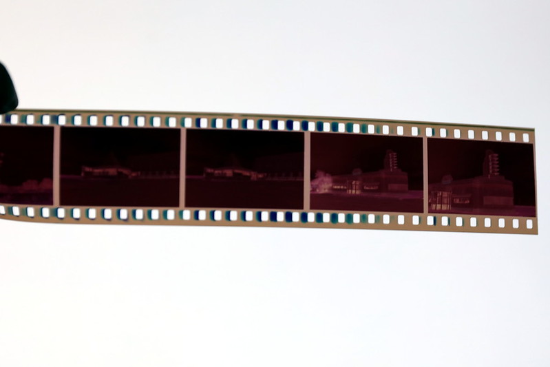

I'm wondering if anyone has seen this before?
I'm climbing the learning curve on C41 processing and came across something strange. On one roll, one roll only out of several I recently processed, I noticed some unexpected blue-ish stains or splotches between the sprocket holes on the first few frames. First few frames only. All of the others are normal.
All of the images, including the ones where the blue marks appear, appear normal when scanned and printed. This is Svema C41 film.
Anyone seen this before? Thanks.

Look like light fog, light coming thought the sprocket holes. I have seen this before. Is this at the start or end of the roll? Usually the roll will have fogged areas on other parts of the roll.

It was the start of the roll. I'll look for the leader in the trash and see if it gives any more clues.

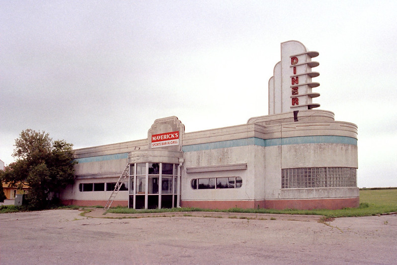

No fogging at all. Below is the third (edit, actually the 4th, but right where it's showing the symptom) shot from the roll and it looks quite normal. The pastel-ish tones are typical of the Svema film.

Ive seen this before, but doggone it, I've forgotten the exact cause. It seems to me it might be a pressure sensitivity problem with film that is hard to wind. Could that be it? It is strictly limited to the sprocket holes and can come and go. That is all I can get from memory, but there were several more.

... The pastel-ish tones are typical of the Svema film.
Sorry that I can't help with the blue areas between the sprocket holes, but I love the look of that film! It's perfect for that art-demo diner.

At first sight it looks like the spooled film has been exposed from behind through its own rebates, partly covering itself. Thus some form of light leak.
However that fogging is strictly limited to the width of the perforation on both rebates. Which would need a rather peculiar leaking.
(see PE's comment too.)

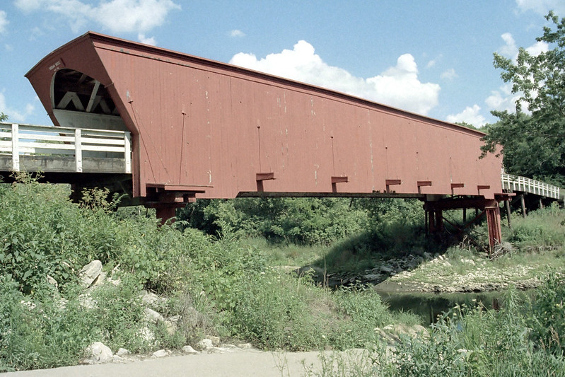

Here's another shot on that film, one of the famous Bridges of Madison County. It has somewhat muted pastel tones. It's growing on me. Great rendition of modern antiquities. :smile:

I'm wondering if it isn't some kind of light-piping along the edges with the sprocket holes? What I've been doing since I started doing my own C41 processing is rewinding slowly until I feel the leader release from the take-up spool and then leave a couple of inches sticking out so can load the film on the reel without futzing with a bottle opener in the dark. That particular roll sat for several days on a nightstand while I was out of town. However, my third C41 test roll from the other thread sat in the same place for several days longer, again with the leader out a couple of inches, and did not show any of the sprocket coloring.

More than likely the fogging through the perfs were a result of a very low level exposure of a roll in the darkroom used to spool the bulk film onto cassettes. Look at how well defined the perforation exposures are in the middle and how they become softer toward the left. This suggests to me this bit of film was just under the strand rolling off the master roll and a brief flash of light hit the strand above, shining down through the perforation and exposing the areas between the perforations. Since the exposure was so brief, and the strand above acted as a mask, there would be no exposure in the image area. The light source would have been very much a point source, as the sharpness of the perforations in the center indicates.
