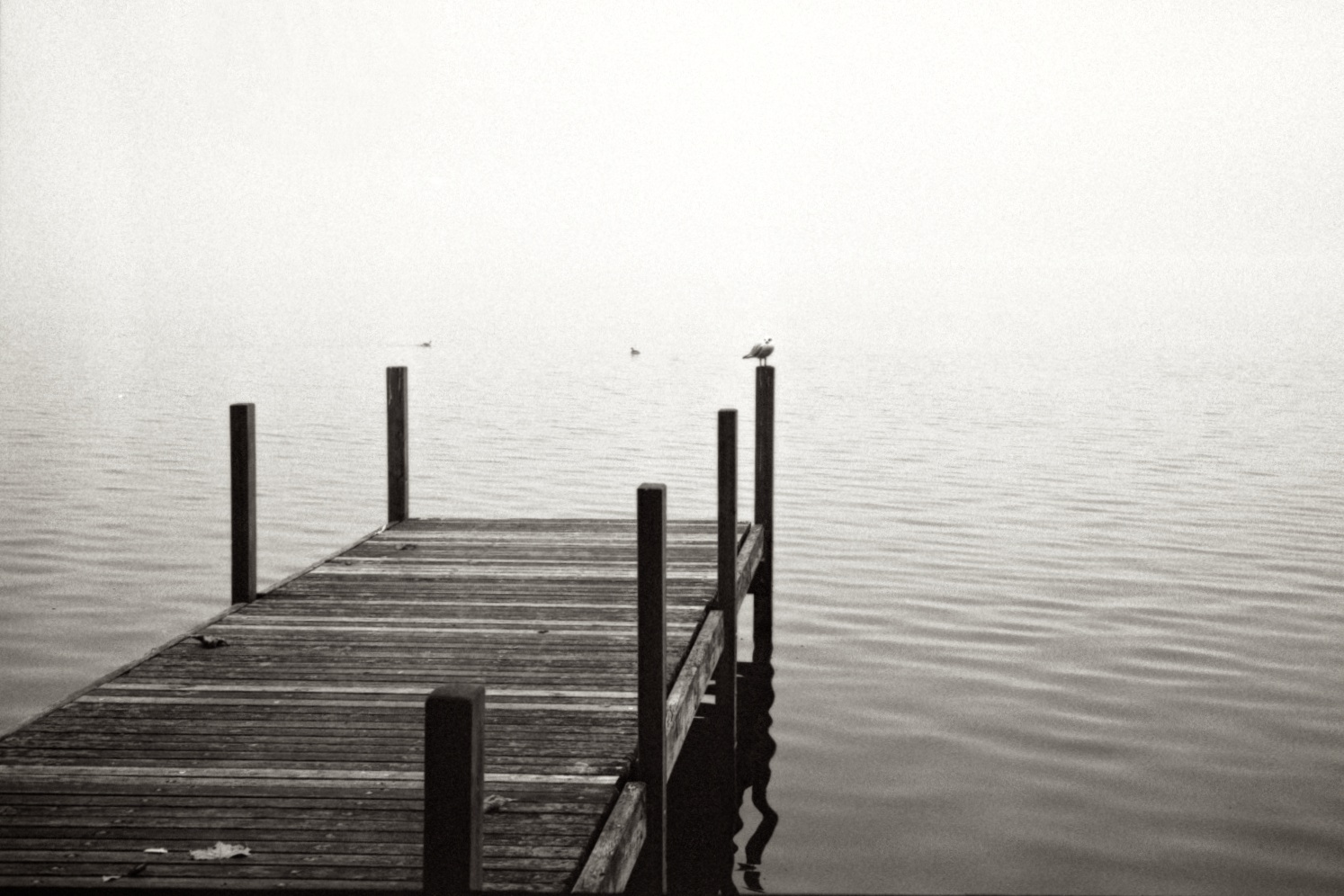

Recently some strange anomalies started appearing on her pictures. On both the left and right of the pictures, although mostly left hand side, strange concentric circular lines are appearing. It is not on all pictures on a roll and it does appear on different rolls from slide to BW. I have attached a picture of the problem (see light circles on left of picture), but this one is not as pronounced. I will post more later that are extreme.

I see it. If you bump up the contrast it's clearly visible. I would think that it's an internal reflection somehow, possibly the filter. It appears as though the light is very diffuse in this picture, but can you tell if the symptom is more pronounced in clear sunny weather, shooting into the light? If so, I would expect some kind of internal reflection.

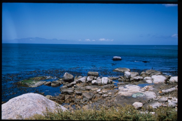

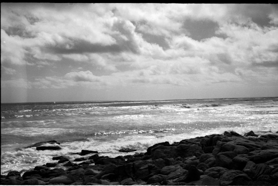

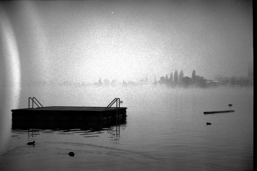

Here are some more examples of varying degree. With Superpan 200 and a red filter and slide film. There are many rolls that have come off this camera that are outstanding.

I would say there is a light leak within the lens itself since it does not occur with any other lenses (it would if it was with the body). Perhaps a loose rear gasket or a broken seal? The constant curve of the light seems to indicate it is before at least one layer of glass, whereas other light leaks I have seen are more straight.
