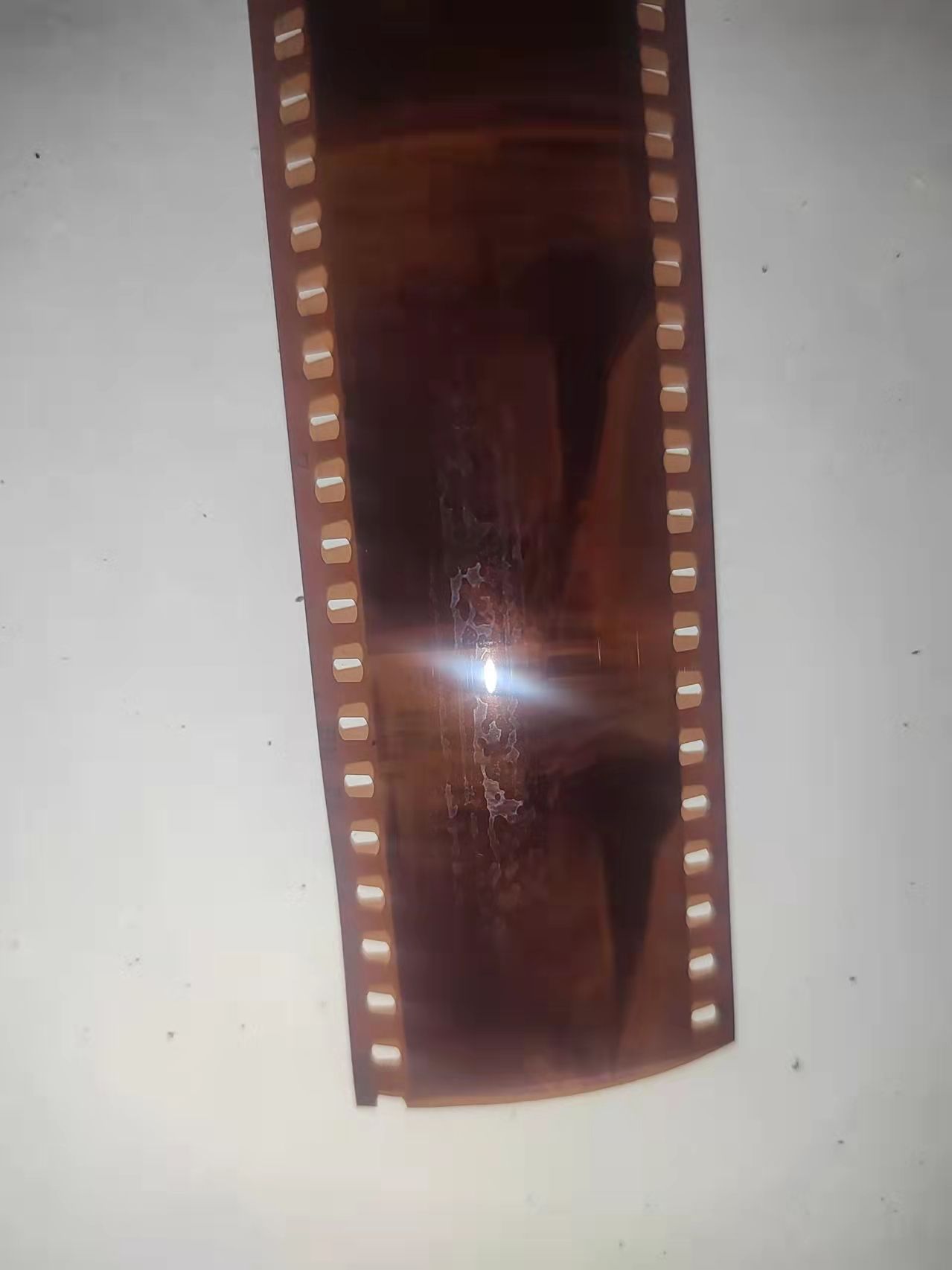

Strange blue colour on films.
Tai
Sep 23, 2023
31
Russia Moscow

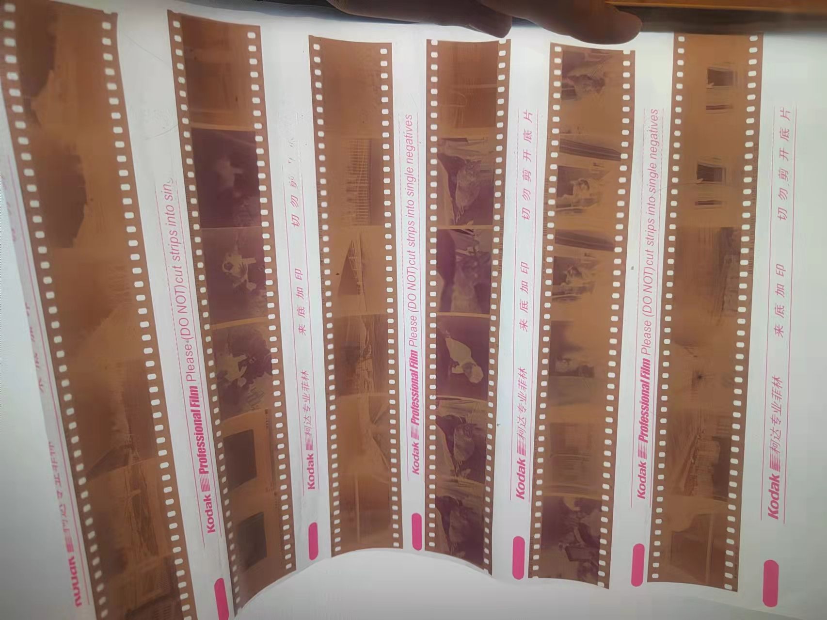

大家好:我在冲洗的一些底片上出现了蓝色的问题,而这些底片本应该是黑色的。有时整卷都这样做,有时只有少数人这样做。这是什么原因造成的?
而且我还想请教一下大家如何避免贴膜出现水渍的问题。在我所在的地区,蒸馏水并不容易获得,而且我们这里的水非常硬。
奇怪的蓝色是否有可能是由于水损坏造成的?
Thank you all.

koraks
Nov 29, 2018
25,257
Europe

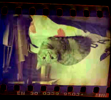

The first example (the negative with the cat) looks like it's severely underdeveloped.
color crossover from contamination between the chemicals.
Contamination of the developer should always be prevented of course, but it doesn't look like the cause of this problem to me.
@Tai can you please provide details of the developer you're using? Do you make it yourself, and if so, what formula do you use? Or do you purchase it ready for use? Can you also provide details of your film development process? Does the problem only occur with ECN2/Vision3 film, or also with C41 film?
Distilled water is not readily available in my area and our water here is very hard.
Is it possible that the weird blue color is due to water stain?
No, the underdevelopment is not due to the water stains.

lamerko
Oct 27, 2022
771
Bulgaria
I notice that there are surge marks (the dark areas around the perforation). This is an indication of an agitation or developer quantity problem. Can you specify how you process the films, with what amount of solution, and if these marks are present in the other negatives that are good?
About hard water - it might affect the pH a bit, but probably not fatal. However, it causes a lot of staining. You can proceed as follows: boil 10 liters of water for 5-6 minutes and store it in a plastic mineral water bottle. Use it in the last wash, if you have photoflo (or its analogue) - put a according to the instructions and soak for two minutes. You can reuse it for about four photo films. After hanging the film to dry, you can go over the back (shiny) side with a microfiber cloth or very soft paper, being careful not to leave any lint. This will also help with the last remnants of remjet.
koraks
Nov 29, 2018
25,257
Europe

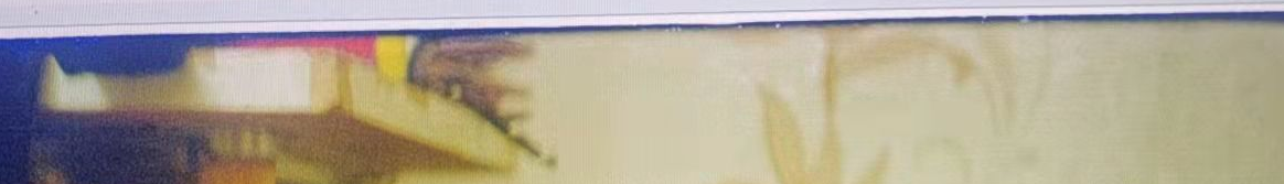

Do you mean this:
If so, that looks like an anomaly in the digital photo of the film strip (i.e. light bleed from the backlight). I'm not convinced they're surge marks at all, especially because along the top edge they appear in an area of the film where there is no density apart from the orange mask, and thus surge marks are unlikely to pop up very clearly. The story is a little different at the bottom of the strip, where the marks seem inverted. But even there, I think we can exclude the possibility of surge marks. Just look at the positive scan of the cat image, which doesn't show any density anomalies along the top edge of the frame, while such anomalies are visible in the photo of the negative.
Compare this (note the supposed surge marks especially above the 3 sprocket holes to the right):
To this (note the absence of any density anomalies along the top edge of the frame, which corresponds to the snippet of the negative above):
Had these been actual anomalies in the film itself, they would have shown up on the scan. See this crude inversion of the negative:
So I think this is something we can pretty safely ignore.
No worries, the effect of hard water on the pH of the developing baths is negligible. Even extremely hard water has barely any buffer capacity.
Your suggestion to de-calcify hard water by boiling it is a useful one; I would like to add the further suggestion to filter the boiled water before use. Boiling hard water tends to involve formation of scale that easily finds its way onto the gelatin emulsion, and once it's there, it's virtually impossible to remove. I'm speaking from ample experience!
I also second your advice on dealing with the water spots and remaining traces of remjet.
I remain of the opinion that the primary problem we're looking at here is underdevelopment. Whether this is due to a problem with the chemistry (formula/mixing/ingredient-related) or process control (temperature, time) is yet to be seen.

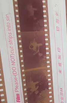

Tai
Sep 23, 2023
31
Russia Moscow
您使用什么杀菌时间和温度?在开发过程中如何将水箱及其内容物保持在所需的温度?

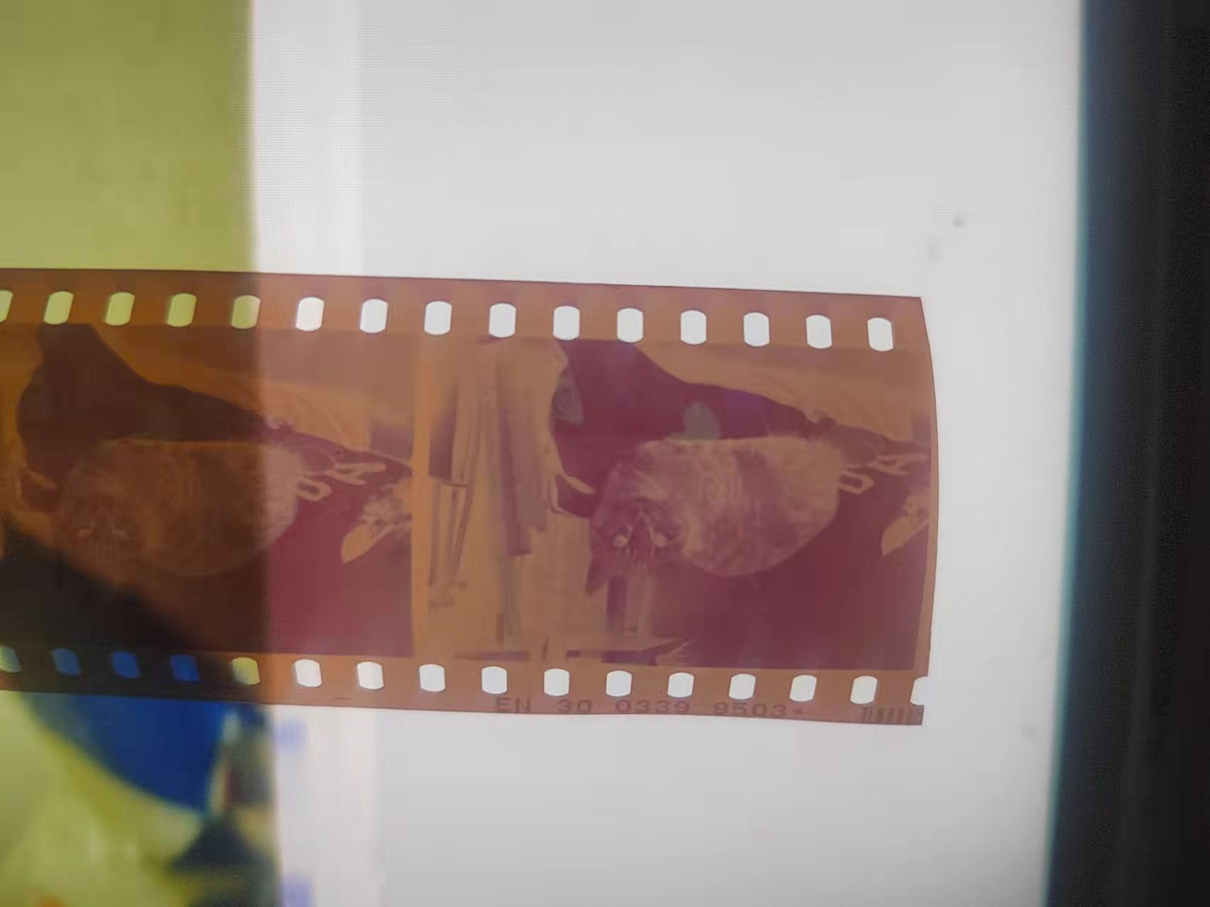

在 41.1 摄氏度下显影 3 分钟。我会将显影剂罐放入温控水箱中(使用真空低温烹调机)。奇怪的是,这卷中只有几张照片有这个问题,其他图像似乎都没有问题。
koraks
Nov 29, 2018
25,257
Europe
Develop for 3 minutes at 41.1°C. I would put the developer tank into a temperature controlled water tank (using a sous vide machine). Oddly, only a few photos in this volume have this problem, and none of the other images seem to have the problem.
OK, that sounds good, although I like to develop ECN2 film a little longer than 3 minutes; typically I develop for 3m45 to 4m00 minutes. This is because ECN2 film is designed to give a low gamma of around 1.5, and this is insufficient in my experience when enlarging the negatives (analog printing). For digital scanning, it won't matter much.

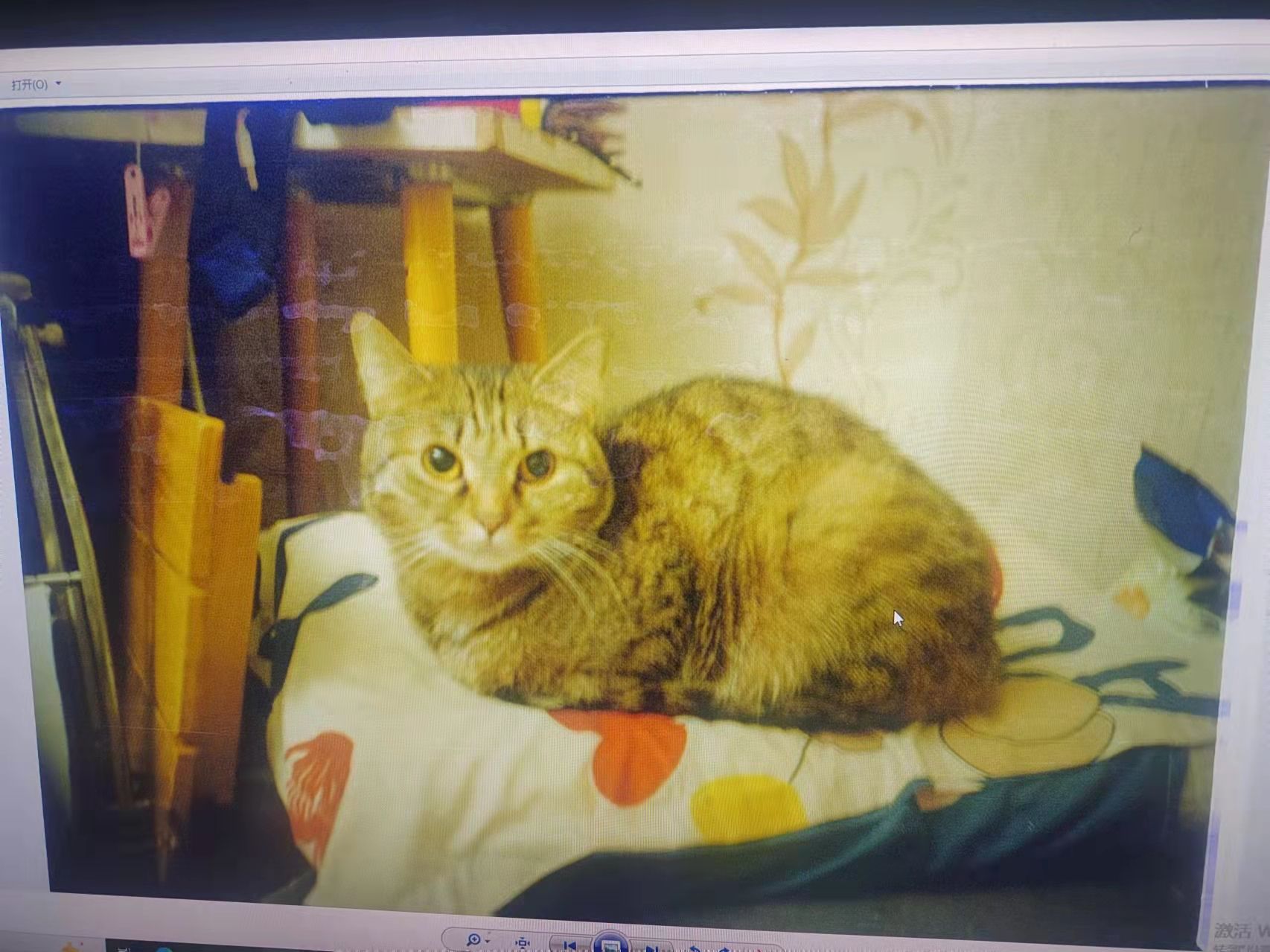

If you some images on the same roll of film are good, but others are weird, the problem is associated with exposure. The additional images you've posted are scans and scans are generally not a reliable way to judge the quality of processed film. A lot of auto-exposure and auto-correction happens on scans, so sometimes, a scan from a poor negative will still look good. If you look at the entire roll of film on a light box, do all negatives look similar in terms of color and density, or are there large variations?

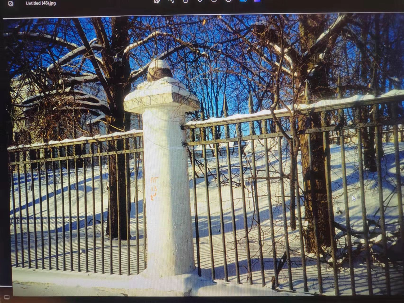

Tai
Sep 23, 2023
31
Russia Moscow

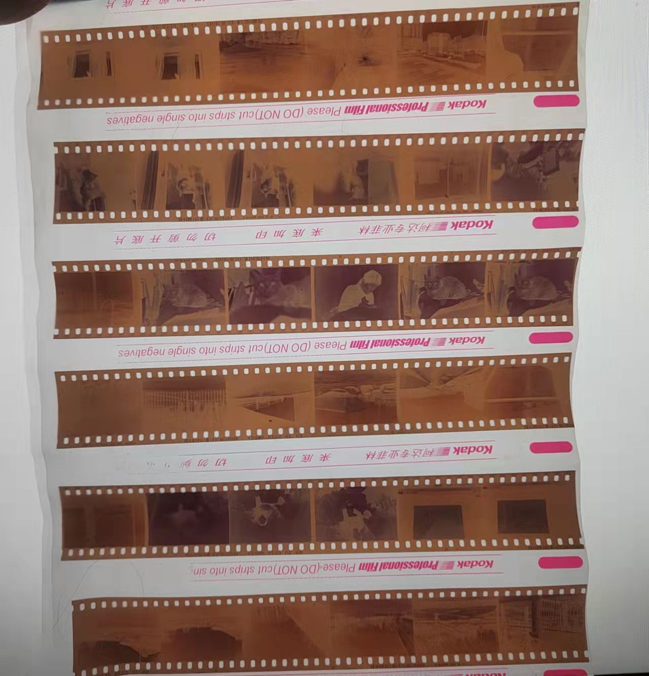

The whole roll looks like this. Could you judge the quality of my developing? Will underexposing the film cause this problem? My camera is very old and the light meter is crude and may not work very well.
Tai
Sep 23, 2023
31
Russia Moscow
koraks
Nov 29, 2018
25,257
Europe
Development is a little difficult to judge at a distance, but the main problem is quite clear: systematic underexposure.
