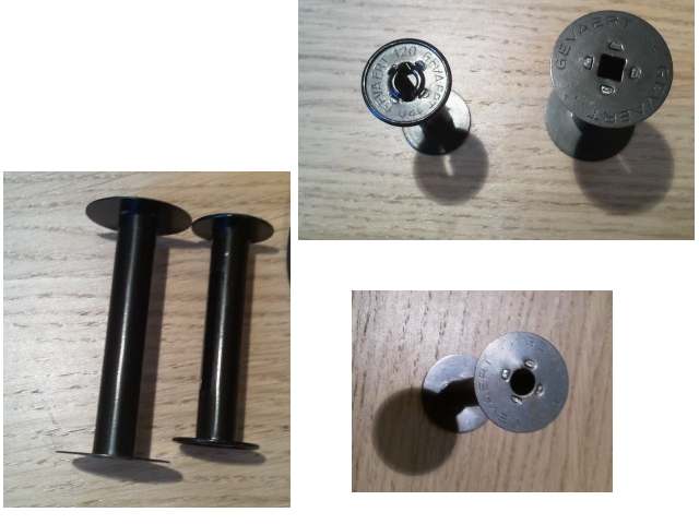

I recently got a Brownie no. 2A camera, which takes 116 film, and I want to have a go at running 120 through it. Three spools came with the camera. They look like 116 spools, all the measurements fit, but they don't have a winding groove that fits the camera. Instead, they have a round hole at one end and a square hole at the other. They are marked "GEVAERT" on the flanges. The camera has a winding knob that fits perfectly to a modern 120 spool, which is too small for the camera. Can anybody identify these spools? All the pictures I've been able to find of 116 spools have winding grooves.
The picture shows one of the spools alongside a 120 spool.
One of the spools was inside the camera, which is rather odd, since there doesn't appear to be any way the camera could actually wind it.

Good morning;
Gevaert is/was a European film manufacturer. Sometimes they did things a little differently. We have had the minor differences with the 120 spool and the 620 spool for years, in addition to the 116 film system.
See if you can find some "American" 116 spools for rewinding something like 120 roll film onto for use in your camera. Do not send the film with the spool in for processing; usually you will not get the spool back with the processed film. Instead, look into processing the film yourself. Black and white is not difficult, and you know where the 116 spool will be. If the concept of black and white only is of concern, consider that most of the photographs taken with the Kodak Brownie cameras did use black and white film, so it will not be out of character. For color, you can use a "custom processing service" where you can specify that the uncommon spool will be returned to you.
And, you might be able to use something like a Dremel tool and some fine small files to modify a film spool to work with your camera, if locating an original 116 film spool is a problem.

Did you notice that the hole on one side of the spool is square?
That works just as well as the keyway (winding groove) when engaged with the proper windup spool.

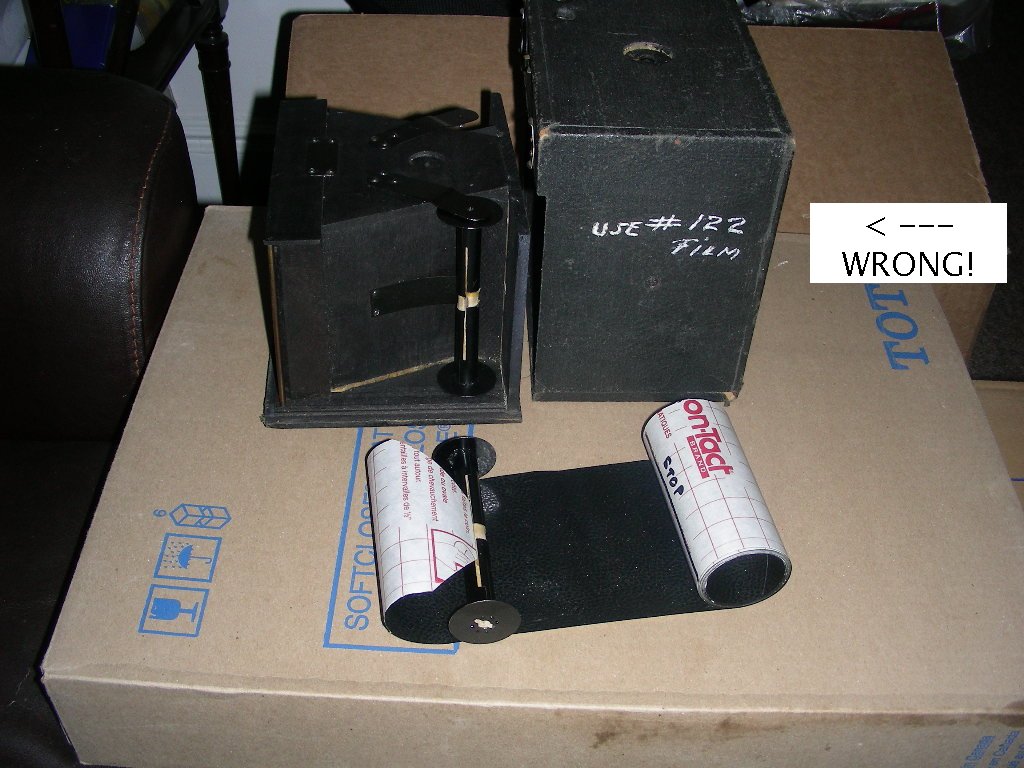

Speaking of modifying spools...
I needed a 125 spool the other day, for a Seneca 3A Box Scout (which despite its name is in fact a 3B). No kidding. Same image size as 122, but wider spool. I'm not looking for adapters per se, as I'd rather shoot the right size film, even if I have to make it myself, than adapt it for 120.
So I did this: I have a few extra 122 (and 118) spools. The wooden ones won't work for this mod, but the metal ones are OK.
I clamped the jigsaw upside down in the vise (instant scroll-saw...) put the thin-metal cutting blade on, and sawed the spool in half.
Then cut a 7/16" dowel, which is the exact ID of the spool (OD is 0.450" nominal), to the appropriate length. Cut a longitudinal slot in the dowel to match the slot in the spool (for this I had an old slotting cutter from a safe-deposit key-cutting machine, which I put in an arbor and chucked in a drill). Drilled round holes in both ends of the dowel, filed a keyslot over one of the holes, shoved the dowel into the two ends of the cut spool, checked the length and glued it in. Voila, a 125 spool...
Mike: The older Patterson reels (the brown plastic ones) have a click-stop for 116, as do other plastic reels from that era. Developing 122 is more problematical, but I found one of those ancient developing tanks with the light proof apron.
