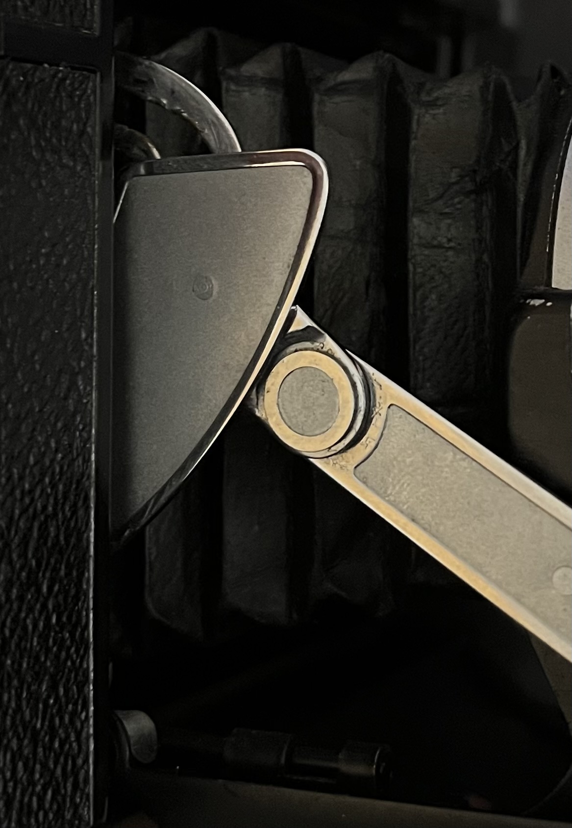

I've identified what seems to at least be the most likely culprit - the right 'arm' doesn't fully extend to a straight position:
You can also see that there's some serious wear in the groove on the upper part of the arm...let's call it the 'humerus.'

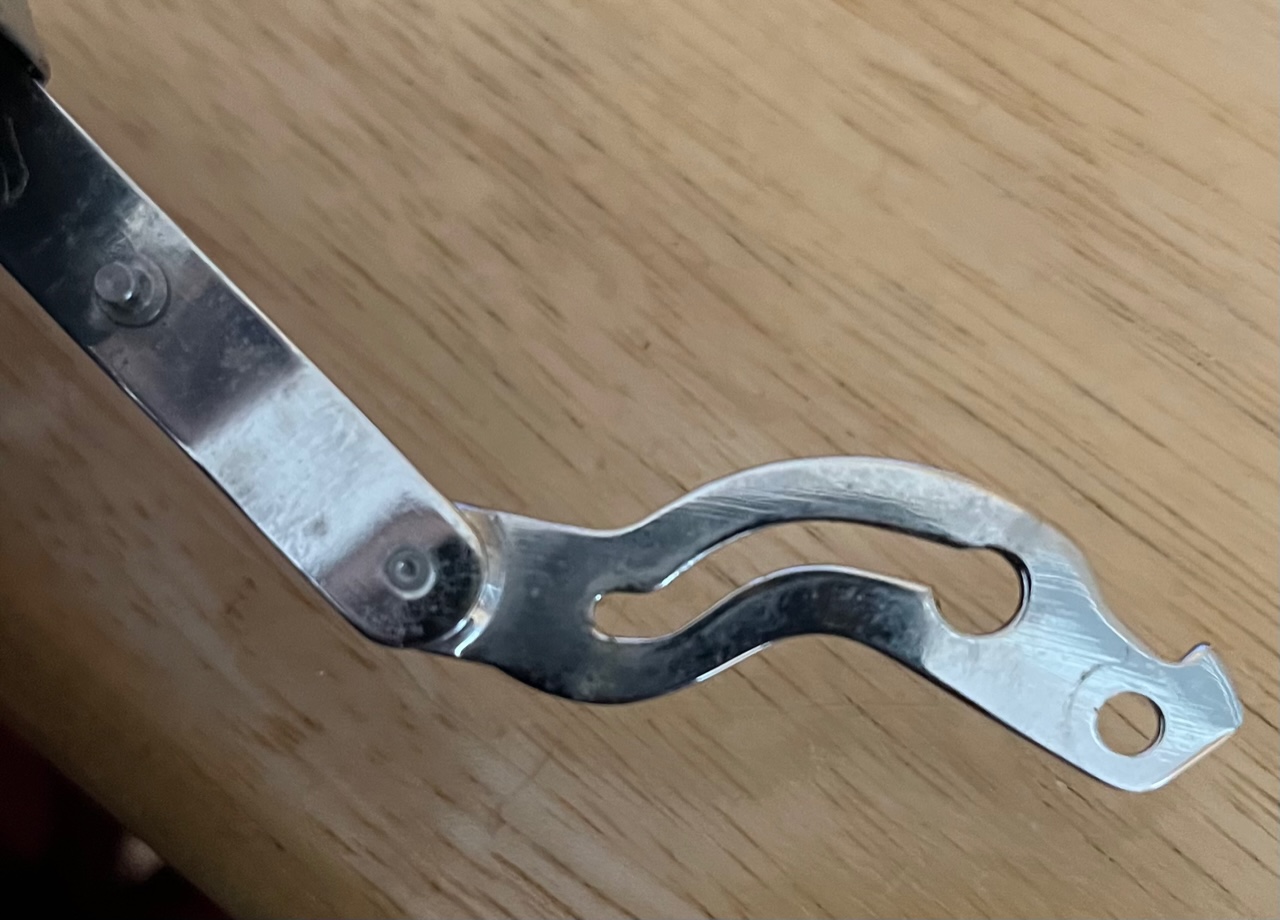

Now, I do have an intact humerus from my old camera (and a radius/ulna that could use some de-bending), but I can remove neither it alone nor the entire arm thanks to the joints being connected by whatever you call those rivet-like fasteners.
Does anyone know of a way to extract those?
nosmok
Jun 11, 2010
682
Any rivet can be extracted by drilling out the center of the small side, or grinding off the top of the large side. I usually go for the former, it's easier. Replacement rivets must be available somewhere (mustn't they?), my guess is you'd go up a size. Or you could turn your own with a lathe... (just spitballing here, I have only taken out riveted arms of folders, never tried to reassemble them)
