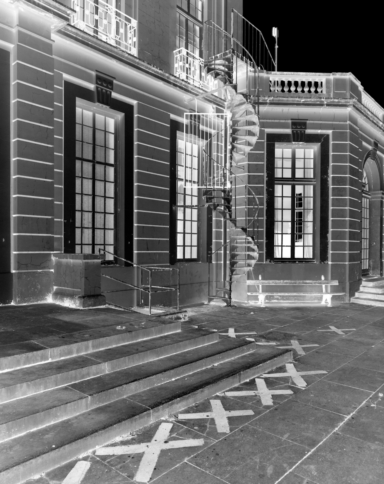

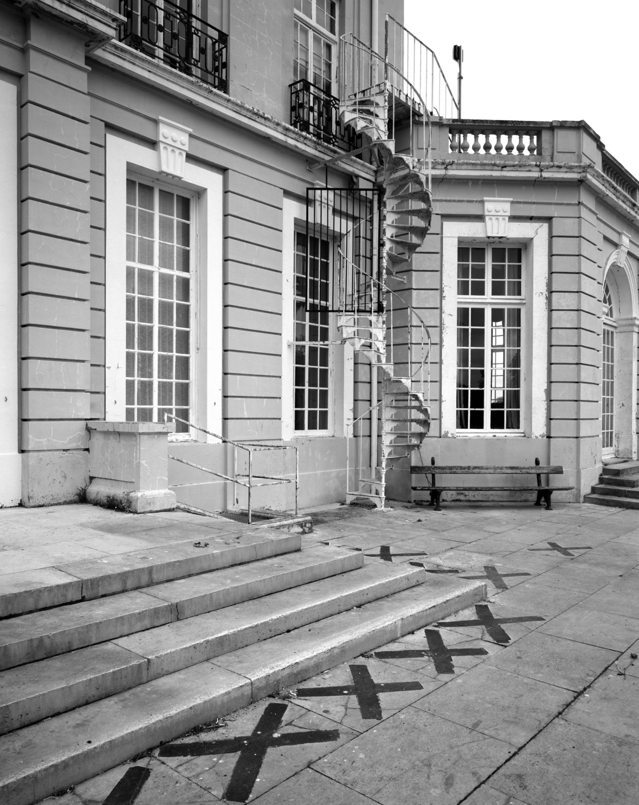

Apart from the sky being blown out because I wanted to focus on getting the window frames white I'm pretty pleased with this negative.
F45 ISO80
Red 23A +1 2/3 stops
Reciprocity +1/3 stop
Zone III to V
N+2 development
-1/2 stop development compensation
1 second exposure
Developed in 44ml of HC110 to 956ml water @ 20 degrees C for 6 minutes 30 seconds.
Stopped in 16ml of Kodak indicator stop bath to 984ml water @ 20 degrees C for 1 minute.
Fixed in 200ml Tmax fixer to 800ml water @ 20 degrees C for 5 minutes.
5 minute running water wash.
Hypo cleared with 200ml Ilford Hypo clear to 800ml water @ 20 degrees C for 3 minutes.
5ml Photo Flo to 995ml water @ 20 degrees C for 1 minute.
Hung to dry for 3 hours.

the N+2 development was probably a bit too much but you can recover that in printing.other than that ,looks like a peppy neg to me.
MJLangdon
Oct 25, 2016
33
Devon
Knowing that the dynamic range of the scene was from zone III to V (V being the white window surrounds) do you think that doing N+1 development and raising the window surrounds to probably zone V 1/2 would of been bright enough for white paint with detail?
Dodging the frames in printing would of been an option but I thought that this would of been too fiddly so opted for burning in the sky as there was no detail in the sky anyway.
I could of composed the image to exclude the sky altogether but someone has smashed a window and it has been boarded up and had a security sign placed on it, didn't want that in my photo :smile:

III to V? That must be excluding the sky, no?
And the white window surrounds as well I would have thought. Even the majority of the building's stone work looks like VI to me.
Is this scene's SBR really only 3 zones?
Just curious and it is largely immaterial to the outcome as a print which I am sure will look fine

Hi Andrew, yes that is the white window surround that was placed on zone V to make sure the shadows were on zone III then I Brightened the white window surrounds by N+2 development otherwise it would of been a really flat looking print or very hard to print.

Yer the main walls are about zone V but from the shadows to the white on the window surrounds it was only 3 zones contrast because it was completely overcast, very flat lighting.
I chose to expose darker and expand the development by two zones to make it a lot higher contrast than it actually was so I wouldn't end up with a flat print or one that is hard to print.

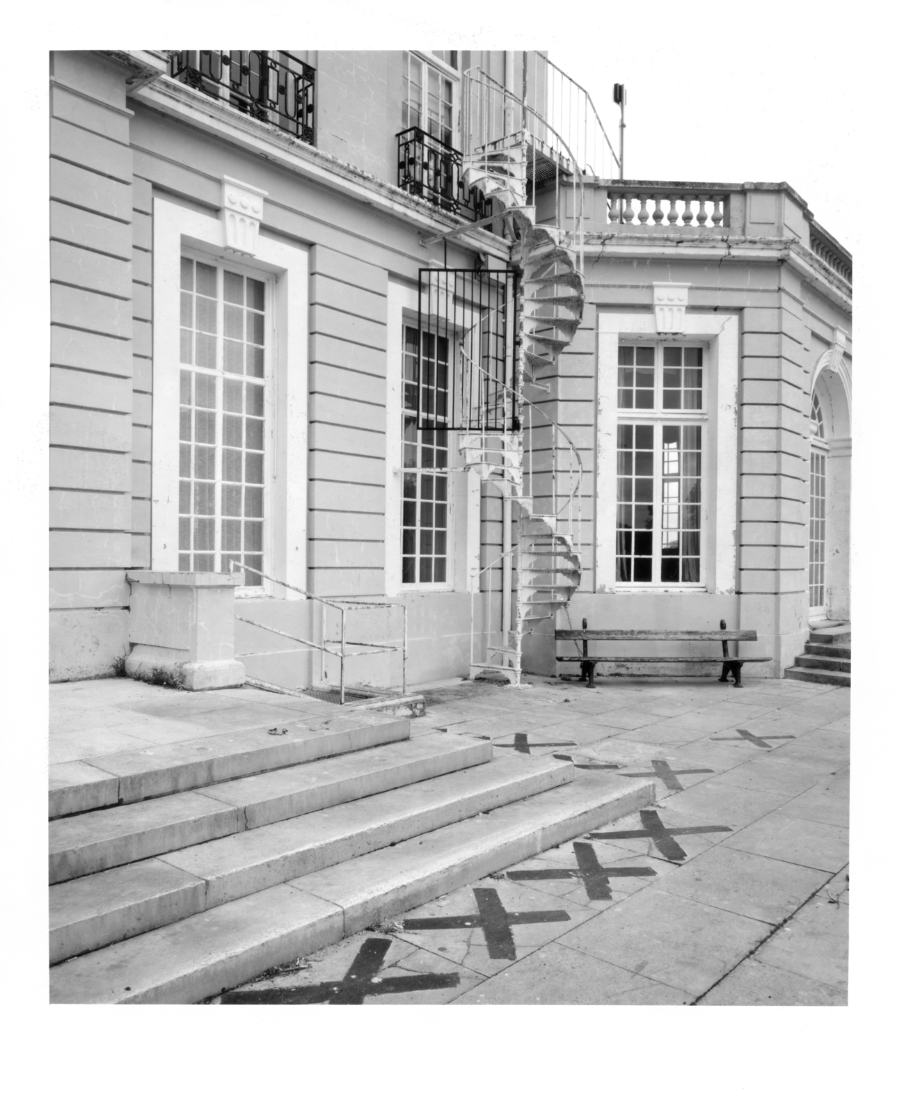

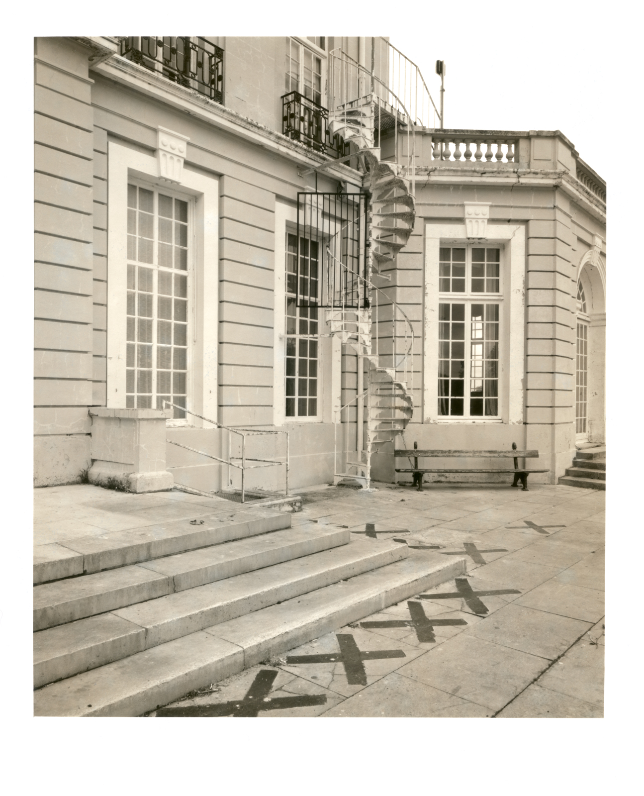

This is the results from a straight print (because I have run out of paper) :sad:
I have Sepia toned this one a bit too much for my liking.
This one is another straight print with a lot less Sepia toning and a slight Selenium tone a little better.
I did have a problem with grey mottling on the back of the paper on this one. Does anyone know what would cause this mottling?
