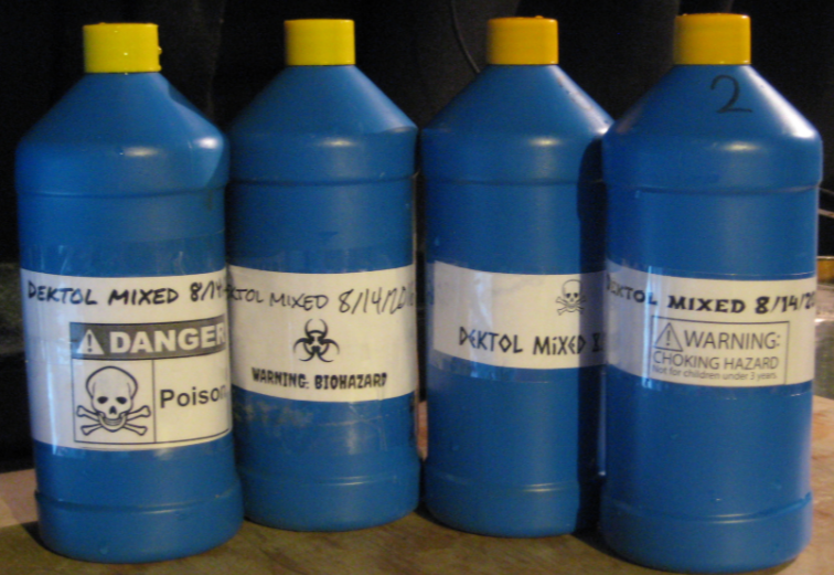

I store my Dektol in blue plastic quart bottles... I let my kids come up with the labels...
