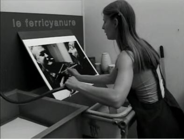

Hose some fresh water on the spot. I saw a great video showing that.

The printer is Nathalie Lopparelli and I can’t find the video. Here is a frame shot...

The printer is Nathalie Lopparelli and I can’t find the video. Here is a frame shot... View attachment 260850
Yep, I've done the hose and reducer and have achieved really impressive control with it - this just needs an overall lightening though, and I've found that even a cotton ball can damage the liquid emulsion (even with hardener in it).
And rigging up to spot-bleach a 30x40 print... guess I could do it outside with a sheet of plywood or something!

I have a 24X28 inch sheet of plate glass semi-upright at one end of the sink. It's ordinarily used as a squeegee surface after final print washing, but is also useful when using a rinse hose in relation to Farmer's Reducer. I have a larger board suitable for 30X40 prints nearby. For overall reduction rather than selective, I use a big tray of water for a quick overall rinse. But reduced prints need to be re-fixed and then thoroughly washed.
