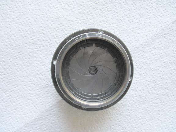

Inspect the blades as you try to move them to be sure they are not getting tangled up with each other. Typically when the aperture adjustment is stiff, the blades tend to bulge and when that happens thye get tangled with each other and ruined.
shutterfinger
shutterfinger
Feb 25, 2013
5,020
San Jose, Ca.

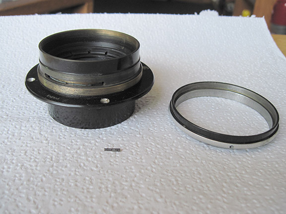

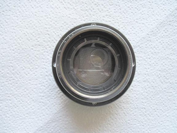

Its currently wide open and stuck in its flange. The owner said he managed to work it there from partial stop down. Front and rear elements remove easily.
I'm well aware the blades buckle and break if forced.
And I got lucky:smile:
After removing the aperture ring set/index screw the aperture ring grudgingly unscrewed from the barrel. Once the ring was off spraying out the slot for the aperture range with CRC Quick Dry Electronic contact cleaner the aperture started moving freely but rough. I dried off the blades then wiped them down with extra fine powdered graphite making sure to get plenty into the pivot pin holes then shook out the excess. The aperture and center element appear to be held in place by a internal retaining ring that will not budge so I could not treat back side as I would like to.
