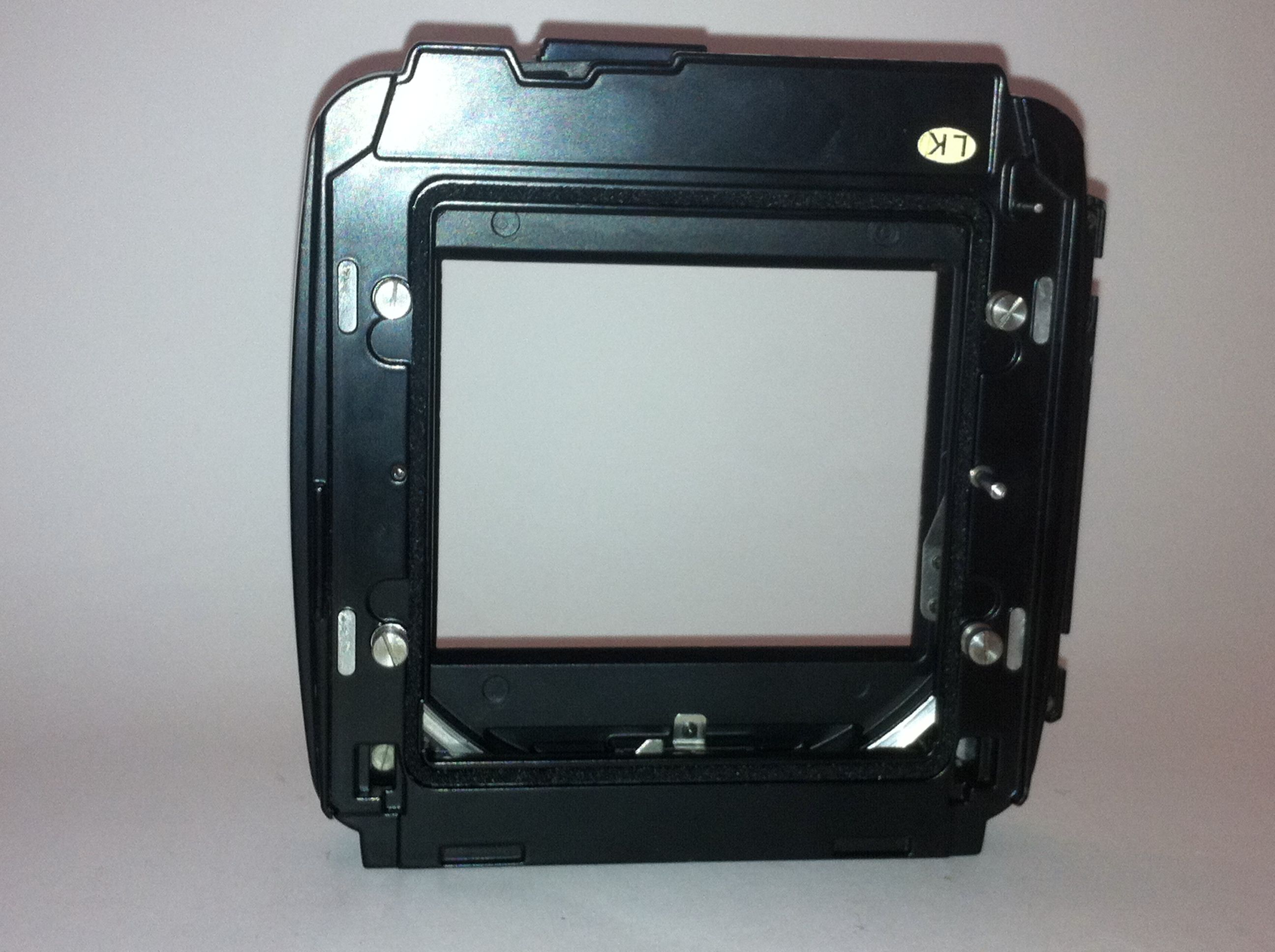

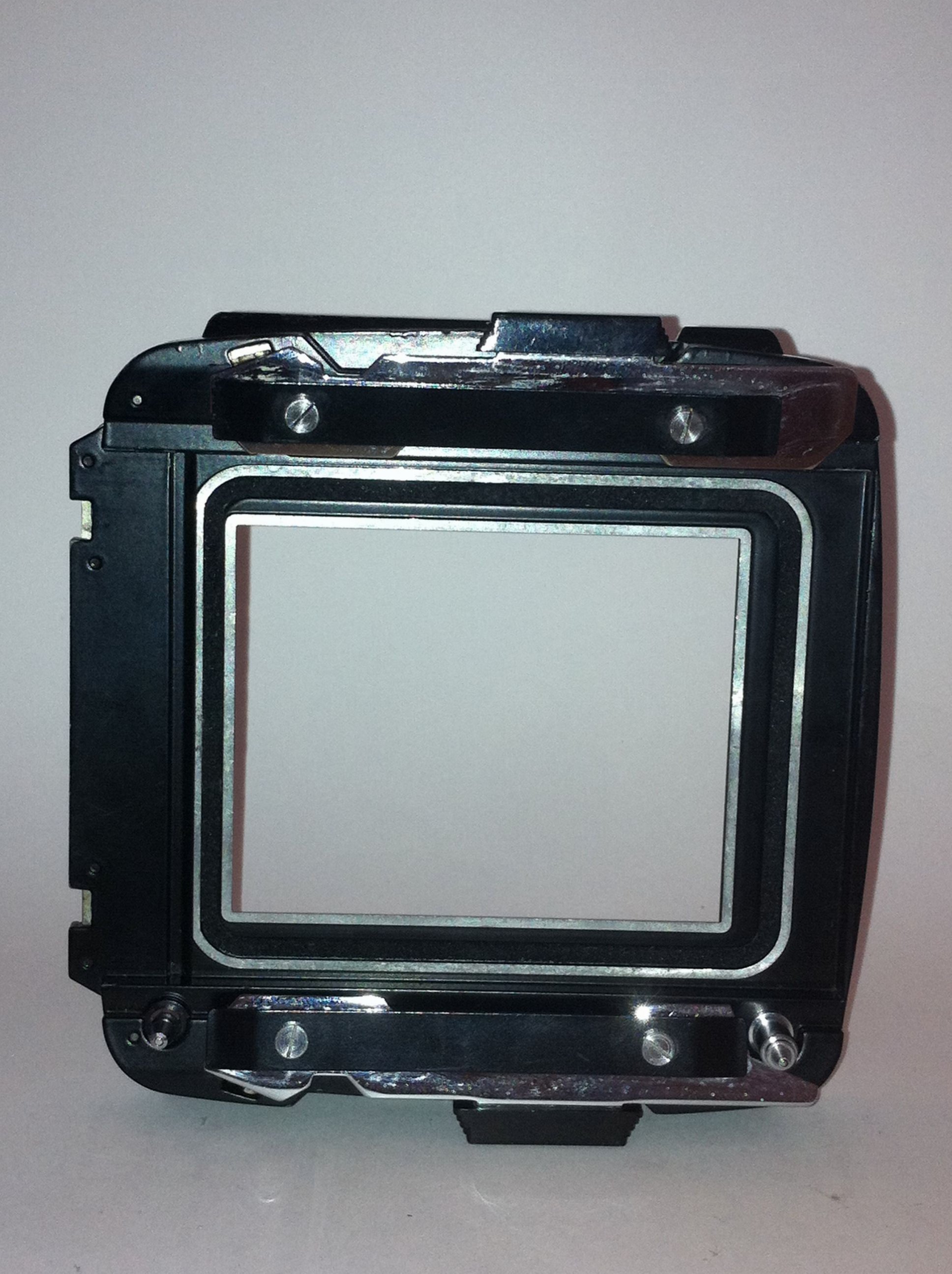

The adaptor comes off the back fine. The Pro S backs on the Pro S adaptor turn fine - I have to put a bit of force into it but nowhere near the amount that I have to for the Pro SD.
Some pictuers of the adaptor:

Can't tell much from your pix--sorry!
You might try contacting via PM "paul ron." He knows a thing or three about Mamiya RBs.
