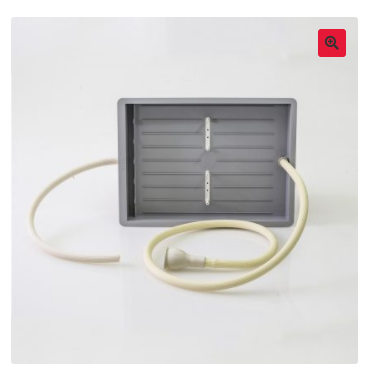

I'll need one of this...

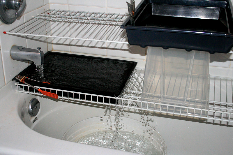

If you can access an old tray, drill a few small holes spaced out diagonally along one side or end and dribble enough water into it to keep the tray mostly full and draining slowly and continuously. If you have that tray draining into another tray, you will have a two stage print washer. For RC prints, one minute in the bottom tray, then one minute in the top tray, and you will have a well washed print.
Like this, except the flow is increased greatly to illustrate the idea:

You can just use that one tray with the holes in the middle, no? I don't understand the bottom clear tray and the black tray at the top.
Thanks!
MattKing
Apr 24, 2005
53,174
Delta, BC Canada
The black nested pair of trays at the very top are my fixer tray :smile:. The fixer is in the inner tray, and the outer tray helps control splashes.
The circular tub/tray at the very bottom (which is actually white) happens to be an old type of large print washer with a convenient drain on it, but a regular tray that overflows at the edge works fine for that purpose.
The advantage of using two trays is that the lower tray accomplishes almost all the washing, while the top tray can be used to finish the very last bit of washing, one print at a time. Sometimes I develop several prints at once, which means that a fair bit of residual fixer gets introduced to the bottom tray when those prints are added to it. That tray does a good job of first rinsing off that fixer and then washing out most of the rest of the fixer in the print emulsion. The top tray than finishes the job.
But yes, if you are careful, the single middle tray with holes in its end can do the job. It definitely works best if you don't introduce too many prints at the same time, and make sure that prints remain submerged and kept moving. If you do that, you can set the water flow to very low.
