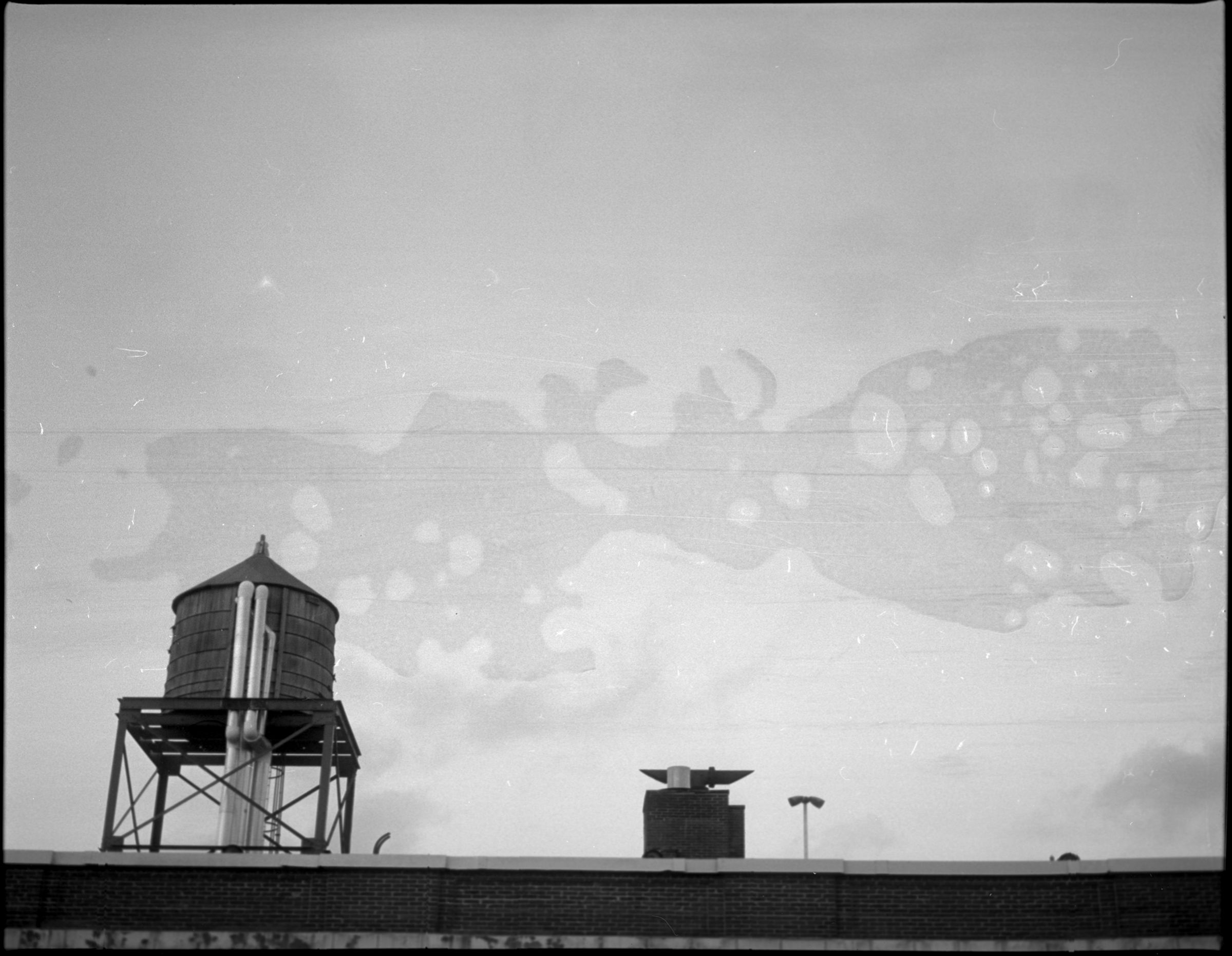

After 2 hours of drying, for the first time my negatives came out sticky. So sticky they wouldn't even go into the archive sleeve, so I tried to dry these negatives with some paper towels (just a test roll so I wiped pretty aggressively which didn't help much besides scratch the picture). However, after scanning I notice a giant blob of damage in the middle of the picture (only this frame out of 10), does anyone have any idea why or how this happened?

Film is handle by edges only.
You need to let it dry bone dry wait 12 hours unless you live in Death Valley or use stop press techniques.
-) density variation due to uneven drying
-) fibers stuck to emulsion
When drying, at least the emulsion side must only be covered with a even film of water and the emulsion side must not be in near distance to obstacles, hampering the drying process.
Two hours of drying? If you live in a humid climate (or it's unseasonably humid for some reason) your film will not be remotely dry.
Patience, Grasshopper, patience!
The rest of the problems are probably due to your handling the negatives before they were dry; lint from the paper towels, emulsion damage from trying to slide a wet negative into a sleeve...
FWIW, I don't think I've ever had negatives dry in two hours.
Doremus
My negatives dry in about an hour in Florida humidity. The trick is to smartly whip the film strip like a snake or whip a few times to throw off excess water. Hang to dry, avoid touching no matter how interesting a frame might look, and in an hour or so, there you go.
That blob is probably the result of sticking the neg into the sleeve while it was still damp.

Two hours is not enough drying time. I usually wait over night or 24 hours.

Change to a different batch of film. If the new/different batch rectifies the problem, then try to repeat/recreate the problem with the old batch. If the problem goes away with the new batch. and the problem can be repeated with the old batch, that's a good point to start your troubleshooting. I've never had sticky film, and never had to dry film more the two hours, even on the most of humid days. I've seen bad batches of "supposedly new film" on a number of occasions. So, sticky film . . . I'm not at all surprised.
