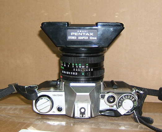

Pentax makes an adapter that fits on most 50mm lenses. The adapter creates two side by side images on a single 35mm neg. I have the prints enlarged at my local drug store to 5x7 and view them on an old wooden steroviewer.
The pentax adapter comes with a viewing device to view 35mm slides made with the adapter. Personally, I like the prints better.
The adapter is pretty expensive new, but used ones show up on that auction site fairly often.

There are a couple out there, but only one that you can buy new; the Loreo stereo lens-in-a-cap. The older Pentax splitter is pretty cool, but goes for a fair chunk of change these days.
- Randy
