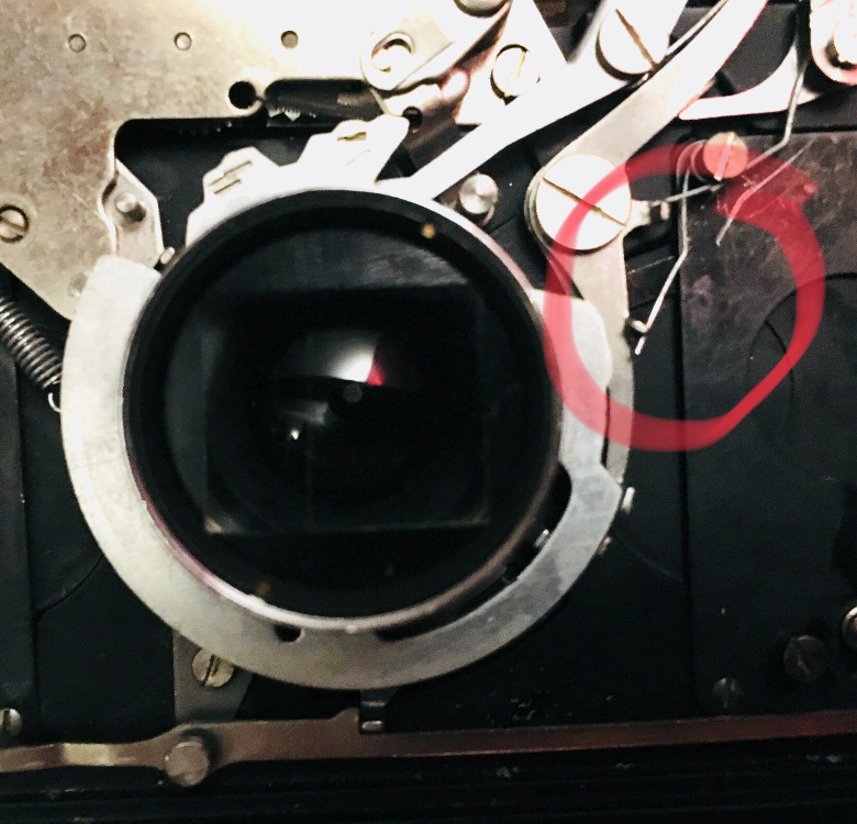

Please, also take a look at the picture of the camera. Perhaps you can find if something is out of place...
This lever appears to be stuck or gummy...
Try flushing the pivot point with naptha or solvent until it freely moves.
It doesn't appear to be swinging down to latch the shutter in firing position and allows it to fire without pressing the release.
This is also a compound lever with more than one moving "leg" on the bottom; make sure they both move freely and the wire springs hold tension on them.

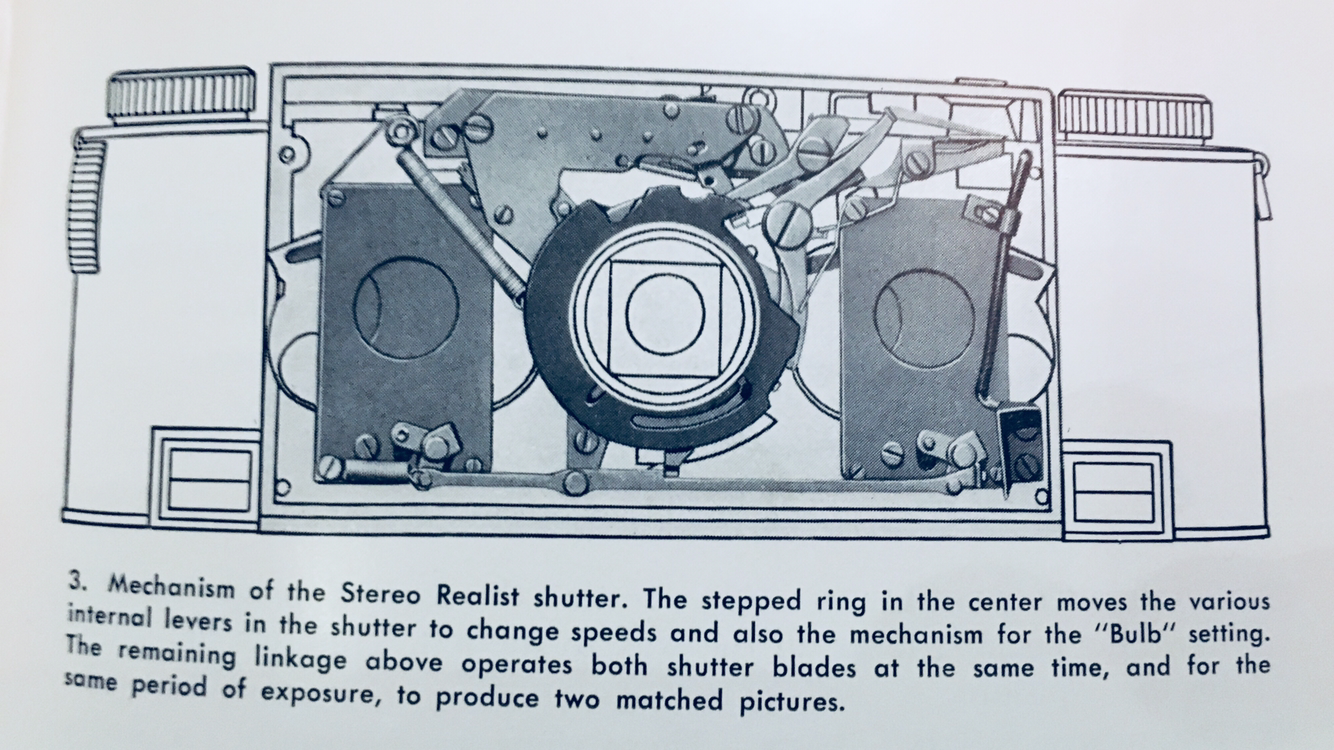

It was a very silly thing. I’ve checked the book “Stereo Realist Manual” and I’ve seen a drawing of the internal parts.

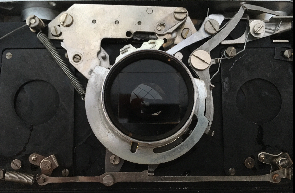

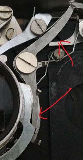

I’ve compared it to my camera and I’ve noticed that the wire that keeps the compound lever in the correct position was stuck between the two “legs”. Now, as you can see in the photo, is in its correct position and working perfectly fine.
