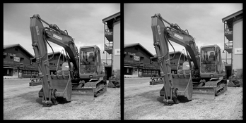

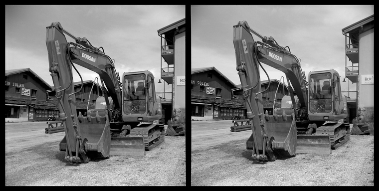

I do stereophotography with a "spoutnik" giving MF(6x6) stereo pairs that can be viewed cross-eyed as they are.
When you want to view them parallel, you first have to swap them left to right right to left. Besides, I find cross-eyed viewving easier because it's what you do naturally when looking at something at close distance.
Here a document where I present my experience with the spoutnik (in french), and an example for cross-eyed viewing

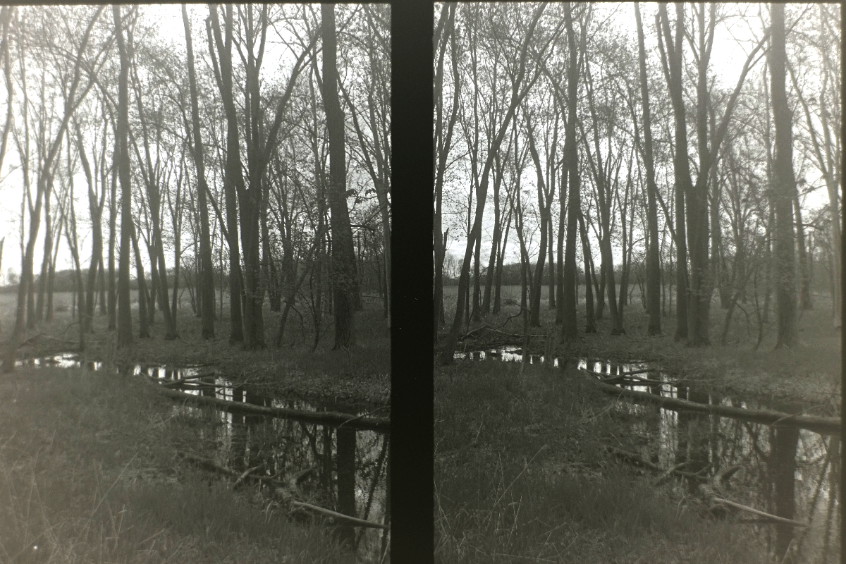

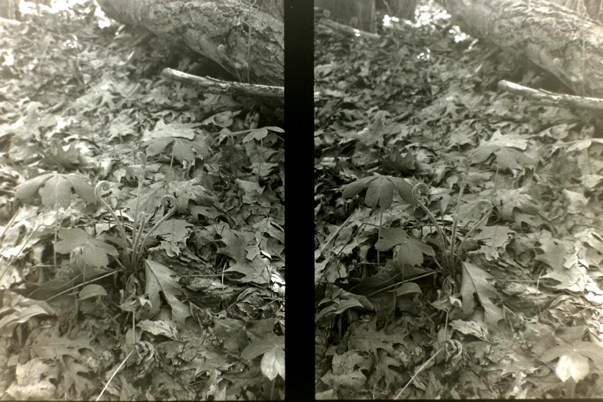

Here are two recent stereo pairs of mine, taken as successive images with an Olympus Pen FT. I take one picture, then shift right about 6"-8" and take a second picture, with both centered on the same point. I view them with the lorgnette from my old copy of the Stereo Realist book or with a plastic Lietz air photo viewer.
These images are digital rephotographs of the BW negatives, inverted and gamma/contrast adjusted in Microsoft Photo Editor.
