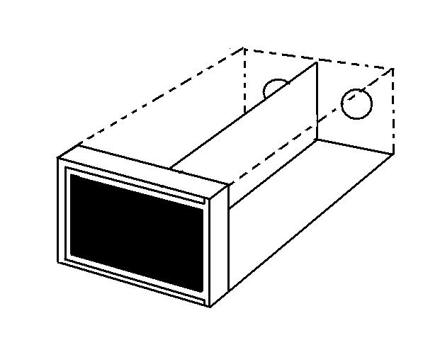

there is one thing I just thought of, how will the front tilt over or under the "wall" separating the 2 images... I don't fancy making 2 bellows
johnielvis
May 21, 2010
966
2 bellows is the cadillac way--OR you can just put in a septum divider toward the back--the divider only has to be big enough where one of the 2 views doesn't "see" the other lens--or, should I say--the light from the other lens--if it sees the lens but there's no coverage (vignettted) then it's not a problem---size the back divider based on the closest focus distance--anything closer will have the lens closer into the divider and provide ample "shading" is guaranteed...
draw it out on a piece of paper and you shall see.....
