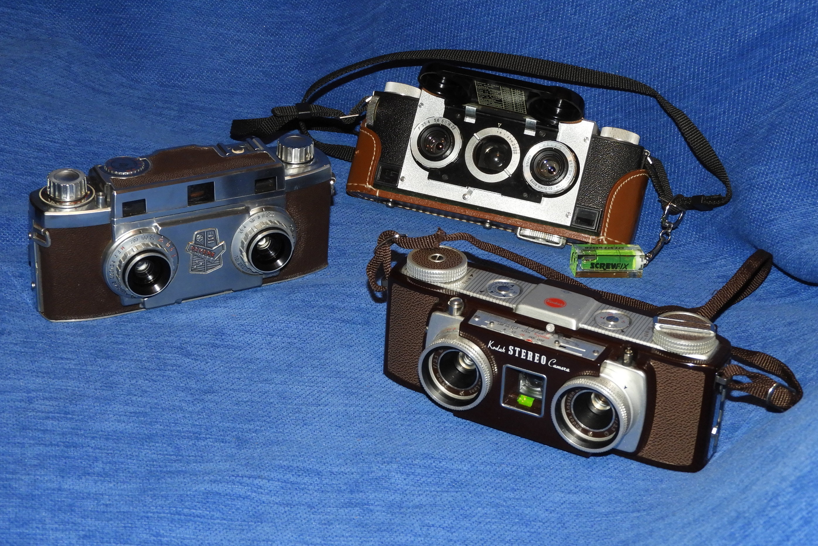

I have a Realist, Revere and Kodak. The Kodak is probably the most fragile of the three, the body being made of Bakelite or a similar plastic, but presumably Kodak realised that for the amount of use it would be likely to see, the money invested would be far better spent on the optics than on the body/mechanics and as has been said above the lens is regarded as being at least the equal of the other two. Like the Revere, it has a level, which is essential for effective results. It also has by far the best film rewind of the three.
I generally print stereo pairs for use in a Holmes viewer, but sometimes take transparencies and mount them for use in a Revere viewer. (Mounting for use in a projector is another matter altogether according to what I've read). I've also experimented with tinting , which all adds to the fun!
