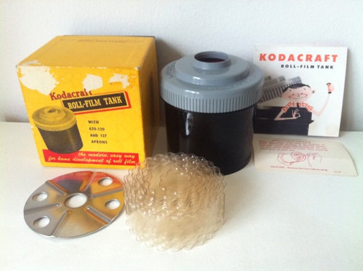

Found it, this is what I first used. Had not thought about this in a long time.

I did learn on an unusual device a crinkeled long plastic ribbon thing you would roll up into a coil with the film inside the role as you coiled it up. Might have been a Kodak product, my father had it, a Kodacraft tank?
Correct! And they came in a bunch of sizes, including for 116/616 film.
Freestyle was still selling replacement aprons when I last checked. I still use them from time to time.
But typically I use both Steel Reels and Plastic Reels. The AP (work in Paterson tanks) Plastic Reels work best with 120 for me, while I can use either Plastic or Steel with 35mm film.
