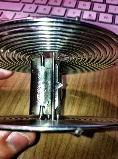

the biggest problem, is that I gave away one of my best reels to a friend just starting out...so all I had left was the 35mm steel reel without the wire spring at the middle. This other brand is vintage made in Germany "K" brand. I sort of never figured out how to load them, I forgot to look at the middle and threw everything into a changing bag, so I was trying to get it to work without ever having figured it out... I was in a hurry.. lots to do today. normally I can get everything done in 25 minutes or so from load to hanging it to dry. I am normally a Medium Format guy, so I was sitting there contemplating the craziness of 36 shots on a roll, while I was trying to figure out by feel how to load this style 35mm steel cage. I am so use to between 8-12 shots max on MF. I think back to when I use to do digital, and had 200+ shots on a card. that was nuts..:laugh:

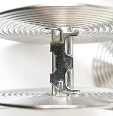

Get a Hewes reel. The film lead attaches with the perforations. Grip and centring are a breeze.

I got mine off e-Bay. Not as many auctions for them as the reels with the springs, so you will have to be patient. Also, you can expect to pay more for a Hewes reel, unless there is little interest in the auction. B&H in New York sells them, but the newer model uses a spring! You might try APUG's Classifieds/Want to Buy.

Are you adept yet? I can use the vintage K with my butt cheeks...if you want to trade back the reels...I'm game.

Hewes are indeed great, but you need an 18 ounce Nikkor tank to use two at once, they don't fit together in the 15 ounce tank. But, a completely straight Nikor reel is really no trouble either, but it has to be completely straight. It does take the right "touch" however.
