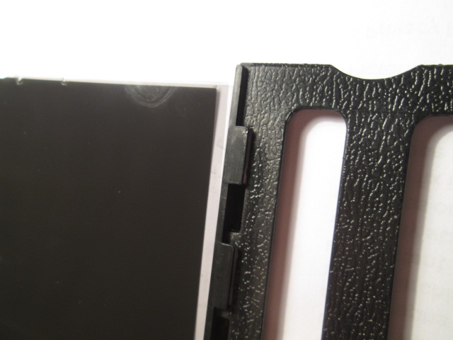

This is the first time I have used my Stearman Press 4x5 tank, and I am wondering if I am doing something wrong.
A sheet of film exposed and developed for a highlight test came out well, but has what look like water marks on the negative glossy side corresponding to the finger notch on the film holder.
Apart from the mark I am very pleased with the ease of use and low volume of chemicals required. A good tank indeed.
Thanks in advance for any ideas.
p.s. the two marks along the top edge of the negative on the left are pin holes from the film drying clips.

That spot looks like a thumbprint to me; a place where the film was grasped with a finger, leaving a greasy mark. Most of the time, such marks don't affect scans or prints, so unless you see evident signs of it in your final images, I'd not worry about it.

The only way the holder could impact development is if you put the negative backwards, i.e., emulsion side down rather than upward.

Thank you gents.
The mark originally looked like dried froth on the film.
After a good look with a magnifier it is definitely a fingerprint.
I have developed another sheet of film since, but this time freed it from the holder using a pair of tweezers.
All fine this time.

Great, thanks for confirming! I often get a print along the edge of my sheet film. Most of the time it's not a problem, so I shrug and move on.
