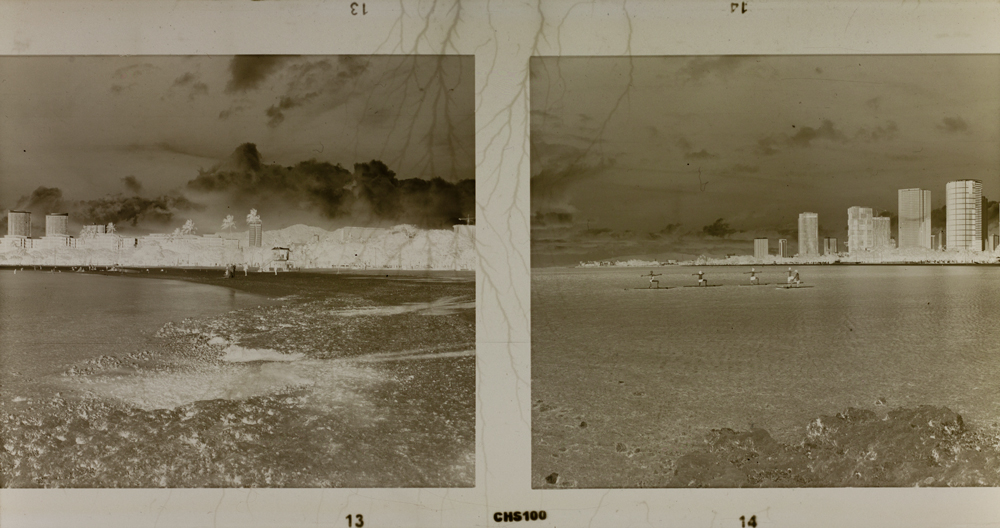

One upside of a ruined negative is that it can make a useful post on Photrio. I couldn't turn up another thread on this topic, though I'm sure there must be examples buried in some thread with a title like "What's this stuff on my negs?"
This is about the clearest example I've seen of static discharge on the negative, occurring most likely in the camera. I'd have thought I was immune from this problem in our relatively humid subtropical climate, particularly when shooting right on the beach, but we've been having some unusually cool weather, and maybe it's reduced the humidity in the air.
It's between the last two frames, so it's unlikely to have happened before the film was loaded or to be the result of triboluminescence from the tape attaching the film to the backing paper, which is at the other end of the roll.
The camera is a medium format Noblex 150 that shoots a 60x120mm panoramic image, so presumably the static is from the rotating drum, which is a known issue with these cameras, just not a problem I've experienced before. The film is Adox CHS 100, developed in ABC pyro 1+1+1+12.
And, yeah, those people out there on the water are doing yoga on paddleboards.

The camera is a medium format Noblex 150, so presumably the static is from the rotating drum, which is a known issue with these cameras,
Interesting. Never heard that before
Is the drum from plastic?
(But it does not touch the film anyway, the films rest agains guides that make part of the body. Material?)

The camera is a medium format Noblex 150 that shoots a 2.25x5" panoramic image, so presumably the static is from the rotating drum, which is a known issue with these cameras, just not an problem I've experienced before. The film is Adox CHS 100, developed in ABC pyro 1+1+1+12.

Indeed power rewind can be an issue with 35mm film, but this example is with 120 film, so there is no rewind, and the film advance is knob wind, so not particularly fast.
The Noblex 150 is a swing-lens camera like the Widelux. The film plane is semicircular, and there is a drum made of plastic and metal materials that spins the lens and shutter assembly to project the image through a slit that passes over the film. The drum takes a half revolution to get up to speed and then exposes the film while the lens faces the front of the camera. My guess is that the spinning drum is the source of the static.

Interesting that the solution seems to be to switch films, unless I want to carry a grounding rod along with my tripod with a wire running up to the tripod screw. Hammering the rod 8 feet into the earth before every shot could get a little cumbersome, eh? So I’ll save Adox for other uses, and take my stash of Agfa APX 100 out of the freezer for the Noblex. And when that runs out, I guess I’ll either go Tri-X or maybe FP4+. Ilford has a patent for an anti-static coating from 1972. Anyone know for sure whether Ilford film has an anti-static coating?

Possible, but might be too much to worry about for what so far has been a pretty rare phenomenon. As long as there are films that I like that use antistatic coatings, I think that's the best option.
One thing I wonder about is that when I last had the camera overhauled, Noblex Canada replaced the roller that transfers the motion of the DC motor to the drum with one made out of a new material that should last longer than the original part, which tended to deteriorate over time and splatter decomposed rubber bits around the camera's drive train. Maybe this new material is more prone to static buildup. Even if it is, I'd rather have the more durable part and figure out another solution for the static issue, since the cameras are out of production, and repair services and parts will become harder to come by over time.
Could be. I don't know what the guts of the camera are like, perhaps it is acting in the manner of a small scale Van de Graaff generator? Metal parts can hold a charge for a while if there's no obvious way for it to bleed off. Presumably it could discharge to the film if they get close together.
If this is really a camera issue, the service center has probably been getting intermittent reports or questions; it may be worth touching base with them. I've chased down a number of static problems on film and it can seem a bit like black magic until you sort of learn how it works. You might play with some dummy film in the light, running through the camera and then see if the film attracts dust (if something else discharges to the film, then the film itself will be charged, at least for a short time). I think you'd be better off to touch base with the repair center first (don't ask for a conclusive answer, just whether or not they've been getting any calls asking about it). Best of luck.
