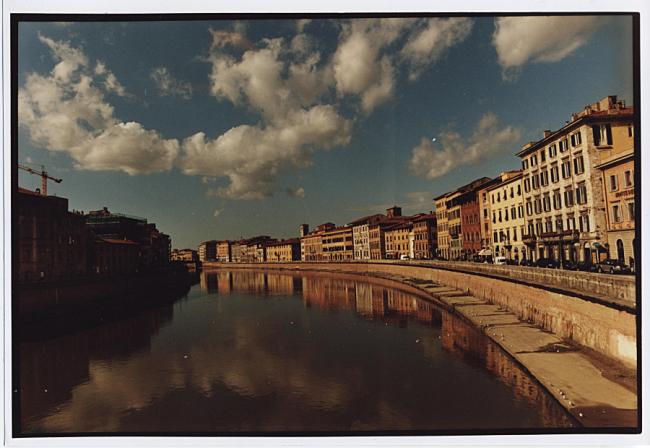

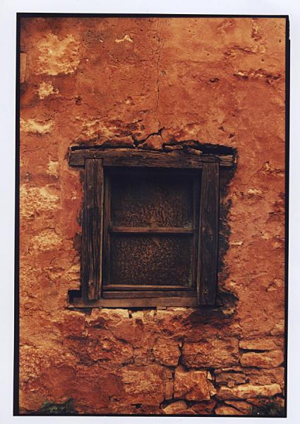

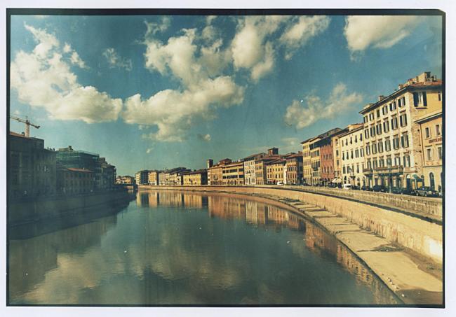

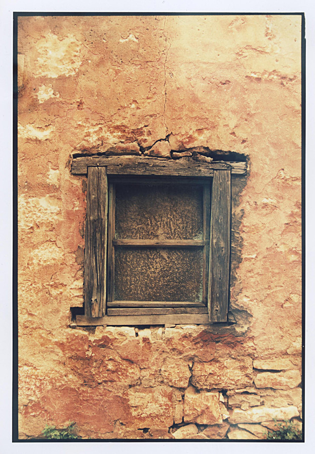

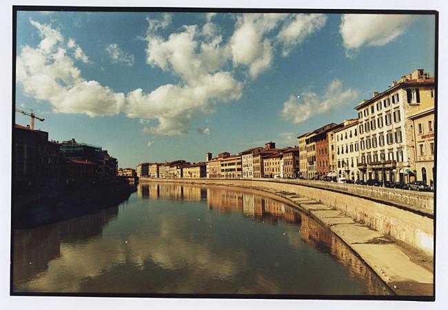

So I have done it. It was not so hard, but of course I see that it takes practice to get nice results. What was different in comparing to B&W:
- short exposure time: 3-6 sec @f8 or f11. So no place to dodging and burning.
- every new frame must have test clips: on B&W frames from same film with same lighting are more less same exposure time. Here is not the case.
- to get nice color balance on portrait is very very hard - wasted 5 papers to get it ok, but not ok enough, so I give up for the first time.
- working in dark is not a big problem for small paper size.
Regards,
