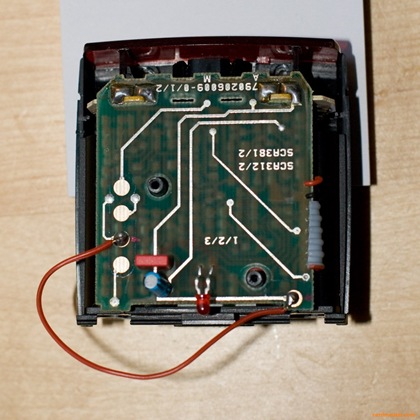

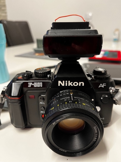

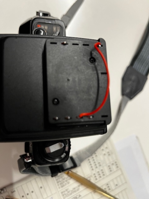

Ok. With the F-501 it is working standalone without flash.
At first try i did not set the AF switch.
Now it works.
If i push the shutter half way i get a nice red barcode on the wall which the camera can focus on.
I did not want to open the SCA so i attached the cable to the SCA contacts just pinch it into the spring contacts.

Tomorrow i will try my F3AF and AS-17 with this AF-light.
F-501 can lock focus with this one - even in light conditions when focussing normally is not possible.
Never the less i will modify the SCA for use with the F-501, using a SCA300A cable, remove the cable and add a small switch instead.
