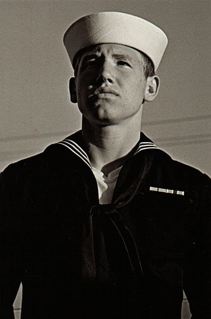

Alan, here's a crop from a 35mm shot done with Efke 100, pyrocat-hd and minimal agitation. The crop is from a 5x7 print, which was actually only about 1/2 of the film's area in the enlargement. The edge effects can be clearly seen at areas of higher contrast. This was done with a dilution of 1:1:150 and a rest of 3 minutes between agitation cycles. It seems to be the most edge I have in a print, which shows the effects of slow development on this film. In a larger format, this edge would not be so pronounced, due to the smaller enlargement factor. The sharpness is still quite evident when using minimal agitation or stand development in larger formats. Shadows are much better detailed and sharper than those in a normal agitation scheme and overall tonality is better than anything else I have developed. Thanks again Sandy. Best, tim

Excuse me for acting the Devil's advocate, but I would like to see the other side of the sailor. It looks somewhat like rim lighting to me, partly because the width of the line varies more with position than with density difference. It certianly adds to the 3-D effect whichever it is. A better test, I think, would be a dark-light boundary on a flat surface where light cannot come from behind the test surface. In other words, are you sure you would NOT see the same visual effect looking directly at the original scene?

" In other words, are you sure you would NOT see the same visual effect looking directly at the original scene?" pat
A fair question pat, but here is another copy. I looked for the same print, but only found a warm tone version, so hopefully it will suffice for the sake of argument. The only way to "see" this image as it was taken and then printed, would be to use a pair of 3-D glasses or perhaps a few micrograms of LSD (not sure about magic mushrooms, but the jury is still out on that one). A rim lighting effect could have contributed to the edge effects here, but since the light is from the front / right, I don't think it is the light but film and developer combination which is showing an edge. Take a look at the lower portions of both arms against the wall, the edge effect is still there on both sides. The trade off, in this case, seems to be with enlarged grain (clumping, as it were) due to protracted development.

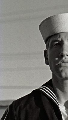

Second image was a TX400 shot with semi-stand development and pyrocat. Twice the time with very little edge effect, but it is a 6x6 shot, so enlargement isn't really a fair comparison. Best, tim
P.S. The kid in the pictures is my son in his "Sea cadets" uniform last fall. He has since joined the Army and will ship out to Iraq in March. Second shot was of him on leave last month. There are still some decent kids out there.
My question really was whether or not the light coming from the front and side was reflecting off some part of the wall behind, thus increasing the edge effect.

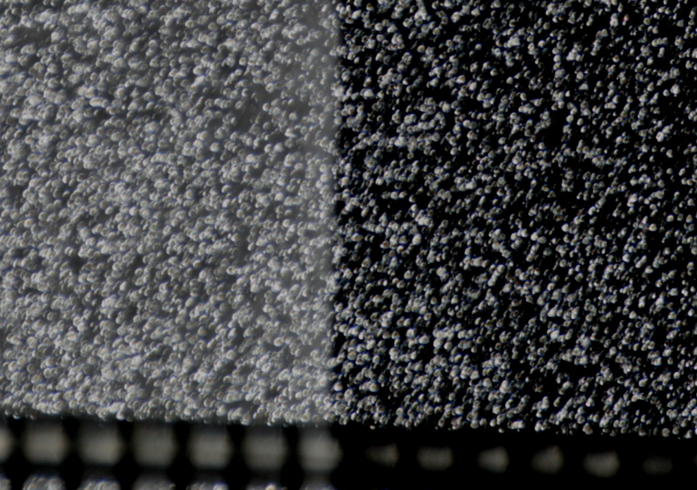

Here is a magnified picture of a gray card on a black card,originally printed enlarged x10. Plus-X,Pyrocat HD semi stand 50min 68F. The scale at the bottom has 1mm small divisions.
There is a light line on the gray card at the edge by the black card about 1mm wide.

Alan, interesting shot above. Would be curious to see the same thing with your other films. Nice way of showing the difference. tim

Still not quite convinced this one is not an optical illusion. When I hold a white card against the screen and move it to where it just obscures the darker area, I could not see a definite white line. There is enough randomness in the image on both sides to obscure it to me. Maybe I'm not looking at it right. I'll have to try it myself with various developers to see if I can see it
Is the texture the surface of the cards or is it grain?
