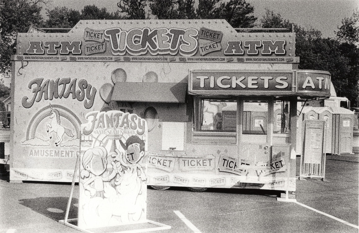

Here is 35mm Pyrocat-HD semistand:

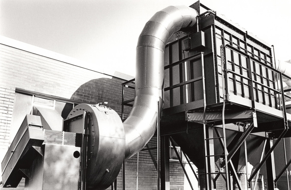

Here is 35mm in very highly dilute D-23 semistand:
Here is that same highly-dilute D-23 semistand with a 9x12cm negative - as you can see, the larger negative makes grain a non-issue:

The bright areas seem too light. How did you print this?
It's impossible to tell without calibrating our monitors so they match.
On both of my monitors - one an ordinary display, the other one a multi-billion color monitor with an Nvidia driver card - the highlights in all those images show proper detail.
There is also a certain amount of taste in how I printed them (mine might not match yours). You can play around with your monitor brightness to see if you find something you like better.
These are scans of workbook silver prints on a very poor scanner, which may also contribute to this.
This is the curse of the internet and trying to do image comparisons.
I have to agree with @Augustus Caesar here. You've got a lot of blown out highlights in especially the first two images and I can't quite believe that they're "artistic intent". For instance, the roofline left to the vent in the first image is lost against the sky; if you sample the colors, they're all 254-255, so there's actually no separation there.
I suspect this is the problem, really. It also explains the light edges. Scanning prints tends to be a frustrating chore. If I need a decent reproduction of a print, I'll put the scanner aside and photograph the prints instead.
Yes, I'll have to try doing something different because the originals do show more detail. I may have to bite the bullet and buy a decent scanner.
I do think some of this is monitor calibration, though. On my monitor, the roofline the left of the vent clearly shows some slight separation. In the second image, the foreground sign shows just a hint of detail.
I suspect if I went back and reprinted I could bring both down and increase the available separation and detail.
I do have a more than capable digital camera, but I've never figured out how to hold either a print or piece of film flat to be able to use it for "scanning". Suggestions more than welcome.
