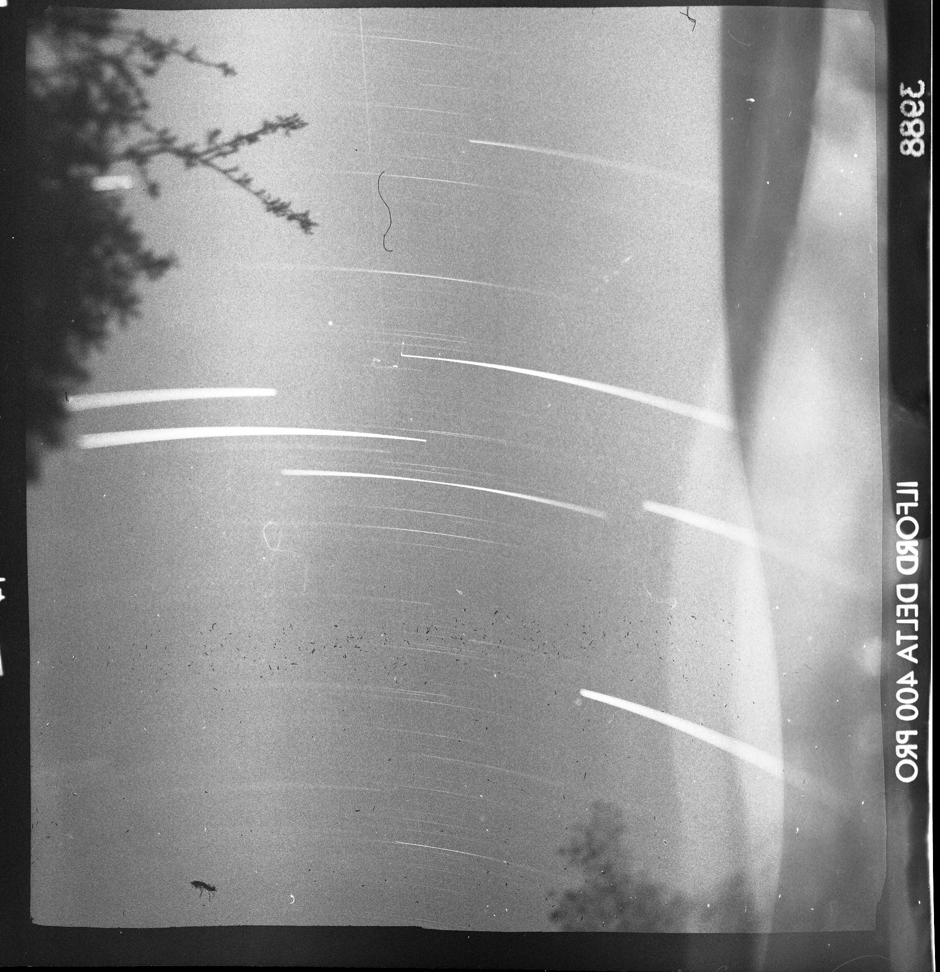

There has appeared an area darker than the rest, after an hour of development in rodinal 1:100 at 20 degrees, agitated (inversion) for the first 30 seconds then for 10 seconds on the 20/40/50 minute (stopped: 20seconds, fix: 2 minutes), the negative developed well and mostly uniform except this one area about 1cm right along the one edge of the film.
is this caused by developer sinking to the bottom of the tank, or not enough fixing, stopping, developing?

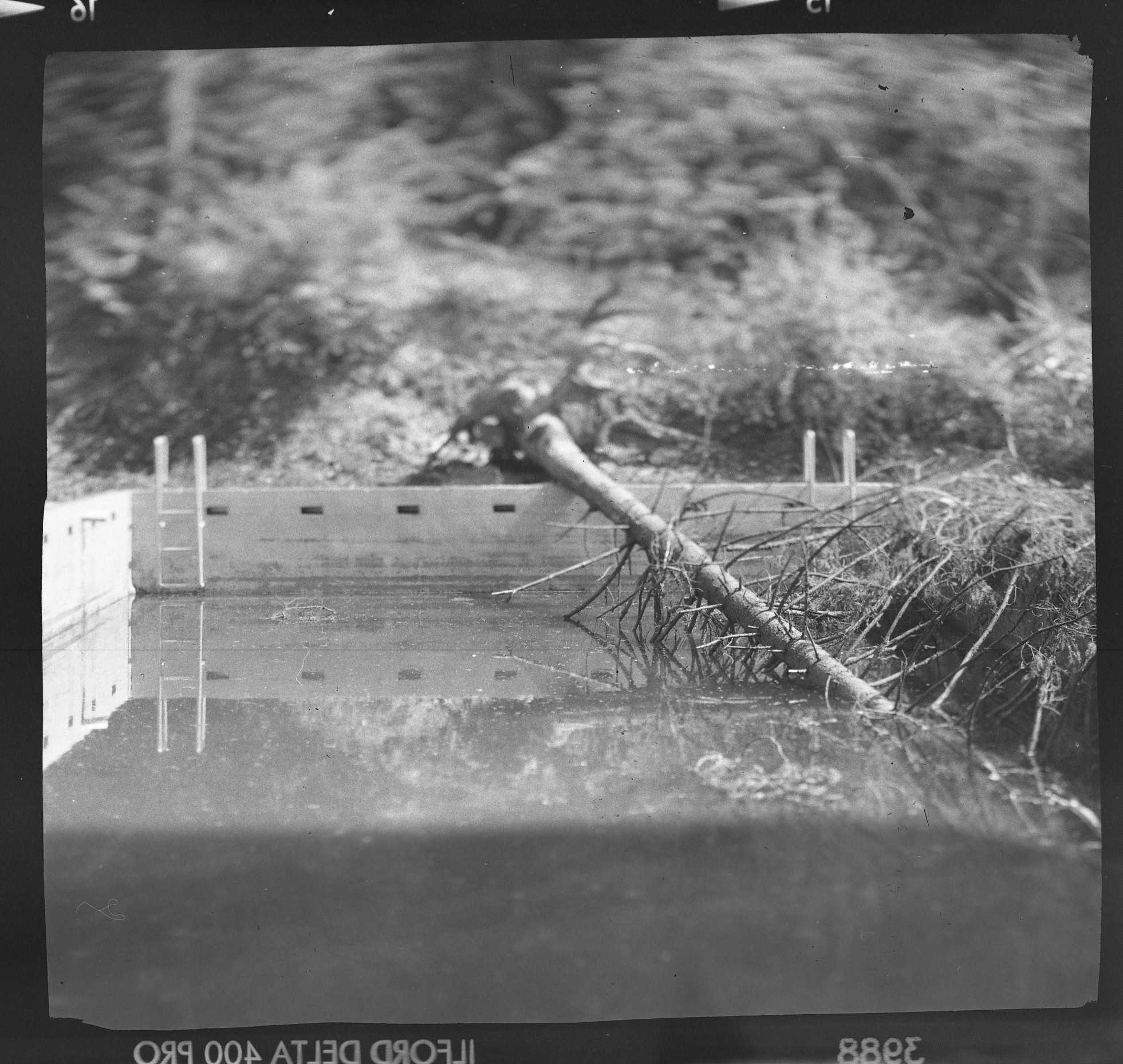

I've attached a scan of one frame for everyone to have peak at, some are more prominent than others and on one frame looks like waves (too much agitation)... so I'll stick that one up too.
thanks in advance
I did, but the reel may be sticking on inversion... still should be submerged tho'
Are they plastic or stainless reels? What size film? I've had plastic reels with 35mm film try to float or hang up in the tank. It does look like you did not get developer for the full time.

plastic reels and 120 film.
looks like I could do with something to hold the reel at the bottom of the tank.
**looks like I'm actually missing a part of my tank.
If you have excess space above the reel (or reels) you can cut a piece of pvc pipe of the right diameter to fit over the core tube. You want to cut it just long enough to clear the top so that when you close the tank, the pipe will keep the reel on the bottom and leave a little clearance from the top of the pipe to the underside of the tank lid.
