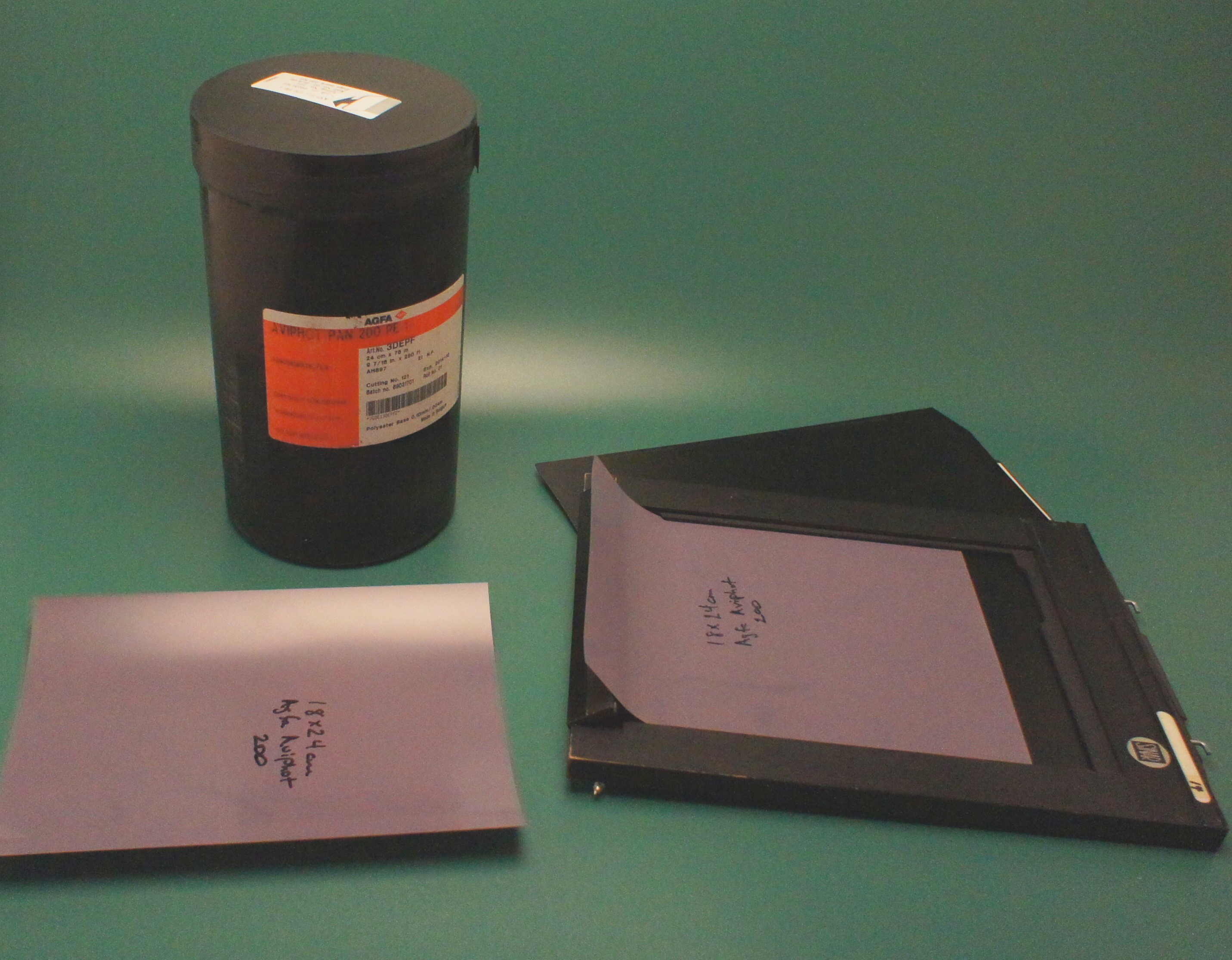

My intention with MinR is to make 18x24cm contact prints with a nice black border, on 8x10 paper.
SONY DSC by Nokton48, on Flickr
Here I'm contemplating cutting this it's just one cut. Jim Galli is a very helpful friendly Guy here, he showed me his cutting procedure in the dark

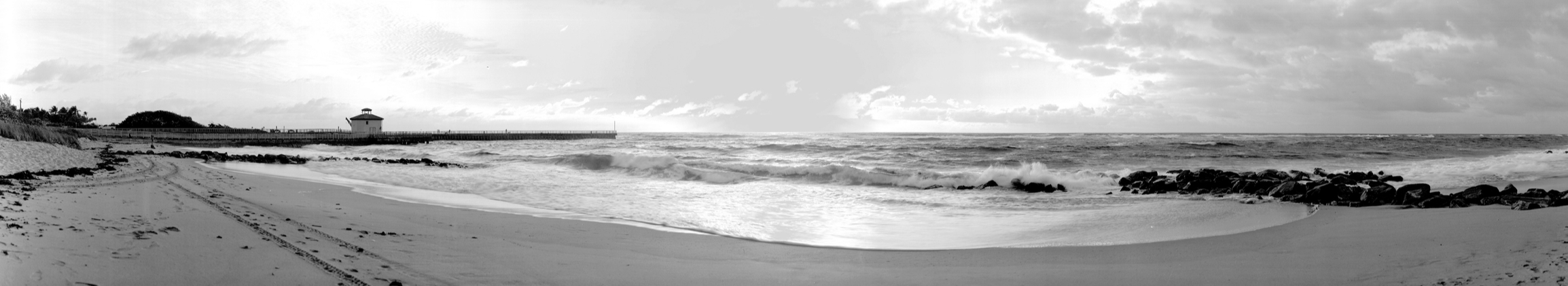

I don’t know if this example is helpful, but this is a Cirkut panorama shot straight into the sunrise at Boynton Beach, Florida on Aviphot Pan 200 (PE1, expired 2014). I rated it around 100. BTZS-style rotary development for about 10 minutes in HC-110 dilution B. The range of tones measured around 1.6 on my densitometer from the sun and brightest clouds to the shadows among the rocks.

I don’t know if this example is helpful, but this is a Cirkut panorama shot straight into the sunrise at Boynton Beach, Florida on Aviphot Pan 200 (PE1) from 2014. I rated it around 100. BTZS-style rotary development for about 10 minutes in HC-110 dilution B. The range of tones measured around 1.6 on my densitometer from the sun and brightest clouds to the shadows among the rocks.
View attachment 371687View attachment 371688
Now thats an impressive piece of negative.
That's Wonderful! Impressive and Artistic

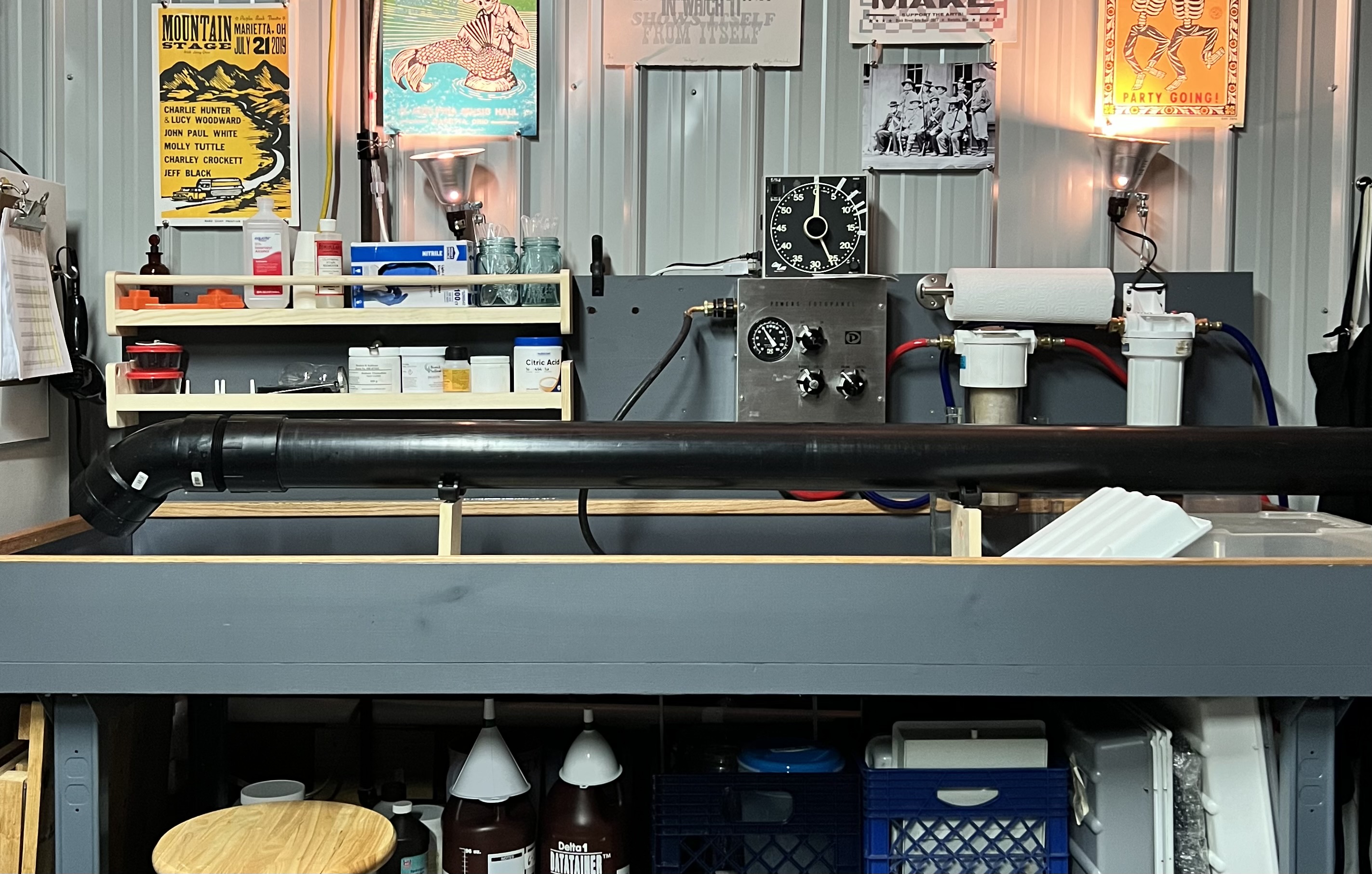

BTZS is new to me, I have a Cirkut camera and would find it useful. What size tubes did you use. Can you give me some advice, I am in the UK. Thanks in advance.
Hi Jeff. There are other threads here that plumb the depths of Beyond the Zone System. It has its adherents and detractors, Phil Davis’ book on the subject is definitely worth a read.
Since the Aviphot is expired and being used for terrestrial photography, rather than aerial, I found it helpful to run the series of film tests referenced in BTZS to get a handle on the film characteristics. Photography with the Cirkut uses a lot of film and developer, so I wanted to minimize waste from trial-and-error. Lately, I’ve tended to rate it at 64 in the Cirkut.
I use a 72” length of 4” black ABS plumbing pipe. I use threaded caps on the ends. One end has a 45-degree elbow to aid in pouring chemistry in and out. I made a roller base out of lumber and casters. Photo attached of the contraption sitting in the sink. The negative is carefully rolled lengthwise and inserted so the emulsion side is facing inward.

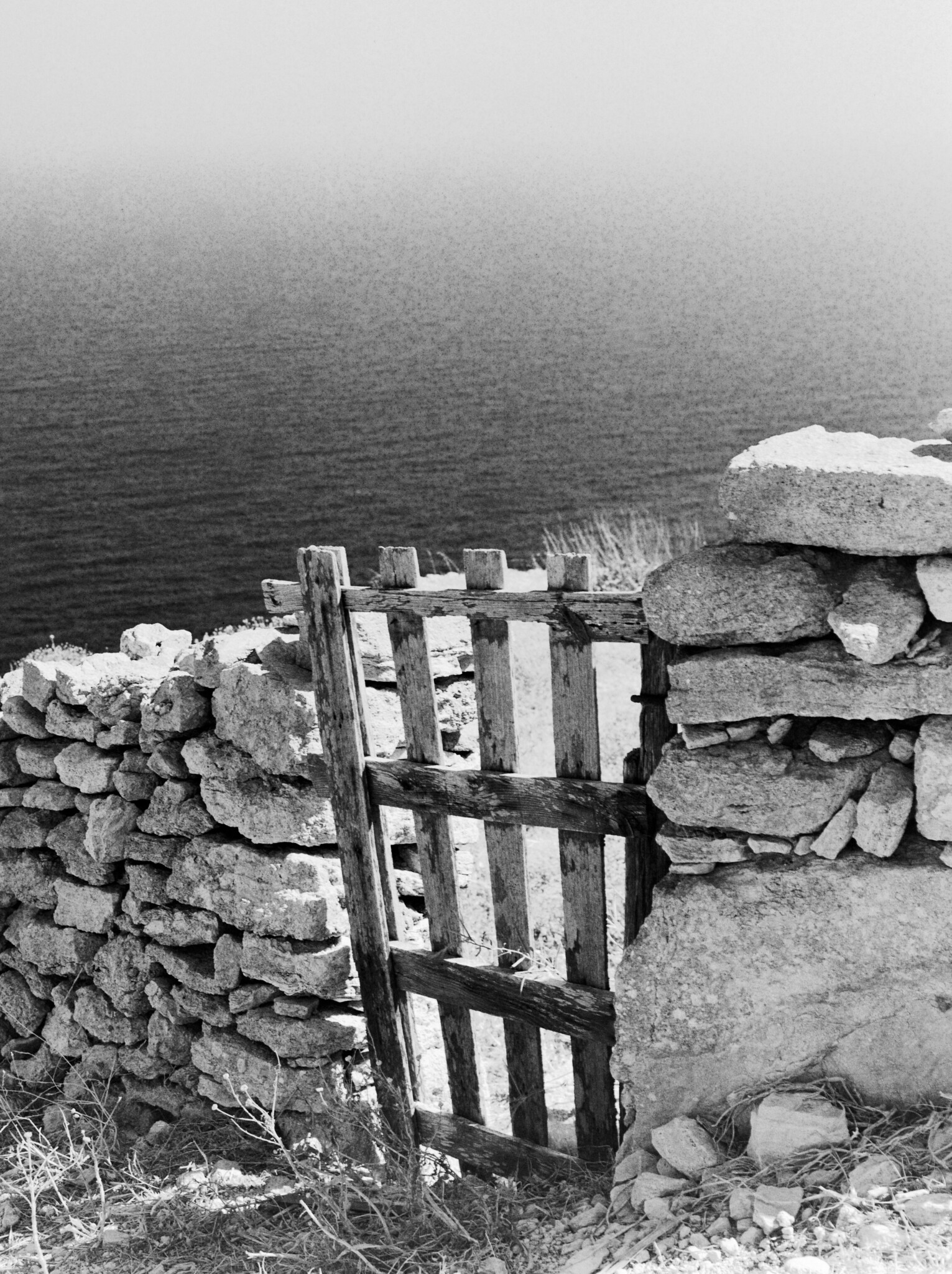

Try shooting it at 50 or 100, and developing for 100. The recipe I used was Rodinal 1+50 15 minutes 21.5C. I actually had to make the shadows darker in post, but the highlights didn't burn out.
This is at 50 with an R25 red filter. R25 is more of a 2-stop than a 3-stop filter with this film, which I did not realize, causing the extra exposure.
