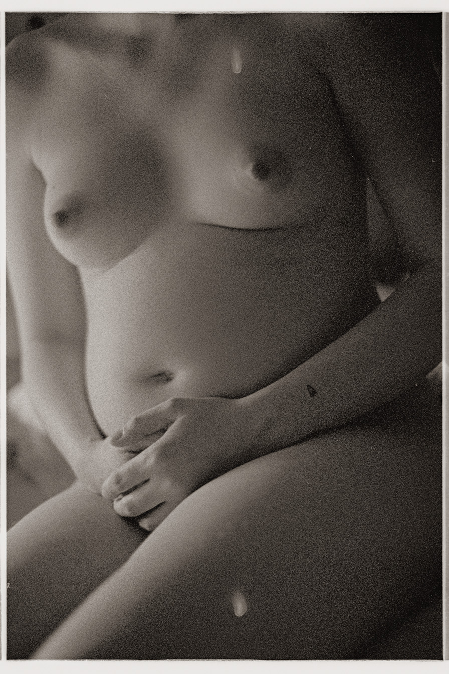

i've noticed that my lasts rolls of kodak tmz 3200 have some "stains" on emulsion side, after years fighting to get clean negs it's bothering me these marks, stains, that seem to be inside emulsion.
They are in the same place always, just in the middle of the film, at the same high, and i have them almost in every frame, sometimes more than one per frame, sometimes none for few frames.
So can it be a tiny lightleak? i've been using the same camera with other films with no problems so far.
Or maybe it's some developing process problem, i just can't figure it out, if they were irregular marks maybe (fixer problem?) but at the same place always, like a pattern?
Anyway here a shot with these two marks.
i need some help, please!

Those look like "drips" - I'd look at whether you're getting all the Photo-Flo off again before drying, or if you have hard water, or something... Do they always sag down towards the end of the film that was lower when hung to dry?

Less photoflo rather than more photoflo. Don't screw around with the film, just wash it and let it hang without touching it.

I've been fighting with hard water problems and these marks doesn't look as water related problems, all of my problems in the past water/dry hanging related were not in the emulsion side, and these marks are not ON the film they look iN the film.

But if you know how water marks are, they don't look the same as these tiny marks.

Peri, you probably use Ilford's Ilfotol, which "should" be diluted 1+200 (see here, page 4). Of course, proper dilution is something relative and depends on the kind of water used. Anyway, try 1+200 and see what happens. I also don't think that these marks are light leaks. They'd have to be more diffuse and the ones you have look like droplet stains. Have a look at the lower part, it's well defined and sharp, as opposed to the upper part. The upper part had less water and made a "smudge" as it evaporated. The lower was the last to evaporate and has a well defined outline.

Those marks are dark on the original film, and too dark IMHO to be made by drying marks. They look more like kink marks in the original film or drip marks of developer onto the film before processing. If this is 120 film, it is easy to kink it when loading onto reels for processing.

About kink marks, after looking again my negs once developed and dried they look completly flat without kink marks on it. I had kink marks on the past with 120 film when i was starting developing at home, but these stains have no marks on the film they look inside the emulsion like they were part of the picture. About drips of developer before processing, i doubt it. My reels and tanks are clean and dry before starting and i never use water bath before developer. Btw it is 35mm film, (do they have kodak tmz 3200 in 120?).

There is a coating defect that resembles this in extrusion hopper coating that is called a comet. It looks like one of them. However, this film is slide coated and comets do not usually form. In fact, they have a very strict QC program that looks for these and removes them by trimming properly.

But i also discover one thing, just for curiosity i went to my old developed tmz films to compare them against the new problematic one. And i realized that the old ones doesn't have the film base or better said all film has not a a purple tint on it. The new problematic one has it, a purple tint on it, but and that´s the freaky thing it looks that this tint is not uniform all over the film, it's hard to see but the tint is stronger or lighter depending the place.
There's always an associated tint on all black and white film bases as far as i know, depending the films the color changes but this purple tint is not uniform. Can it be possible that it didn't remove well during developing process somehow and it produced these marks?...

I don't expect any answer after 7 days of my enquiring so, if anyone has any clue about my problem say something please!. I have to say that i tried shooting the film with another camera and the problem is still there, after few developed films with the same technique and same chemicals 5 were f***** up and 2 were good. The crappy ones apart having those marks also have the irregular tint issue were the good ones just look like normal and good tmz.

I think you might need to sacrifice a roll to open light to see if it's already on the film pre-development. It's starting to sound as if some form of liquid and/or excessive moisture has hit the film before you even use it.
