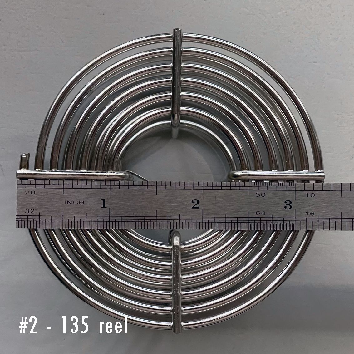

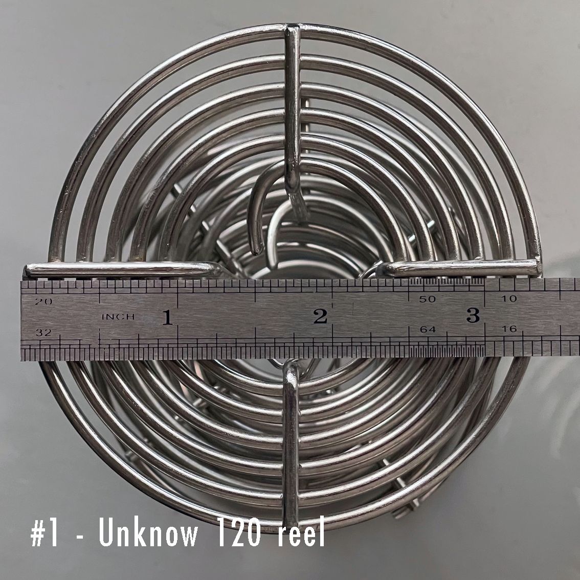

Hello,
I get a bunch of stainless steel reels, seems to be 135 and 120 formats.
Some fit in Nikor SS tanks, but some not?
For the ones that doesn't fit, where did they come from, is there some specific sizes between different manufacturers?
The difference is small, but blocks to enter the tank.
See attached photos, the #1 is the unfitting one.
Thank you very much.

Is #1 distorted/bent?

I think #1 is sitting on top of a second reel, so looks a little peculiar.

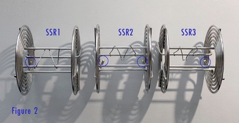

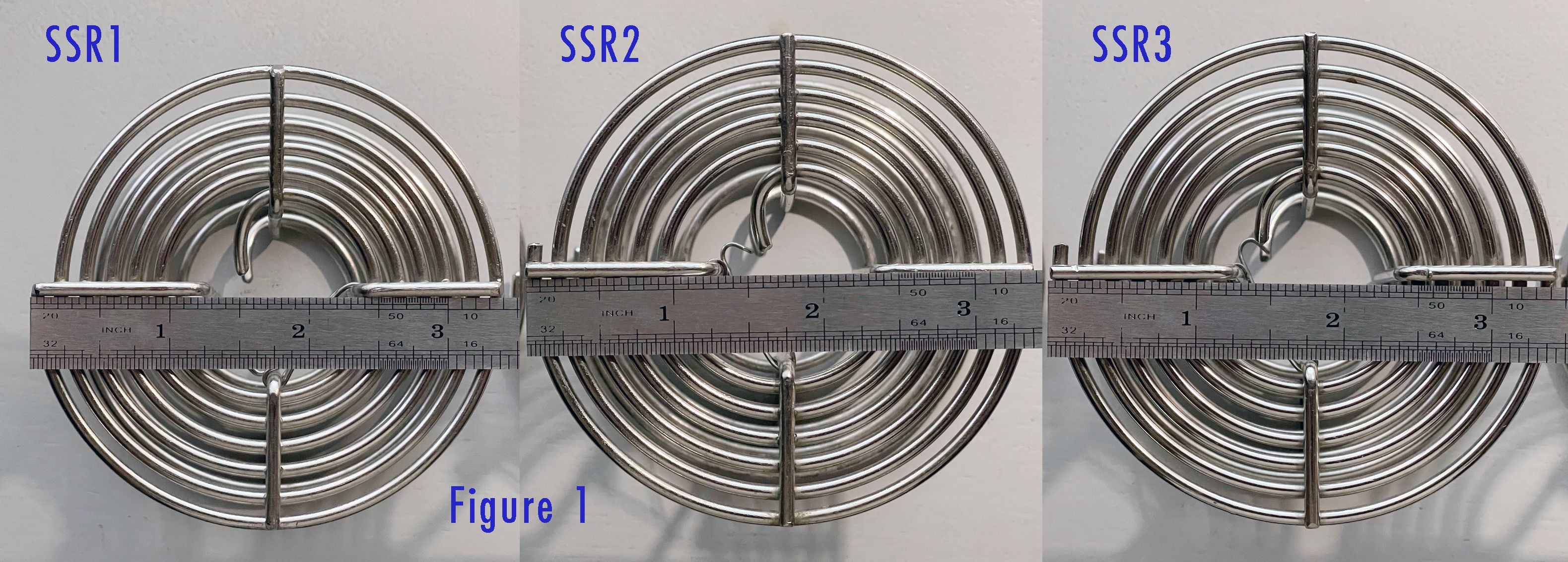

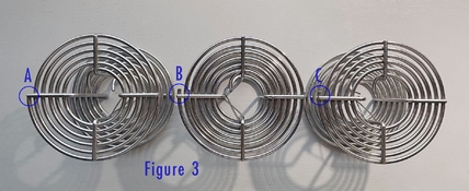

But they seems not bent, I have 3 of them like this, see figure 1.

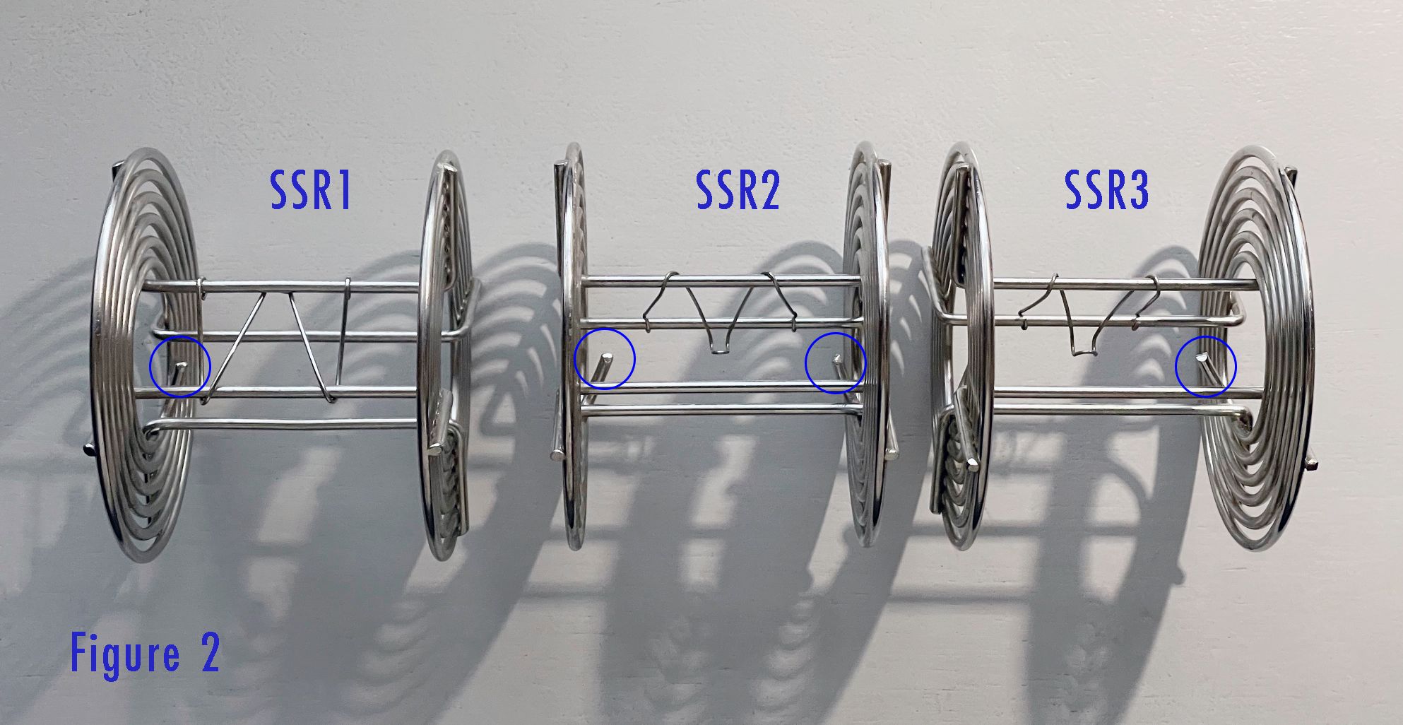

Figure 2 : they have "outer" spiral starts, just like some 135 ones where you insert film perforations.

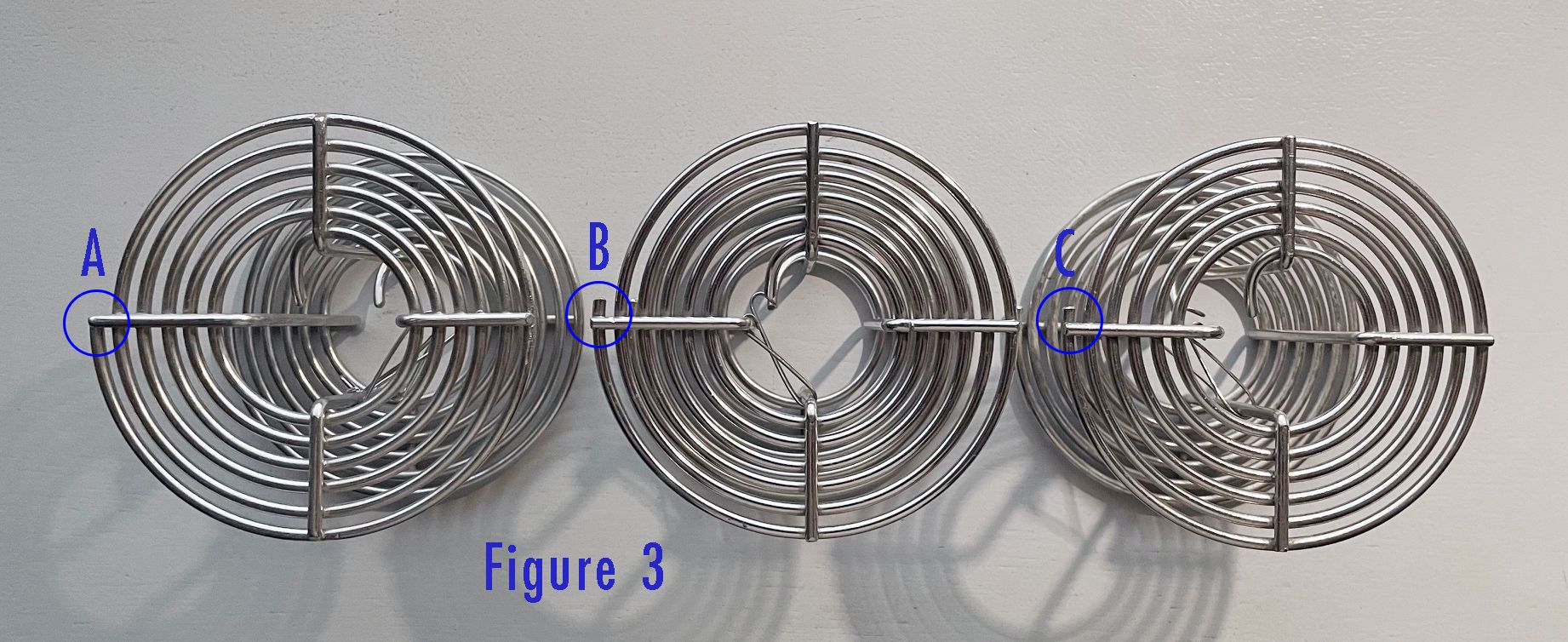

Figure 3 : 2 have the ends (B and C) not aligned with the axis just like A.

Another remark, in post #1, the second picture reel-2.jpg that is labeled "135" is also unusual. A 35mm reel will usually have thinner wire and many more turns. Typically a 120 reel has about 5 usable full turns and a 35mm-36 exp reel has about 9. The reel-2.jpg reel has about 6 full turns, meaning that either it's only for 20-24 exposure rolls, or the height is different and is actually for 127 film. I have not seen a 127 steel reel, but supposedly they exist.
Yes you are right, well seen.
They have the same height, so I don't think it's 127 which is much larger.
But I have both thinner (more turns) and larger (less turns) wire types of "135" :smile:

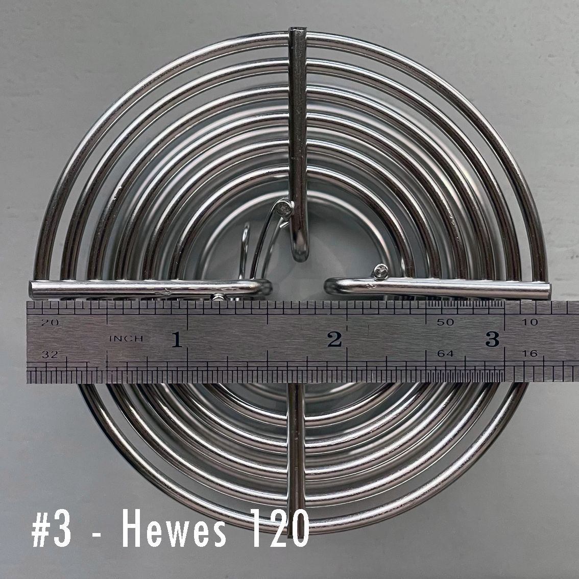

I recognise #3 and that one will fit in the Kindermann SS tank (and others having the same diameter), but this is not a Kinderdmann reel.
The #3 (of which I have 4) has the same size as a LPL 120 reel (of which I have 4 too).
