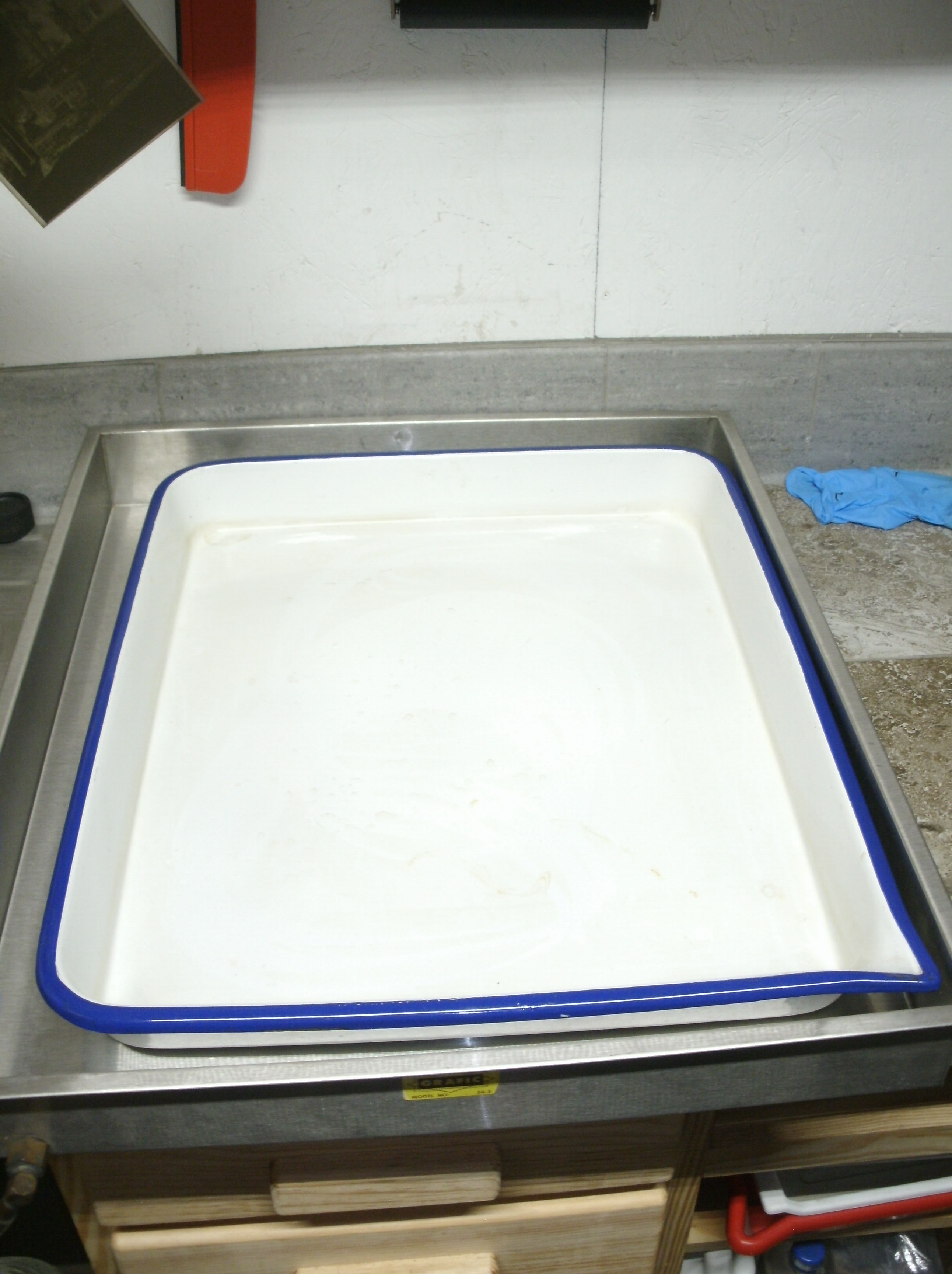

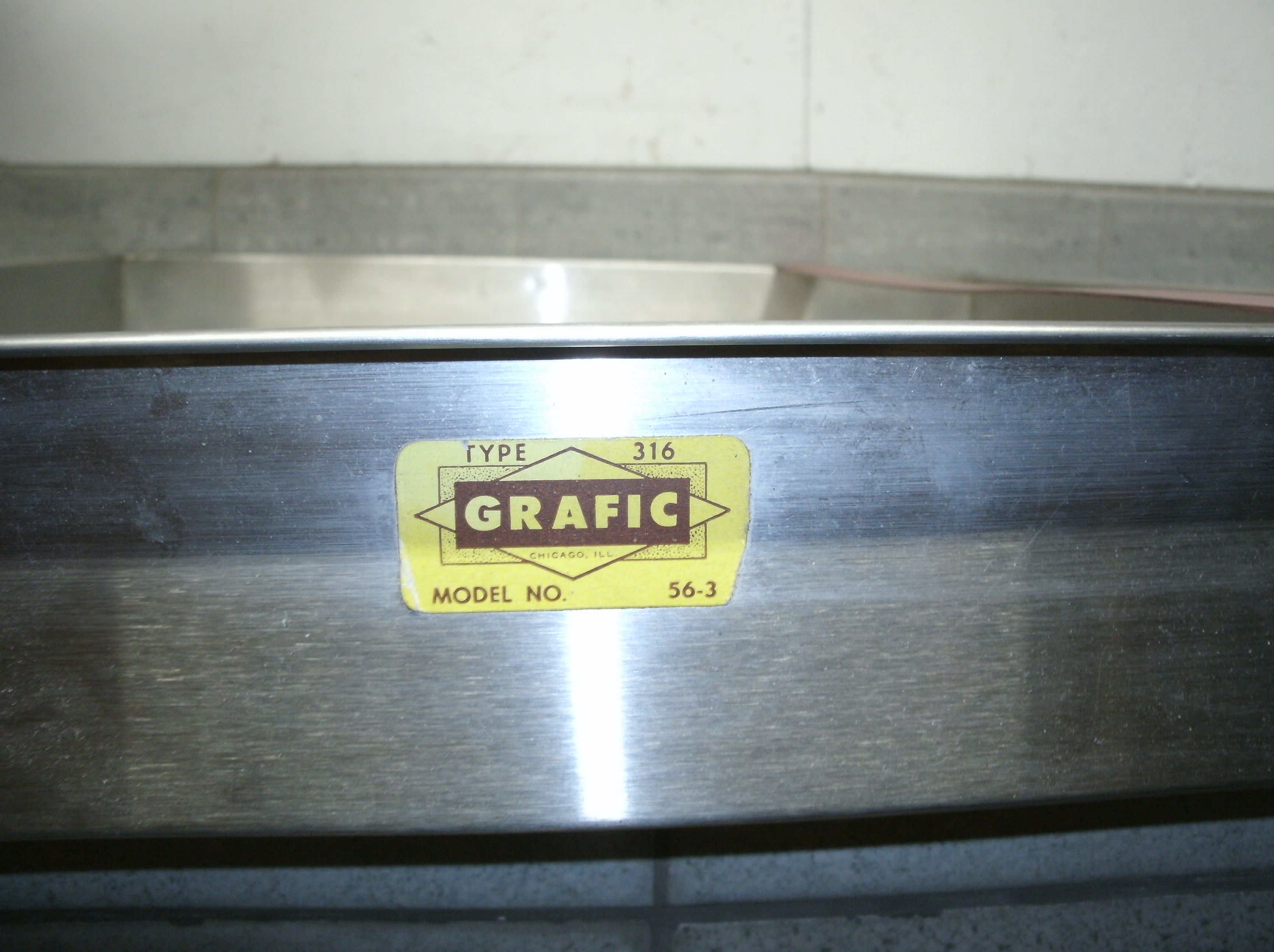

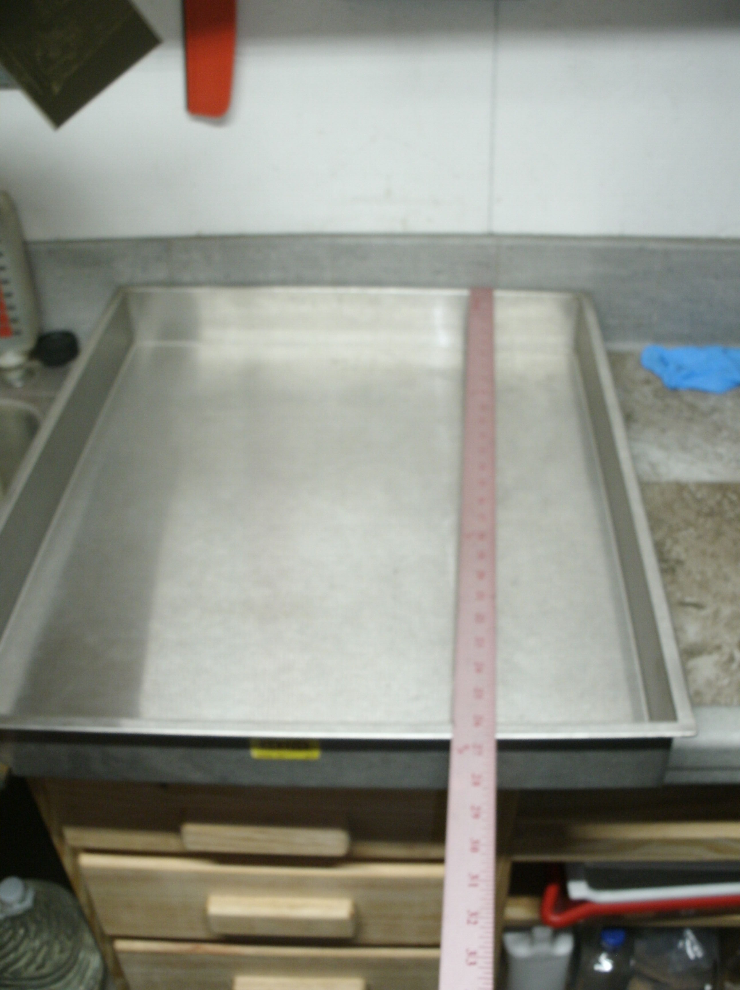

Here's my 20x24 tray, actual interior dimensions are 22x26x3 inches. Also my 16x20 Cesco enameled tray, actual interior dimensions are 18.5x22.5x2.5 inches. I don't have room for multiples of either, nor do I see the need.
