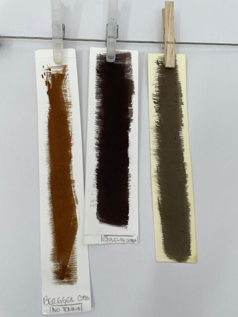

Toning with gold-thiourea (L.P. Clerc formula) worked very well, but the VDB print toned with palladium got severely stained : the paper base became all yellowish... as you can see on the right in this picture (left sample is untoned, middle sample is toned with gold/thiourea) :
Note that I tone the print after clarification and before fixing them, as recommended in several books (Donald Nelson, Dick Stevens, ...)
I have observed that the staining appears just when the Pd toned print is immersed in the fixing tray ... The fixer is a plain 4% sodium hyposulfite solution

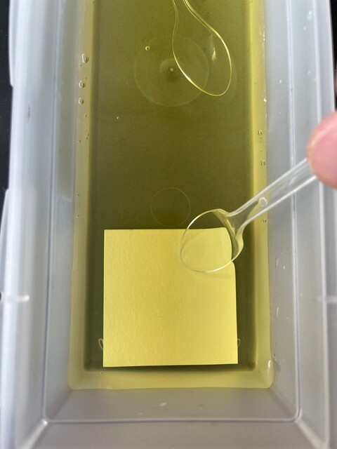

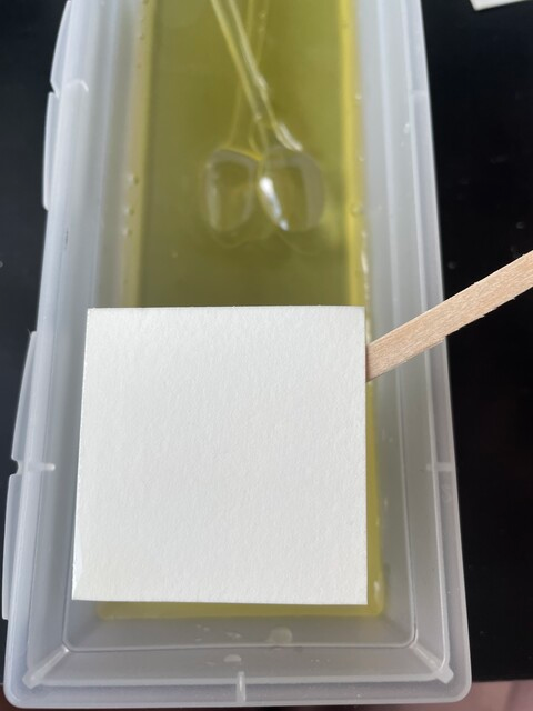

This Pd toning solution is yellowish, but I can observe that the paper base remains white in this toning solution (here tested with a simple piece of Bergger COT320), even if left during 10 minutes in the toning solution :

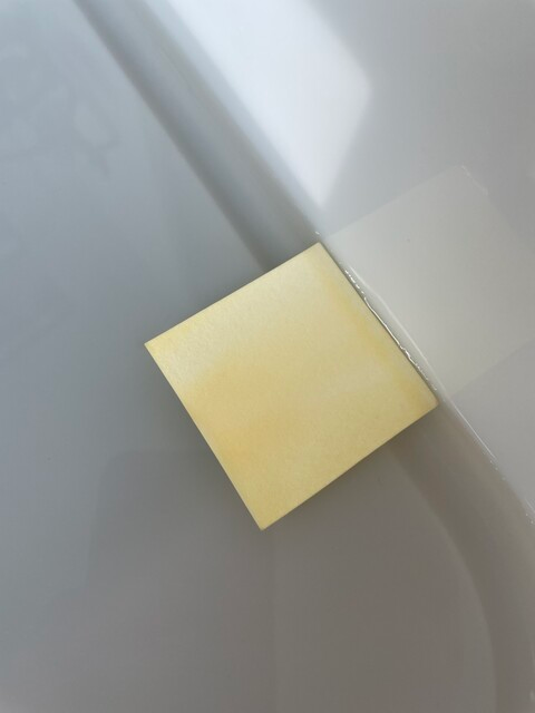

It is only when I immerse it in the fixer tray that the staining occurs all of a sudden :
Do you have an idea of what could go wrong ?

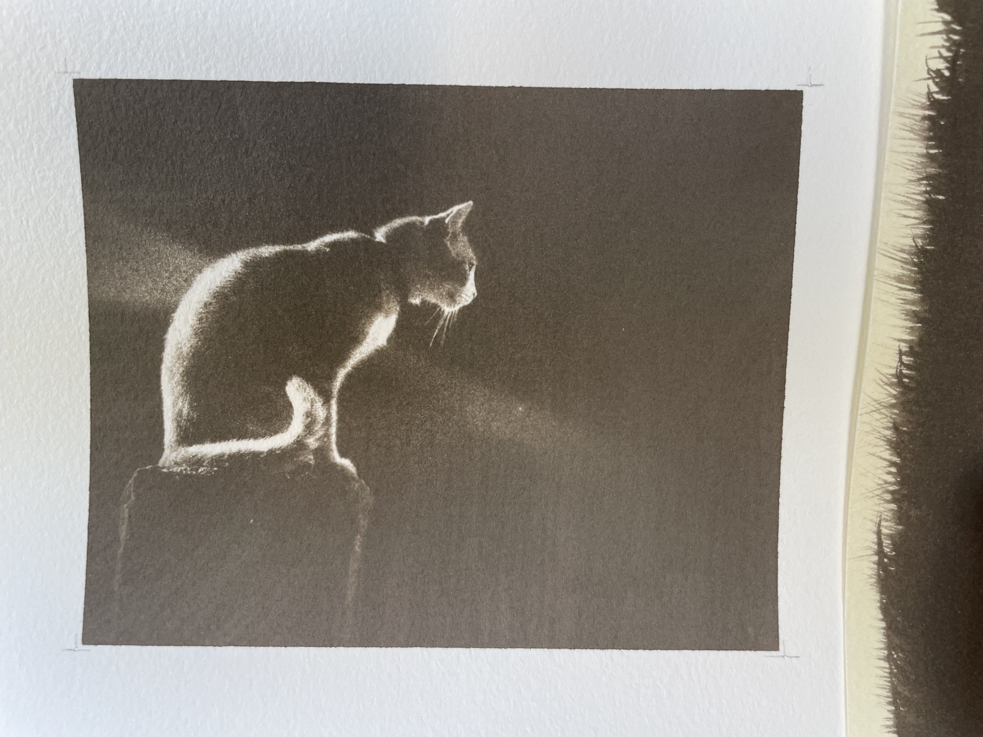

And here is my latest VDB print toned in Palladium, with the previous strip stained on the right for comparison :

That print looks a lot better!
Are you adding any alkali to your fixer? If not, maybe that would help keeping any residual Pd-toner inactive during the fixer bath.
If this drop test was with plain hypo, you could repeat it with 0.25% sodium carbonate added to the fixer to see if an alkaline fixer bath makes a difference. (I've used 3% hypo + 0.2% sodium carbonate)
